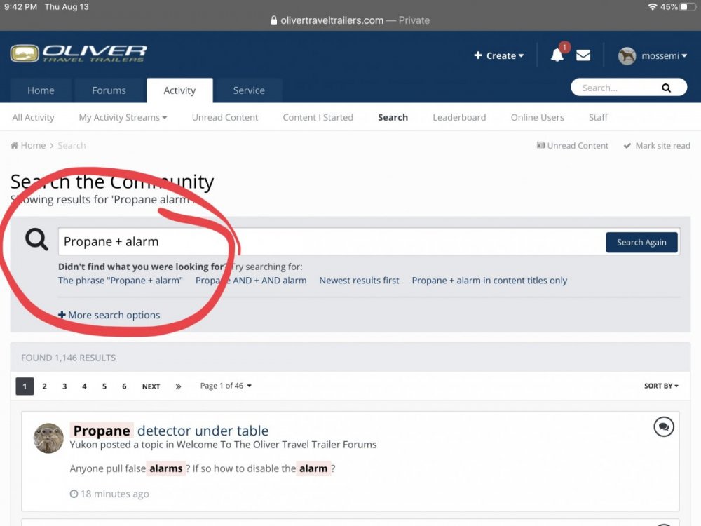

Yukon Posted August 14, 2020 Posted August 14, 2020 Anyone pull false alarms? If so how to disable the alarm?
Moderators mossemi Posted August 14, 2020 Moderators Posted August 14, 2020 This search of the forums turned up this post. https://olivertraveltrailers.com/forums/topic/3543-atwood-propane-alarm/ Mossey 1 Mike and Krunch Lutz, FL 2017 LEII #193 “the dog house”
