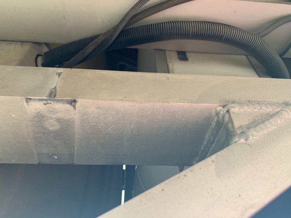

Ralph, the factory mounts the Andersen on the Y.  I’ll take a picture of where the one you have was on my frame.  As I recall, it was difficult to remove while on my back, and a breaker bar helped.  John D mounted his on the center of the frame.  Maybe he can weigh in.  It’s good to know your trailer was well behaved  even if the brackets slipped some.

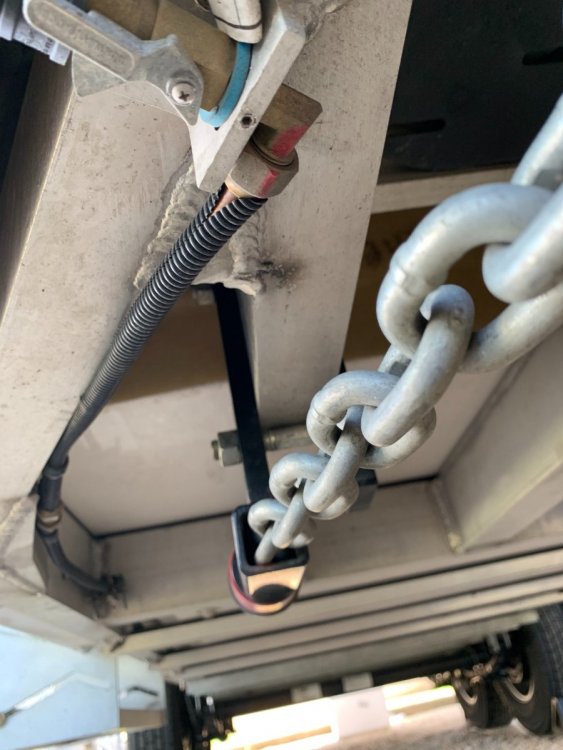

Wonder why they didn’t use the middle beams like I did. Seems like best of worlds, easier install access, no conflict with wiring and straighter pull.
unless that beam is considered weaker than other two.
Mike, if you are feeling energetic, would you try for a wider shot.  They may have change some things underneath since 2017.
I don’t think you can mount to the outside rail on the right side due to propane line and short distance between welds.

I’ll try in the morning.  Our site here isn’t very level and the front of the trailer is about as low as it can get!  I can raise it to get a picture.

The center beam installation has a lot to recommend it.  I think I was the first and did a post on how to do it.  John Davies did a follow up with much better pictures.  The advantages: 1.  Center beam is strongest structural member with better lead angle; 2.  Center beam installation allows brackets to be doubled-up, ensuring that there is no slippage; and 3.  easy to reach for adjusting the bolts.  If I were handier with the forum would give you a link, but I’m not.  You should be able to find our posts with a bit of research.

Service confirmed they install on the rails next to and parallel to the center beam.
they also confirmed 75-90lbs of torque, leaning toward 75.  I’m probably over that now, but had slippage at 75.
Given how good I’m getting at adjusting the brackets, I may give center rail a try, if I don’t have to mess with new chains. I’ll re-read the thread. Found via Google search.
