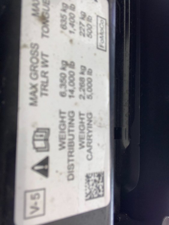

TexasGuy Posted August 4, 2021 Posted August 4, 2021 Not sure where they put in 2017 on Expedition but in addition to payload in drivers door see if you have this one on the hitch. Tell you max weight with and without WDH. 1 2021 Legacy Elite II Hull #807 - 2021 F150 w/ 3.5L EB and max tow package
