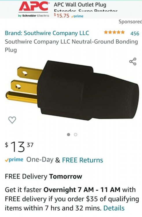

Moderators SeaDawg Posted September 14, 2021 Moderators Share Posted September 14, 2021 @John M Do you have a neutral ground plug? Photo is from Amazon, but you should be able to get one at any camping world or rv supply, or make one. 2008 Ram 1500 4 × 4 2008 Oliver Elite, Hull #12 Florida and Western North Carolina, or wherever the truck goes.... 400 watts solar. DC compressor fridge. No inverter. 2 x 105 ah agm batteries . Life is good. Link to comment Share on other sites More sharing options...
John C Marsh Jr Posted September 15, 2021 Author Share Posted September 15, 2021 Thanks, I have the ground plug now and all is working fine. Only problem, my 2,000 watt Preditor (1,60p watt running) generator overload light is on when charging the lithium battery. Everything is unplugged. Link to comment Share on other sites More sharing options...
