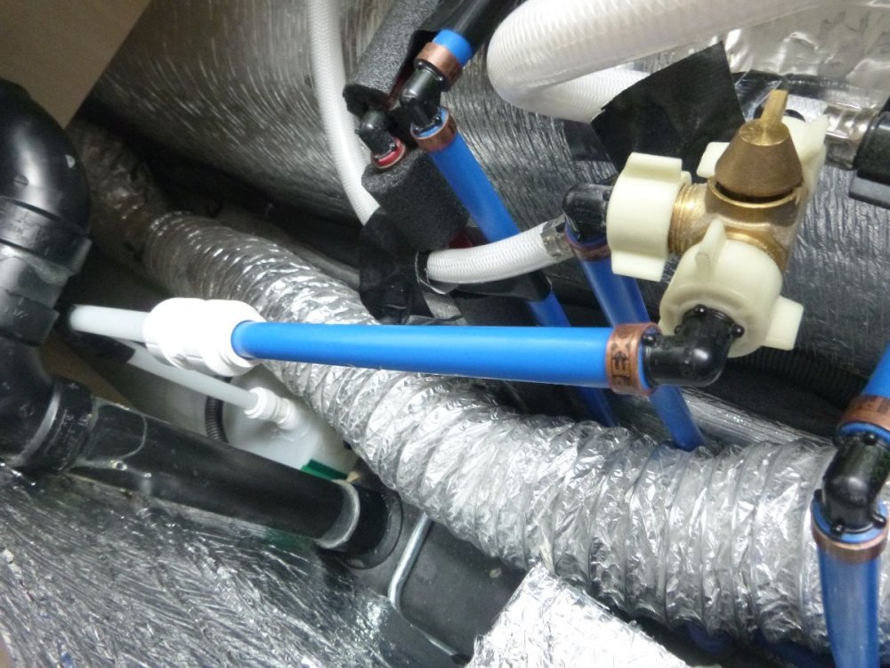

Need help, started to winterize trailer, went to bypass water heater, lever is missing, look to see if it pop off due to vibration but it is no where to be found, Oliver might have remove it for some reason when doing yearly maintenance a few months ago, cannot find that type of fitting with that lever anywhere, any suggestions where to find one

Do the rest of your water valve "levers" look like the one pictured in the upper right hand corner?
Here is one with a similar lever.
At this point (Sunday evening), I'd call Oliver Service first thing in the morning (Monday) and see if they could tell you:
1.  how that lever attaches to the valve stem
2.  how soon they can get a replacement lever and/or valve to you.
Good luck!
If it has fallen off, you still might be able to turn the shaft, what does it look like? Could you use an adjustable wrench? Whichever way it will move, turn it all the way until it stops.
