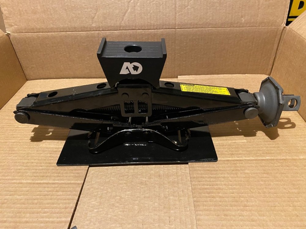

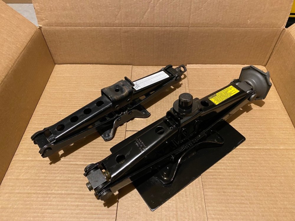

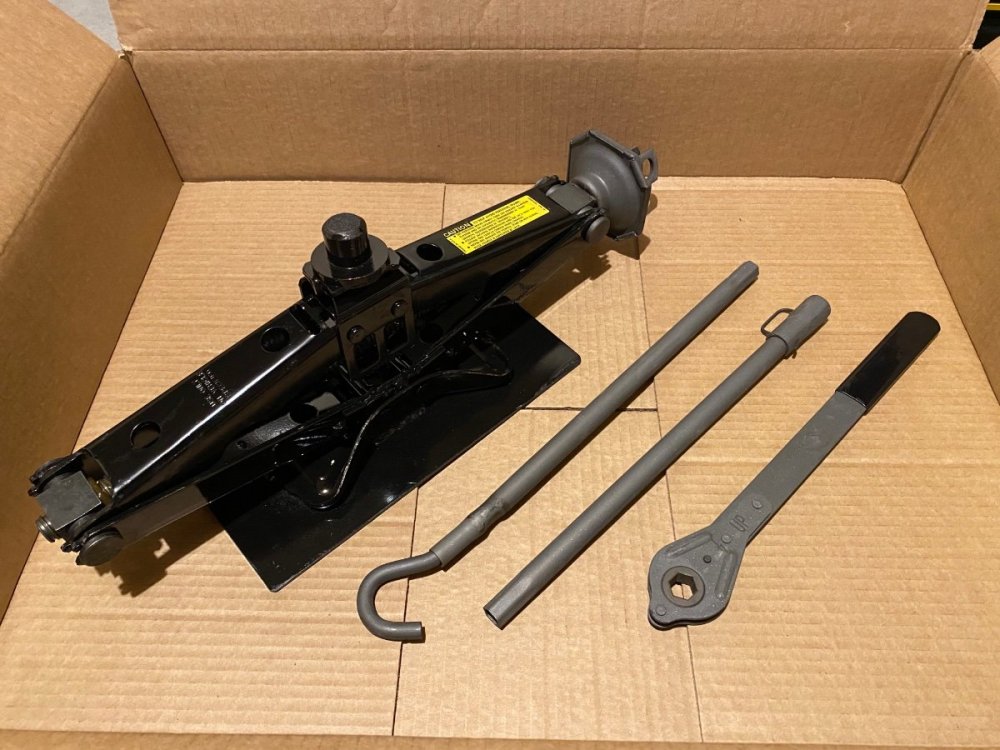

Frank C Posted February 18, 2022 Posted February 18, 2022 The Oliver has taken over my life and my budget 😂. I have no other habits like smoking, drinking, or gambling to spend money on, just the Oliver and travel. So I purchased one of the military surplus HUMVEE scissor jacks and the Agile Offroad adapter block. I know there are some Ollie owners that use their stabilizer jacks to lift the Ollie for tire changes, but I prefer not to. The HUMVEE jack is brand new in box military surplus from an EBAY source here in the US. A very heavy duty jack. Beefier than the scissor jack I was using from my old (long gone) Dodge pickup truck. HUMVEE jack on the right, Dodge jack on the left in the first photo. Nice features on the HUMVEE jack like a ratcheting handle, a very large baseplate for a big footprint on softer ground, a gear reduction box (see photo, on the right end of the jack screw) to give a big mechanical advantage while raising the jack, and a nice carry bag included. I’ll be doing my wheel bearing repack in a couple months before hitting the road again with the Ollie, and I think this new scissor jack will be a big improvement for lifting the Ollie. It’s appropriately sized for the Ollie, from the specs I’ve found it’s rated for 3.5 tons. I tried a bottle jack but that requires wooden blocks to get enough lift height, and bottle jacks require additional safety measures like jack stands or the Ollie stabilizers. And the old Dodge truck jack seemed just a little undersized for the Ollie (it was from a Dodge Dakota pickup). And the Agile adapter block fits perfectly under Ollie lift points on the suspension subframe. https://www.ebay.com/itm/AM-GENERAL-5939822-MILITARY-TRUCK-SCISSOR-JACK-NSN-5120-01-375-0070-/284624079355?mkcid=16&mkevt=1&_trksid=p2349624.m2548.l6249&mkrid=711-127632-2357-0 https://agileoffroad.com/product/agile-h1-scissor-jack-axle-frame-jack-adaptor/ 1 2
John E Davies Posted February 18, 2022 Author Posted February 18, 2022 Wow, that is cool, gear reduction, does it take a bunch of cranks to get it extended? Maybe make an adapter for a power driver? Have you considered getting the Agile saddle (curved) adapter so you can lift an axle tube? https://www.homedepot.com/p/Quick-Products-1-2-in-Scissor-Jack-Adapter-QP-SJA/306535553 I got my Amazon one, but I am waiting before I post pics, I was finally able to locate a spare tire kit for my Acura which includes an OEM jack, and I want to do a side by side pic like yours. It is nowhere as stout or classy as the Hummer version. I might end up returning it. John Davies Spokane WA SOLD 07/23 "Mouse": 2017 Legacy Elite II Two Beds, Hull Number 218, See my HOW TO threads: Tow Vehicle: 2013 Land Cruiser 200, 32” LT tires, airbags, Safari snorkel, Maggiolina Grand Tour 360 Carbon RTT.
Frank C Posted February 18, 2022 Posted February 18, 2022 1 minute ago, John E Davies said: Wow, that is cool, gear reduction, does it take a bunch of cranks to get it extended? Maybe make an adapter for a power driver? Have you considered getting the Agile saddle (curved) adapter so you can lift an axle tube? I got my Amazon one, but I am waiting before I post pics, I was finally able to locate a spare tire kit for my Acura which includes an OEM jack, and I want to do a side by side pic like yours. It is nowhere as stout or classy as the Hummer version. I might end up returning it. John Davies Spokane WA The Agile adapter is reversible. Flat on one face and curved on the other so it can also be used for lifting on an axle tube. The gear reduction seems to be about 3 or 4 to 1, so it definitely increases the amount of cranking, but the jack is pretty tall to start with, especially with the Agile block on top, and the ratchet handle makes for pretty quick work when raising. 3

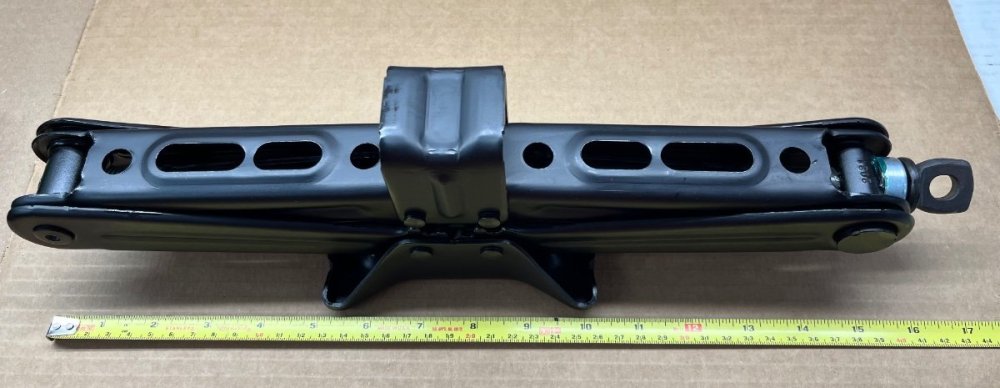

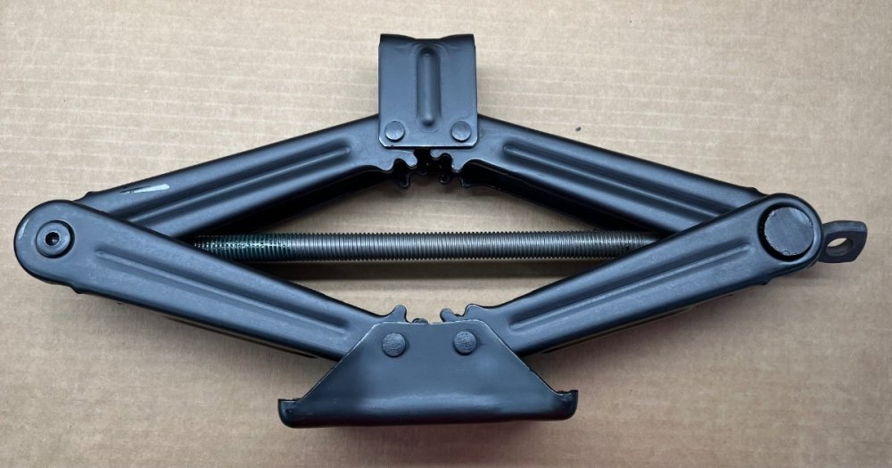

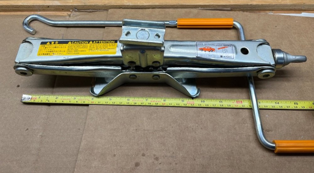

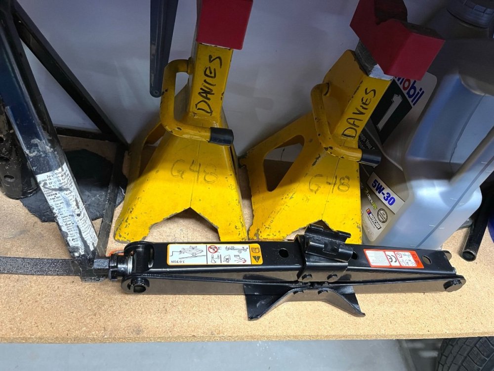

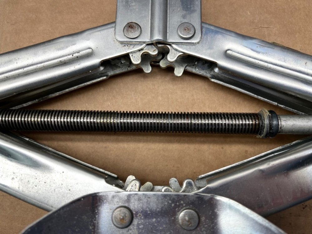

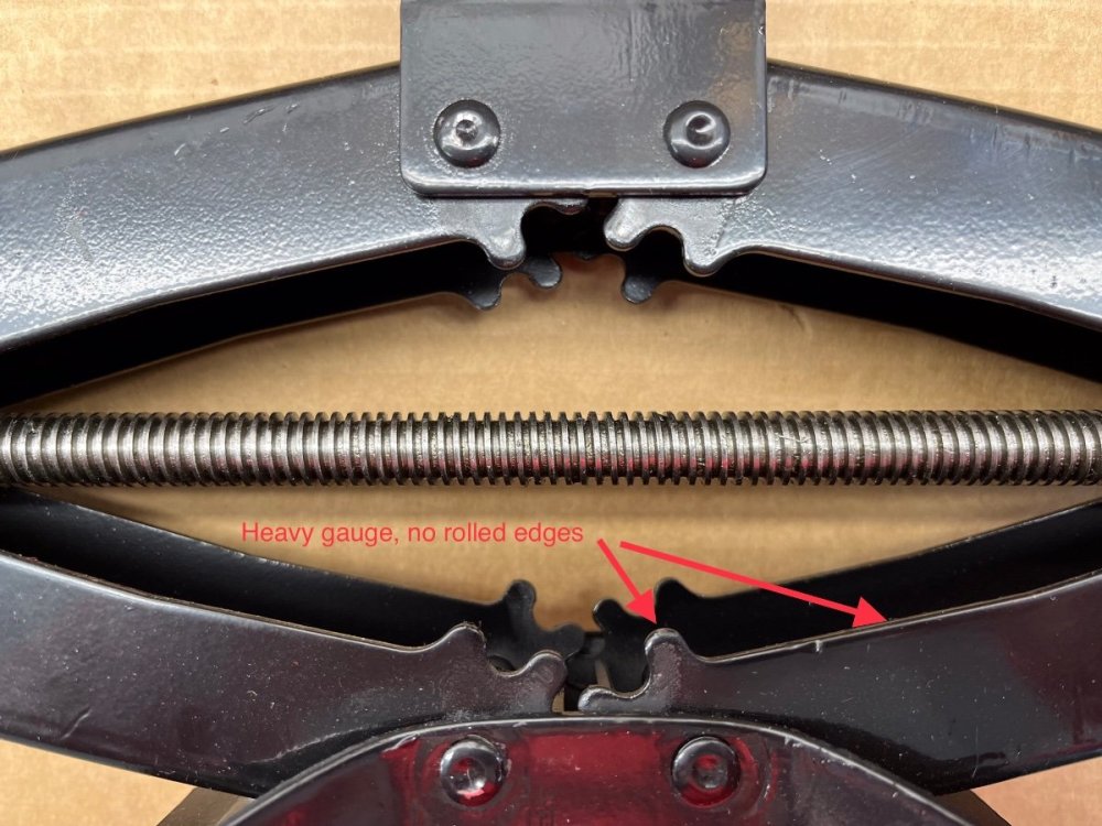

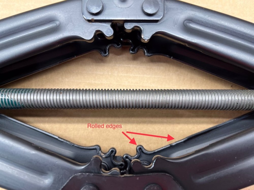

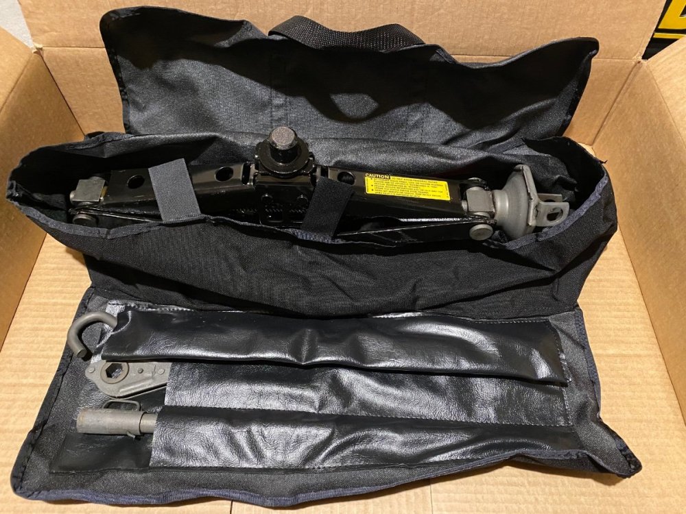

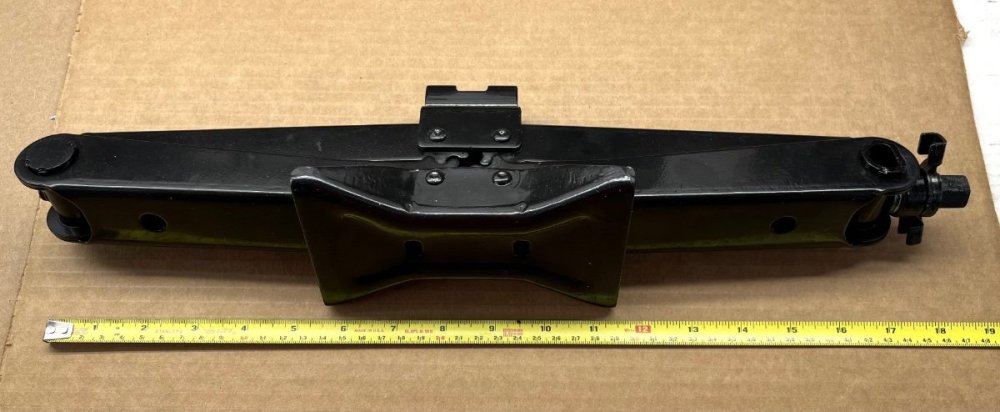

John E Davies Posted February 22, 2022 Author Posted February 22, 2022 Some pics. first is my new Acura OEM jack, it is fairly thin steel but has rolled edges and rolled “gear” teeth and grooves in the sides. All help to increase durability and strength. It has a black paint finish. Here is the one from my 1998 Lexus, it actually has separate teeth/ gears, the parts are cad plated and the drive rod is stainless: Both are about the same size and weight, and both operate very smoothly and feel pretty well put together. Here is the IMAYCC one from Amazon: It is definitely stouter, with a larger foot, but they are relying on thicker steel for strength, there are no reinforcing rolls or ridges. It works OK, but it is stiff, a little bit kludgey, and definitely feels like a cheap tool. I decided to keep it as a extra or quick access jack, it fits very neatly on the shelf beside my jack stands, it will be much easier than dragging out my monster floor jack, which works great, but it is overkill sometimes. John Davies Spokane WA 2 SOLD 07/23 "Mouse": 2017 Legacy Elite II Two Beds, Hull Number 218, See my HOW TO threads: Tow Vehicle: 2013 Land Cruiser 200, 32” LT tires, airbags, Safari snorkel, Maggiolina Grand Tour 360 Carbon RTT.

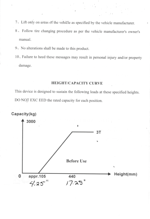

John E Davies Posted February 24, 2022 Author Posted February 24, 2022 Here is an interesting warning chart that I have never seen for a jack, this is part of the IMAYCC owners manual. I changed the metric height to inches. I don't quite know how to interpret it, there is no Capacity figure for the lower part of the Y axis, other than the "0" that is in the corner for both axes.... Does this mean that the jack can support zero weight when fully collapsed? What is the capacity at say 10"? Maybe this is why some of these scissors jacks collapse, you exceeded the zero weight capacity. 😉 I think I will contact the manufacturer on Amazon to see if they reply. BTW, a hydraulic jack rated at 3 tons would support 3 tons anywhere in its range of travel.... John Davies Spokane WA 1 SOLD 07/23 "Mouse": 2017 Legacy Elite II Two Beds, Hull Number 218, See my HOW TO threads: Tow Vehicle: 2013 Land Cruiser 200, 32” LT tires, airbags, Safari snorkel, Maggiolina Grand Tour 360 Carbon RTT.
Frank C Posted February 24, 2022 Posted February 24, 2022 That chart is really bizarre and confusing. Don’t rest your hand on the jack when it’s fully lowered or the jack will fail. 🙂 1
