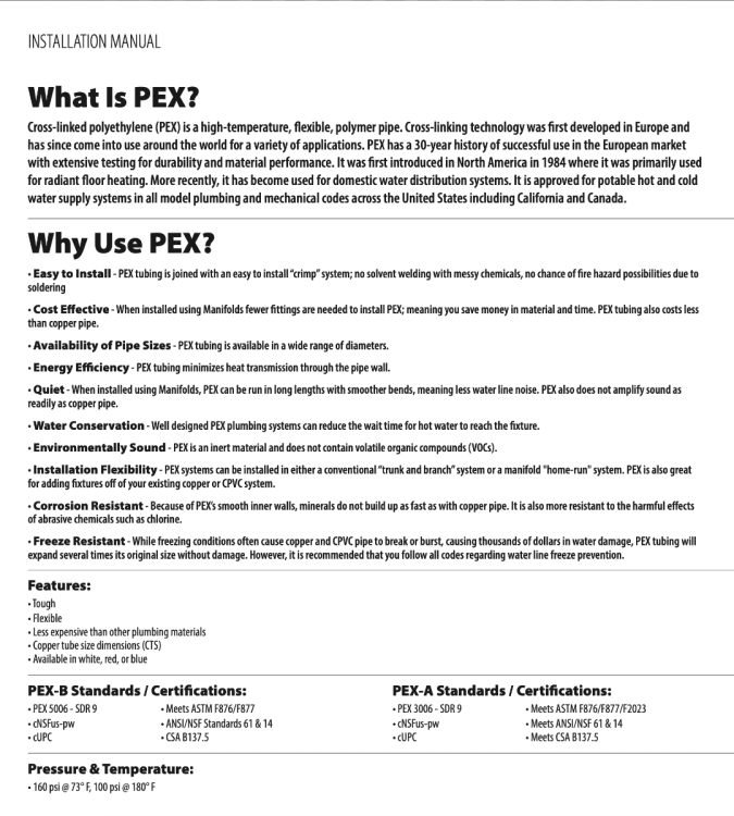

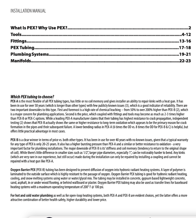

I can't recall where I found this, or I would post a link, Here are some screen captures.
