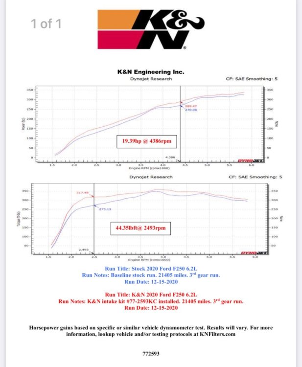

K&N does publish actual dyno run data for their products that shows a performance increase.  I was actually surprised to see the significant increase in torque for the test on an F-250 6.2 liter gas engine, especially in the lower part of the RPM range.  But the dyno runs always seem to be in a single gear (3rd gear run in this case).   So I’m sure K&N is cherry picking their data a bit to show the best results, and this test is for a complete K&N cold air intake, not just the filter.
