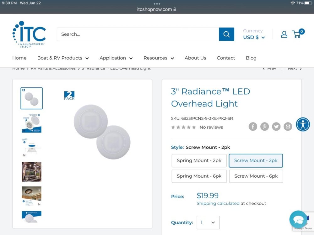

These lights should be very close to a direct replacement but would require cutting the old wires and splicing these in.  There are two version's, screw mount and spring mount.  If you have the correct size hole, the spring mounted lights are very easy to install, but my lights are screw mounted.  I am not sure if ITC is the brand of interior lights Oliver is using or not, but my porch lights were/are ITC brand.
https://itcshopnow.com/collections/rv-products
