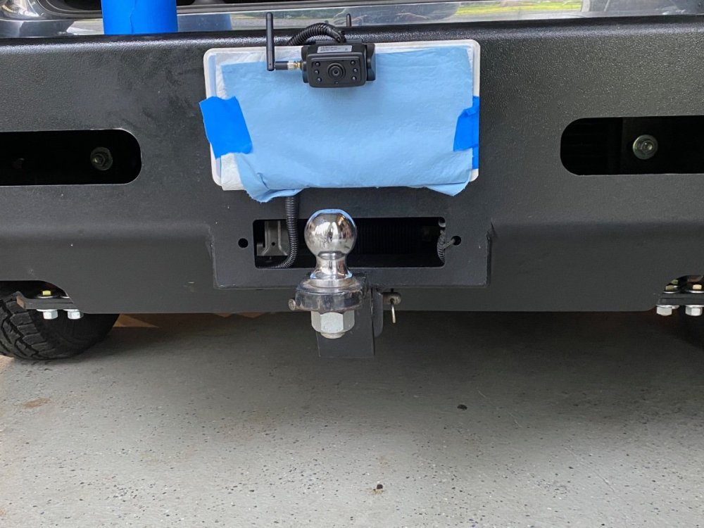

License plate Camera.   CA109
This was for the front license plate.  It was not intended replacement for a Dash cam,  but to aid in hooking up the trailer to the front end so that I could park the Oli reliably in the 3 sided RV port.

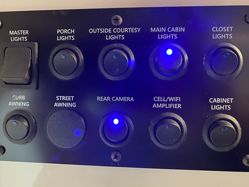

The wiring came into the upper rear cabinet inside the Oli. When pulled the street side panel off from the inside of the cabinet, I was lucky enough to find a 2 wire bundle with one wire marked “cam”, and the other wire was a ground.  The DC power cable that came with the Haloview had 22 gauge wires, and the Oli has 14 gauge wires.  So the soldered a small length of 18 gauge DC wire to the 22 gauge and reinforce the smaller wires and connections with a couple layers of heat shrink to reinforce the 22 gauge wires from breaking as easily.  I then made a mechanical connection with the 18 gauge wires to the Oli’s 14 gauge.
I purchased a LED switch from Oliver and added it to the Master switch panel.  I love it that Oliver already had a slot for the camera.  It made it easy to add power and ground to the switch and connect the “cam” wire on the panel side.

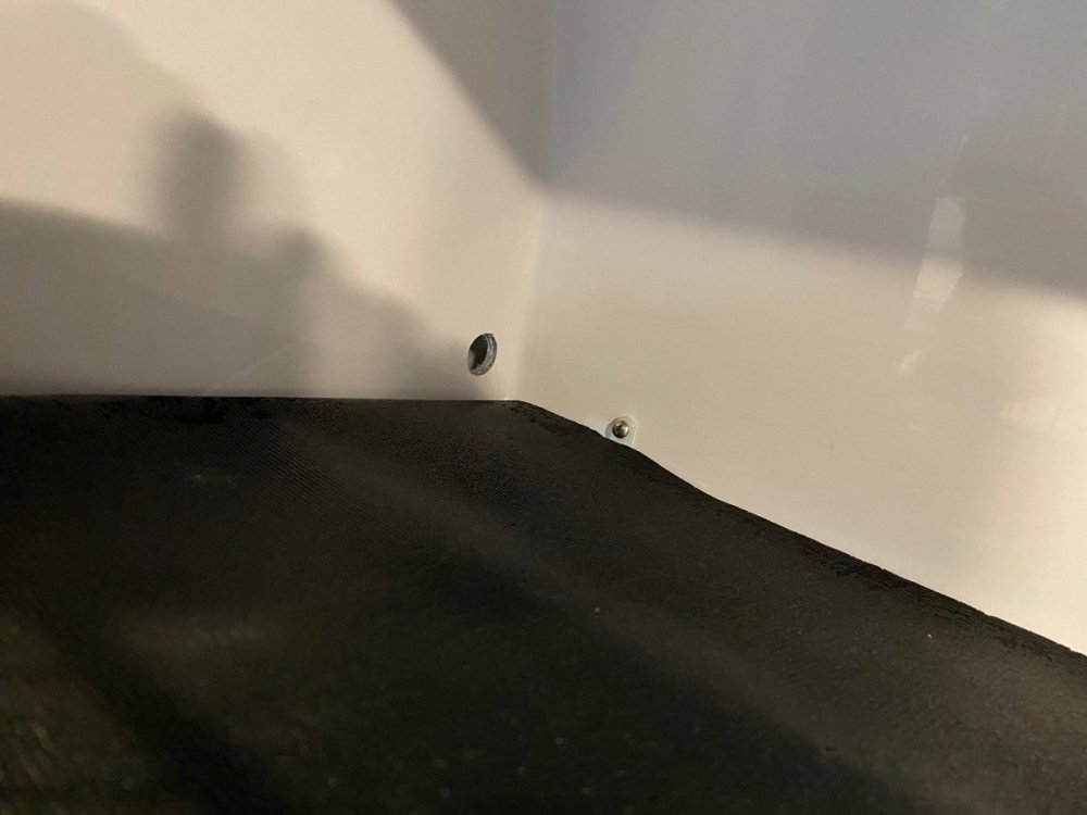

The 33 ft cable was ran through the street side cabinets.  I ran into one snag, I was unable to get a fishtape through the pantry cabinet area. I tried for about 45 minutes and then gave up.  OK, time to start plan “B”.  I know that getting a wire through the bottom street side waste plumbing areas was doable. So I made sure I could get a fishtape from the bottom storage area to the top rear cabinet, this was no problem at all.  The only part of plan “B” that I really didn’t like was getting the bathroom sink cover off, and drilling a hole through the front hull into the doghouse area, and plugging it; yet another point of possible leaks, plus it wouldn’t get finished this week.   Then the thought came to mind, if I am willing to cut another hole through the hull, why not just cut 2 holes in the pantry and go back to plan “A”.  Time to get the executive committee  (Dawn and I ) and make a decision.  The committee weighed the facts and unanimously decided on plan “A”.  FYI: if you run the wire as I did, Plan “A” Haloview has a 26ft length of wire at will work better, If you do plan “B” and run it below to the Propane doghouse the 33ft length of wire will probably be needed. The Connectors on the rear camera cables are large. They are running power,ground, audio, and video through it.  Kind of clunky, but I really do not know any better way.
I cut two 3/4” holes in each side of the pantry cabinet.  I went a little oversize since 5/8” hole is a very snug fit with the cable connectors and boot.

upper pantry shelf
It worked great, running the wire and mounting the transmitter only took another hour. I first tested the setup before attaching the transmitter to the bulk head; every worked great. The transmitter was then attached to the front bulkhead with 3mm double faced tape. I had to use 2 pieces thick to get it to stick because of the slight curve in the hull.

Front License Plate Camera.
The front license plate Camera is only to aid in attaching the trailer tongue to the front ball.  Due to the Angle of the camera to ball, the camera only works for this purpose.  This use is also limited.  I can only see the tongue when I am within about 8 feet away. This after practicing one time,  I was able to properly get the ball properly positioned under the tongue 3 more times in a row on the first shot.  The camera is only turned on when it is needed for hooking up to the trailer. If I pointed the camera up, I would not be able to use it as an aid in hooking up the trailer.  Also this technology is not quite suited as a fully functioning Dash Cam.
There is a video delay on front licenses plate camera. The delay was variable from imperceptible to 1.2 seconds.  I test it by driving forward in the driveway and then slamming on the brakes and measure the time delay.  Fortunately as I got close to the ball the delay seemed to be imperceptible most likely because I was creeping forward, slower than a idle. The camera is mounted on the front of a custom 1/4in thick bumper. The metal may have caused the problems with the reception.
