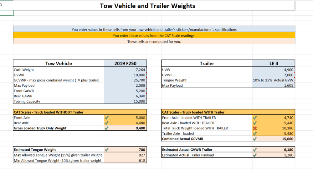

We just did our first CAT scale weigh in this past weekend.  I've attached a pic of a spreadsheet I use to see what was going on.  Where does all this weight come from LOL!
We do not use a WD hitch, given that our vehicle does not need it as defined by the Ford's RV and Towing spec sheets.  Finding this fine print is not the easiest thing to do!
