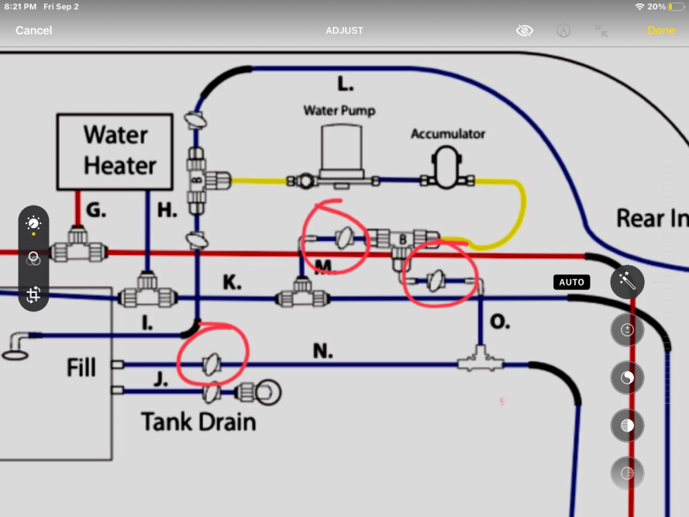

Update:  I just looked at the 2022 Owners Manual, Elite plumbing diagram, and found a surprise.  The diagram shows a ball valve on the Fresh Water fill line.   Why it’s there, I have no idea.  I was not aware there is one on my trailer, but it’s also shown on the 2021 diagram.   If there is a valve (I will be checking to confirm), then it must be in the open position on my trailer.   Check to see if you have a valve like that, and if it’s open or closed.  As I mentioned, this temporary problem will not keep you from camping,   You can fill your tank from the Boondocking port, or you can fill it faster from the City Water fill.  To fill using the City Water inlet port, open the 3 valves circled in red in the photo.  The one on the lower left is the valve I’ve never seen before.   No need to watch the See Level monitor, when the tank is full, it will overflow onto the ground.
Thanks everyone! Yes to Mike D! There was a value that needed to be turned! Once we turned it all worked fine!  I appreciate the diagrams!
