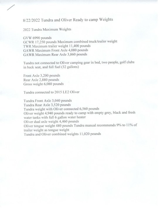

Here's latest CAT scale results for our 2022 SR5 2WD Crew Cab Tundra's new curb weight after installing accessories. I did not document accessory  weights during installation. Installed Toyota side rails, Toyota folding hard bed cover, Toyota bed mat, Toyota Mud guards, and Timbren SES rear suspension kit.
Weighed the Tundra with all contents removed, accessories installed, full 32 gallon fuel tank, and no occupants.
66327563110__C9483B32-AAAD-4920-954D-8F5
Original rear differential jounce blocks:
Timbren rear differential SES suspension system:
Original payload of 1400 pounds from Toyota:
Subtract new Curb weight from GVW to learn new payload.
Very surprised by the results:
GVW 6990 pounds - New Curb weight 5440 pounds = 1550 pounds. o_O
Toyota was very conservative with the payload weight of this vehicle, I'm sticking with listed 1400 pound original payload.

New Curb Weight:

Agree, every truck should weigh listed curb weight before modifications.
Surprised me how conservative our Toyota payload weight was after adding about 150 pounds of accessories finding the available Tundra payload is 150 pounds above listed 1400 pound payload after adding accessories.
A quick internet search of your stated installed items reveals you've lost a little less than 350 pounds of cargo capacity.
Toyota side rails 75 pounds each, total 150 pounds
Toyota folding hard bed cover over 100 pounds
Toyota bed mat 68 pounds
Toyota Mud guards guessing less than 10 pounds
Timbren SES rear suspension kit 12 pounds
Thanks for looking up those weights.
Subtract 340 pounds from the load capacity making a new load capacity of 1060 pounds. Add that weight to the above curb weight.
1060 pounds + 5440 pounds = 6500 pounds that is 490 pounds under vehicle gross weight of 6990 pounds, use that method of finding payload or use the correct method to find actual payload by subtracting curb weight from gross weight, which is 6990 pounds - 5440 pounds = 1550 pounds. I will not exceed the placarded load capacities.
