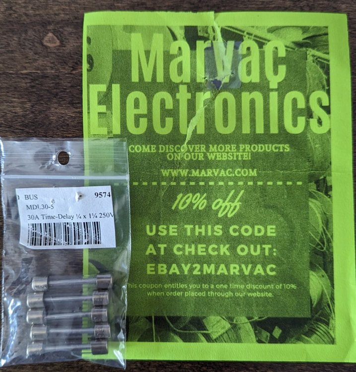

Here's an update to the fuses.
I finally received the new fuses.  They must have taken the low-boat from Ebay, so the receipt indicates.  But what is surprising is how heavy the fuses are.  They really have some weight to them.
Details:
5-pack of Littlefuse MDL-30, 30A 32V Time Delay (Slow Blow), as noted on the receipt.
A total of $11.10 (including shipping - $4.29)
See the 10% off code in my pic.  It may help a bit.
Thanks everyone for the help.
