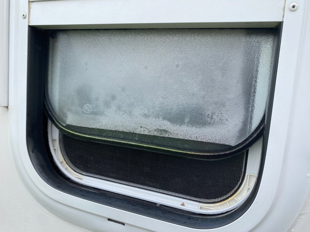

nrvale0 Posted June 4, 2023 Posted June 4, 2023 Hey, y'all. In doing my Spring maintenance work I've noted that my EII's curbside sliding window has a leak and there's now water in between the panes. Curious if anyone else has seen this -- I've read about windows leaking but don't see anything about water inside the pane -- and have any advice as to where I might order a replacement and if I should try to do the swap myself? I imagine these are probably standard-sized windows. Hope that's not wrong.

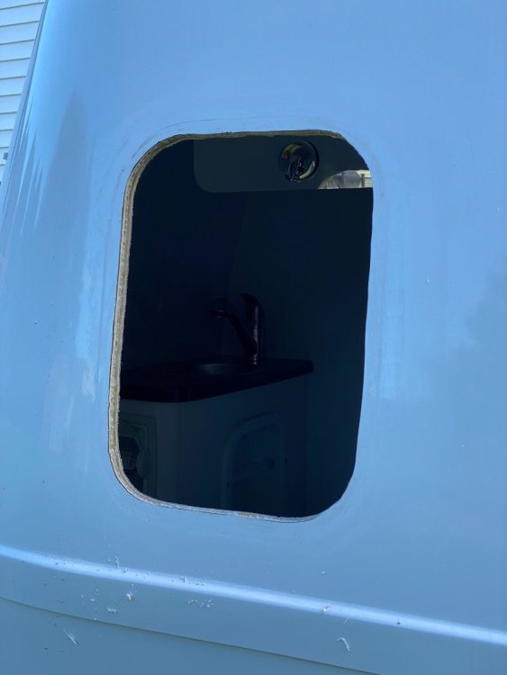

Frank C Posted June 4, 2023 Posted June 4, 2023 I had that problem with the bathroom window on our Oliver. Water actually building up between the panes. The sliding portion was not available separately as a replacement part, so I had to get the entire window from Oliver and replace it. Actually not too hard of a job. Worst part was removing all the old caulk from the fiberglass hull. Here are pics before, during, and after replacement. As another option there are companies that will refurbish the faulty window. At least one other Oliver owner has done that option so hopefully they will reply as well. 5
nrvale0 Posted June 4, 2023 Author Posted June 4, 2023 Thanks, Frank. I guess I'll call Parts on Monday and see what it would run for a new. 2
Moderators SeaDawg Posted June 5, 2023 Moderators Posted June 5, 2023 If it's fogging (broken seal between panes) you can take your trailer to a service center and have the windows pulled,,resealed, and done. We had three big windows done at Suncoast Desgin in Hudson FL for about $1200. lifetime warranty, and great folks. There are services like this around the country. Google "rv window fogging repair" and your area. The bath window may be cheaper to just replace. It's so small. 4 2008 Ram 1500 4 × 4 2008 Oliver Elite, Hull #12 Florida and Western North Carolina, or wherever the truck goes.... 400 watts solar. DC compressor fridge. No inverter. 2 x 105 ah agm batteries . Life is good.

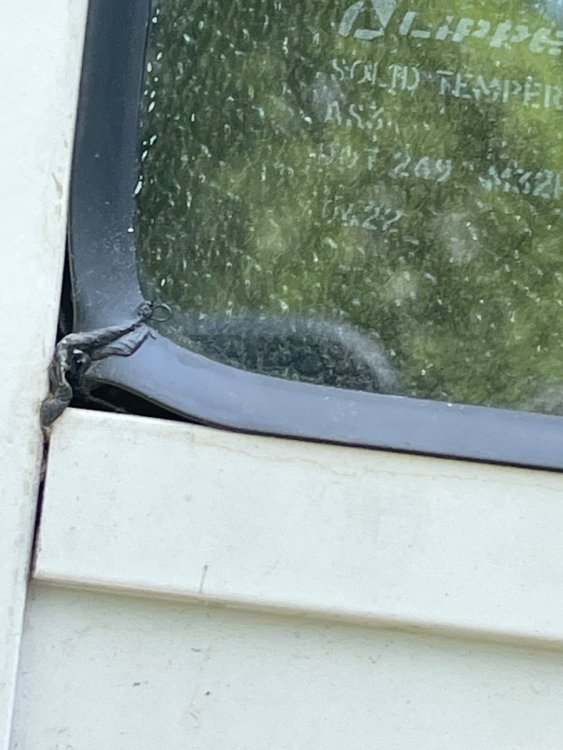

Kansa Posted June 18, 2023 Posted June 18, 2023 I asked about the sealant via a email about another ticket I am working n about the rear window Oliver’s reply was they don’t manufacture the windows and they don’t know what sealant it is…… This is the issue I have inthe back window that I have the ticket on…( pic below) they told me they will “look at it “ when I bring it down in Sept for its first service.. the other thing about the back window is it is kinda cock eyed and doesn’t line up. 🙁 We got it in Oct and winterized just now getting it dewinterize and doing this stuff. this is their caulking I will try to clean it up this weekend 1 1 2022 Oliver Legacy Elite ll Hull 1267 10/6/22 Solar with AGMs 2015 Ram 2500 HD Cummins B&H Hitch
Moderators mossemi Posted June 18, 2023 Moderators Posted June 18, 2023 Your first picture is of the bathroom window and the black seal or gasket is installed by Lippert, the window manufacturer. The picture of the rear window shows a sealant that Oliver uses to seal the window frame to the Oliver fiberglass exterior. Both of these pictures indicate failures in different components used in the manufacturing of an Oliver Travel Trailer. I think your trip to Hohenwald is going to solve both of these issues to your satisfaction and may prevent future failures for you and other owners. I don’t think the bath window is a major concern, but if it does leak, adding some butyl tape would stick to the existing gasket, frame and glass. It will be easier to remove than a silicone product. The rear window does need attention to prevent water intrusion into the basement area and the interior of you Ollie. Document any and all work you do while cleaning up the the caulking around the rear window with notes and pictures and provide that information to the Oliver service department during your upcoming appointment. When I look around our house, I see the same or similar products used in the construction and installation of our windows and sometimes they need maintenance, in our case, it’s to keep the air conditioning in as well as water out. Good luck and reach out if you need additional information, Mossey 1 Mike and Krunch Lutz, FL 2017 LEII #193 “the dog house”

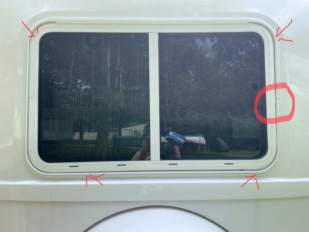

Kansa Posted June 23, 2023 Posted June 23, 2023 In this photo the circled part is the frame seam with the messy chaulking also the arrows point to the gaps that show how crooked it was put together compare the gaps between left and right on top then left and right at the bottom… on the far bottom seam You can see the weep hole on the right. On the left side I can barely get a small pipe cleaner to it…. 1 2022 Oliver Legacy Elite ll Hull 1267 10/6/22 Solar with AGMs 2015 Ram 2500 HD Cummins B&H Hitch
Moderators mossemi Posted June 24, 2023 Moderators Posted June 24, 2023 I certainly agree with your assessment! It is cock eyed. Hopefully the service department will get it sorted out for you. Mossey 1 Mike and Krunch Lutz, FL 2017 LEII #193 “the dog house”
Moderators SeaDawg Posted June 24, 2023 Moderators Posted June 24, 2023 If you have not yet, please open a service ticket. Even if you're out of warranty. Service sends the info to the factory. That install is skewed, imo. 1 2008 Ram 1500 4 × 4 2008 Oliver Elite, Hull #12 Florida and Western North Carolina, or wherever the truck goes.... 400 watts solar. DC compressor fridge. No inverter. 2 x 105 ah agm batteries . Life is good.
