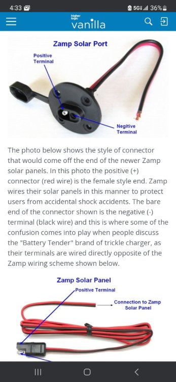

Does anyone know if the aux port is wired through the solar controller, or direct to battery bank?  I just dug out my portable solar suitcase that has a controller.

Mine the positive is fused then connected to the positive busbar under the street side bed, and the negative wire to the negative busbar under the rear dinette seat.

@Wandering Sagebrush, the zamp port is wired "backwards" from sae standard, ostensibly to protect folks from a nasty shock.
Do you know if Oliver installed it originally, or if the previous owner installed? Since this is the first time you're using it, I'd probably check the polarity. If it Checks out wired to zamp standard, you need to use a zamp wired panel for "plug and play, " or buy an adapter to reverse polarity from the panel. Other brands don't wire the same way as zamp....
I’m pretty sure it was from the mothership, but I will throw a meter on it.I have the Zamp portable with both Anderson and SAE.
The PO said he never used it.

That's great news, and I'm glad you'll check everything.  Zamp port +zamp panels "should be" plug and play. But, if never used, I'd check.
As you may have noticed,  I  often play "devil's advocate " and sometomes ask perceivably  "dumb" questions, because I know our posts live on, for a long time.
I have seen posts where folks considered "reversing wiring" to compensate for zamp's port reverse sae polarity. For anyone buying a used trailer with a zamp port, I'd check it, before use.
