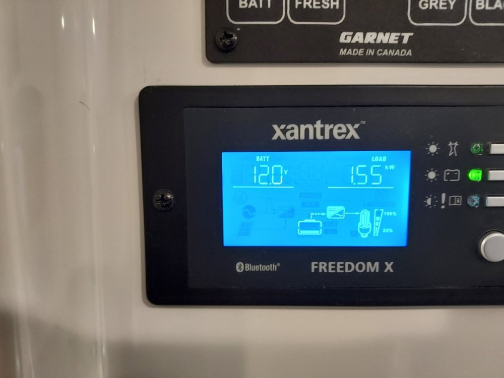

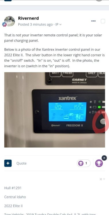

Rivernerd Posted November 14, 2023 Posted November 14, 2023 That is not your inverter remote control panel; it is your solar panel charging panel. Below is a photo of the Xantrex inverter control panel in our 2022 Elite II. The silver button in the lower right hand corner is the "on/off" switch. "In" is on, "out" is off. In the photo, the inverter is on (switch in the "in" position). 1 2 Hull #1291 Central Idaho 2022 Elite II Tow Vehicle: 2019 Tundra Double Cab 4x4, 5.7L with tow package
Moderators SeaDawg Posted November 14, 2023 Moderators Posted November 14, 2023 @Rivernerd, @Cort, this one, circled, in red? Thank you rivernerd. Cort, don't forget to turn it off when you're done with 120 needs. Inverter will drain your battery, even with nothing on 120 running. Best of luck. 1 1 2008 Ram 1500 4 × 4 2008 Oliver Elite, Hull #12 Florida and Western North Carolina, or wherever the truck goes.... 400 watts solar. DC compressor fridge. No inverter. 2 x 105 ah agm batteries . Life is good.

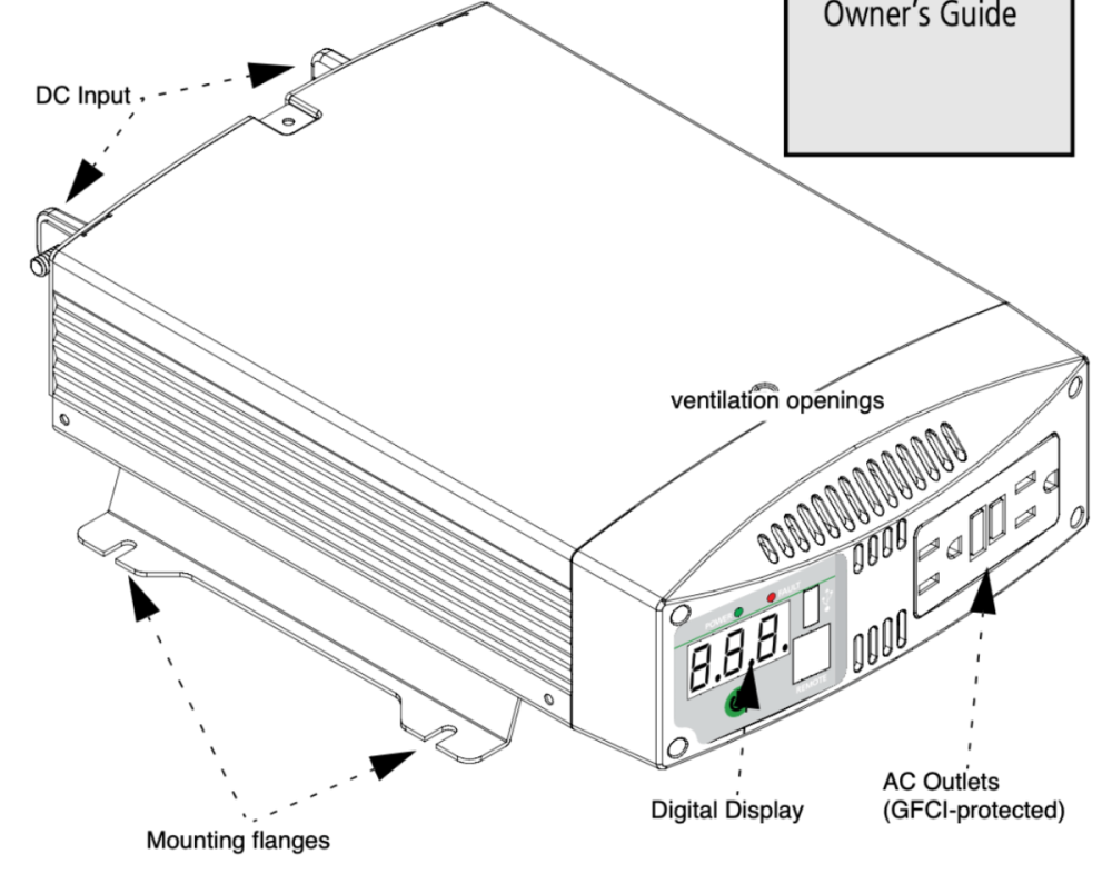

MobileJoy Posted November 14, 2023 Posted November 14, 2023 The PROWatt inverter itself looks like this: 1 2021 Elite II Twin #850 "Mojo", 2020 F250 Lariat 7.3L FX4 3.55
MobileJoy Posted November 14, 2023 Posted November 14, 2023 In case you don't have the PROWatt, the Freedom inverter looks like this. Note it has a control panel. This is a large box that will likely be mounted under the street side bed near the pantry. 2021 Elite II Twin #850 "Mojo", 2020 F250 Lariat 7.3L FX4 3.55
