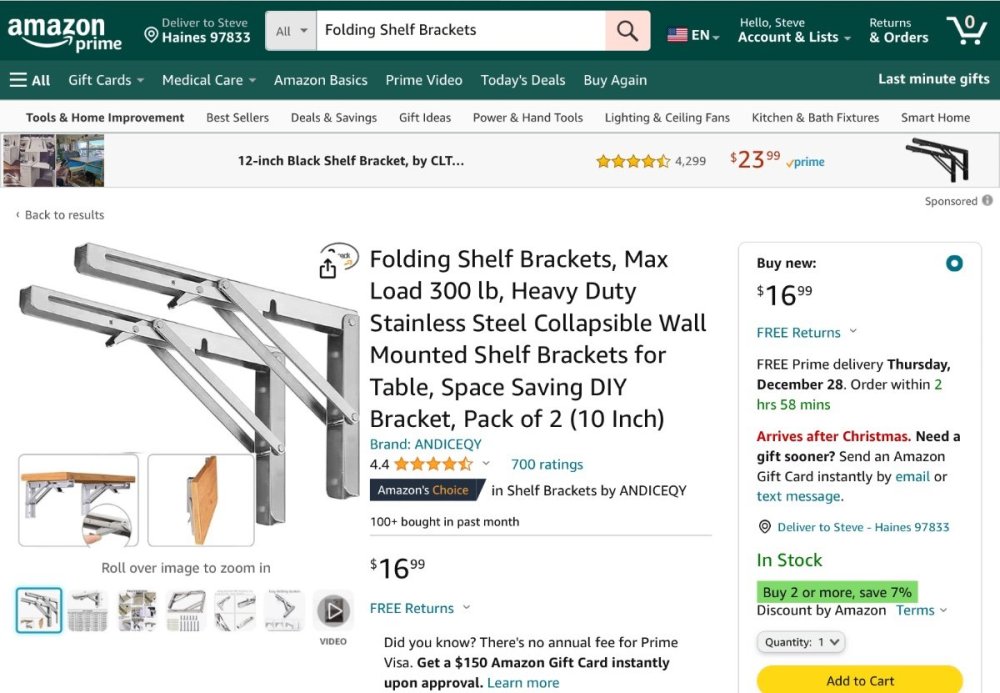

JD, thanks for posting that!   Your use of VHB was part of the solution I was looking for.  I’m thinking of using stainless folding shelf brackets that screw into wood strips that adhere to the counter side.  Also thinking of possibly elongating the bracket screw hole with a slot that would allow a quick removal.   Downside there is exposed screw heads.

JD, thanks for posting that!   Your use of VHB was part of the solution I was looking for.  I’m thinking of using stainless folding shelf brackets...
I went down the same path, had brackets like this on my Amazon Wishlist! Also thought of 'Z' brackets and other removeable options. The folding option was not going to work for us because we just purchased 12" tall mattresses from Brooklyn Bedding (a Phoenix AZ company, see rvmattress.com) and with the taller mattress the shelf would not fold down 90 degrees.
