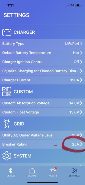

IMG_4893.thumb.jpg.07b1493e9ad748d730aea8004c88d633.jpgI had the same thing happen to me at a nearby campground. We pulled in with the lithiums about 50% discharged and plugged into the 30 amp pedestal. Initially everything was fine but then I could hear the xantrex cooling fan turning on and off every 30 secs.  I also got a communication error with my xantrex remote panel. I later did a software update on my xantrex and the problem never occurred again. I later learned from the campgrounds website that the 30 amp hookup was rated at 20 amps.  I didn’t think it was my ems because it was cycling too quickly. My advice would be to try to reproduce the issue with another power source. Another possible solution would be to decrease the breaker rating on your xantrex phone app to 15 amps from 25 amps.

You may also be able to lower your Xantrex charger current limit parameter to lessen the amount of current being supplied for charging the batteries thus reducing the overall electrical load on the system. This will allow for some usable power for other accessories but will of course cause a longer battery recharge time.
