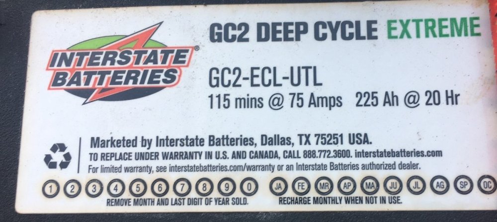

Recent purchase of our older Oliver came with 450AH 6v lead-acid batteries, now 2 years old. We gotta get at least a season or two of camping in before anymore major upgrades, but (2) Epoch 300s is now on the Wishlist for sure!
If that is 4 x 105v 6 v batteries, at 12v,  as configured, they're really only rated for 210 max, 105 useable. (Not recommended to run lead acid below 50 per cent. I try to keep hours above 70 per cent, for reduced cycling/increased battery life.)
The 460 lithium would approximately triple your useable Ah, as it would mine.  (2 x 105 ah, 12v agm)

Prior owner put a in a set of Interstate 6V batteries, from the label is where I added up 450AH at 12V (on the set of 4). The installer did not mark the labels with date codes, but I have the original receipt.
Yep, 50% down is suggested. You can actually run them lower when needed (I made this mistake a few times on a prior set) which reduces the number of duty cycles. Just giving you a reason to upgrade.
