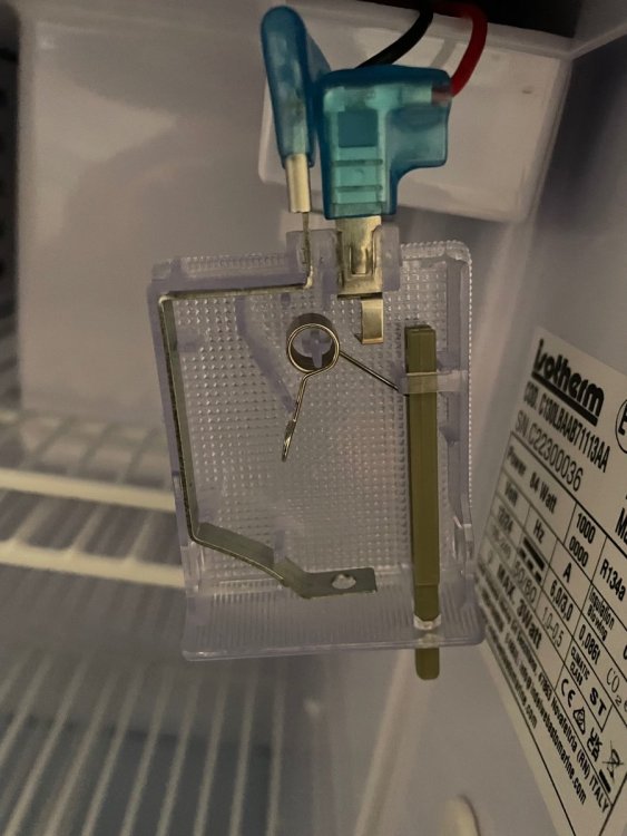

HDRider Posted January 5, 2024 Author Posted January 5, 2024 Can someone please post a functioning fridge light? My bulb popped out and I cannot get that spring back in correctly. Thanks Jeff & Cindy - NE Arkansas - 2023 Legacy Elite II - Twin Bed - Hull #1423 TV - 2015 Silverado 2500 Duramax 4x4

jd1923 Posted January 6, 2024 Posted January 6, 2024 8 hours ago, HDRider said: Can someone please post a functioning fridge light? My bulb popped out and I cannot get that spring back in correctly. Compress the spring so that the straight portion touches the contact above. The rounded part of the spring will hold one end of the bulb and the other end of the bulb sits in the round opening in the bracket below, that wraps around the lens and connect to the other contact (terminal). 1 2 Chris & John in Prescott, AZ | 2016 EII #113 | '01 Ram 2500 Cummins!
HDRider Posted January 6, 2024 Author Posted January 6, 2024 16 hours ago, SeaDawg said: Well, that's a new one. Hasn't happened to me (yet), but here's a video that might help you. It's 10 years old, but these models don't change rapidly, if they work. If it doesn't look like yours, I'd suggest downloading the manual. I could not find a pic in the manual, but that vid did the trick. It is easy now that I know how that spring lies. Thanks Jeff & Cindy - NE Arkansas - 2023 Legacy Elite II - Twin Bed - Hull #1423 TV - 2015 Silverado 2500 Duramax 4x4
