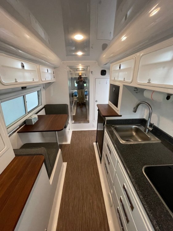

Great mod!  We were fortunate because the previous owner replaced the table, night stand, and pantry tops with beautiful African Sapele.  The table and pantry were extended by 4”.

Just gotta love the "warmth" of wood!
