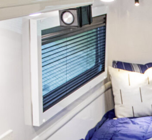

Original window frames, alternate window treatments?
jd1923 replied to Galileo's topic in Ollie Modifications
Impulse All-In-One Roller Shades for RVs - MCD Innovations -
ScottyGS replied to Galileo's topic in Ollie Modifications
Not the ones you see on the virtual tour. Those are the 2026 shades. <moment of silence for those that bought in 26'> The new 2027 shades have a white frame around the window. - Today
Galileo replied to Galileo's topic in Ollie Modifications
https://mcdinnovations.com/products/day-night-roller-shades/ -
From what I could see on the “virtual tour” the window frames look similar - even though the windows are swing-out instead of sliders. From what I could see, it looks like the pull-down shades mount above the window - not on the frame. So I’d bet would could scrap your old shades and adapt the new ones - if you were willing to drill into your inner shell above the window. I -think- I saw “MCD” logo on the window shade. Could likely track them down. -
I have been wondering if the new (2027 model year) window shades would work with the older style windows. The frame looks different but the shade seems to perform the same functions. In October at the Rally I will take a good look at how they are attached and if they could be retrofit to the older sliding style windows. -
Hi all, Im sure this has been discussed elsewhere, but nothing I could find seemed to answer my questions. I removed the window shade assembly from the rear/emergency exit window to hang a cat perch in the frame: Not a great photo due to backlighting - but should be visible. I figure that the window shades that came with our trailer from the factory were not necessarily meant to be paired with this model of window. If it were, there wouldn’t be a need for spacers behind the clips that hold it in place. Im curious if there is a faceplate, bezel, escutcheon, etc that goes with these windows to cover the unsightly screws that show if you pull the shade off. As others have mentioned how far the shades project into the interior, often getting bumper by shoulders or heads - I figure there must be a lower-profile option to both cover the frame and to attach window treatments to. Any thoughts? I don’t know if we’re going to keep this cat bed. The cats don’t seem thrilled, the bed needs work to make it support our lardass 16# cat, and unless I can add curtains - we have no shade/privacy anymore. I don’t think I want to mess with removing and reinstalling the rear window shade every time we move camp or decide the neighbors are too close or nosey. Has anybody done away with the problematic shades and opted for curtains or other window treatments?
