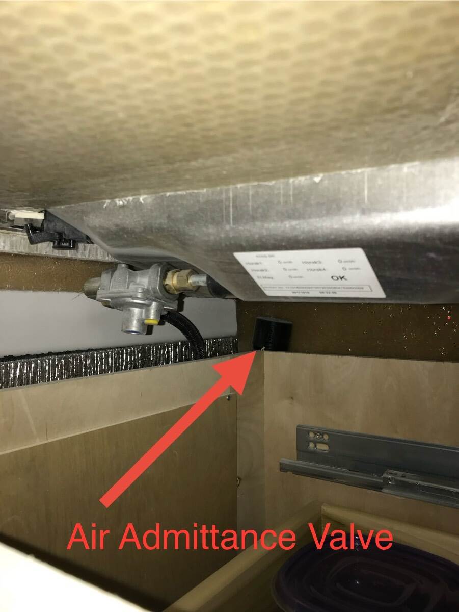

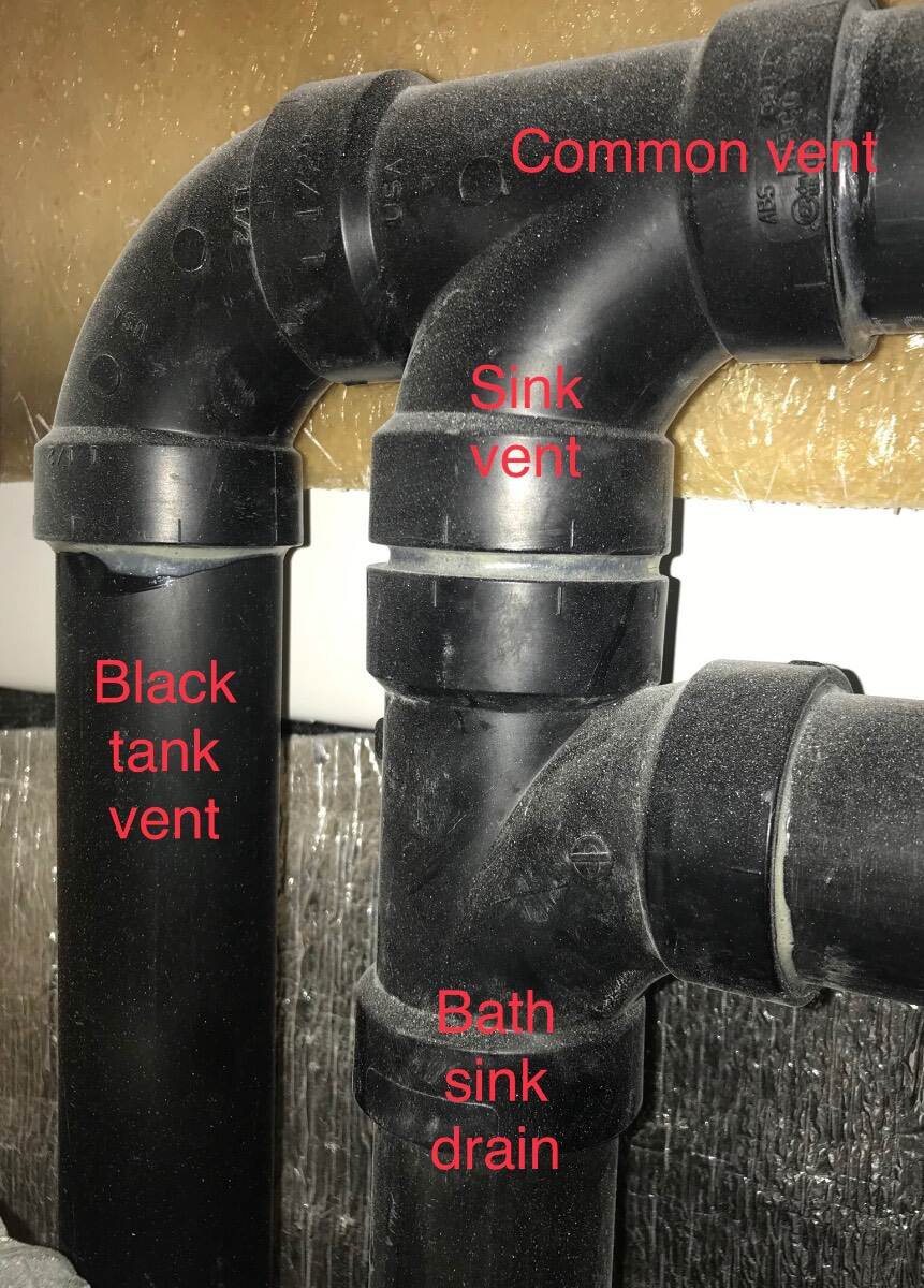

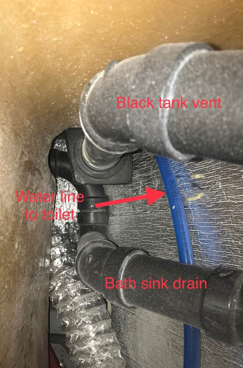

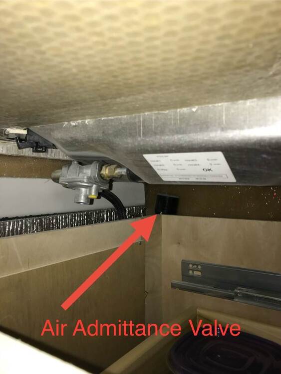

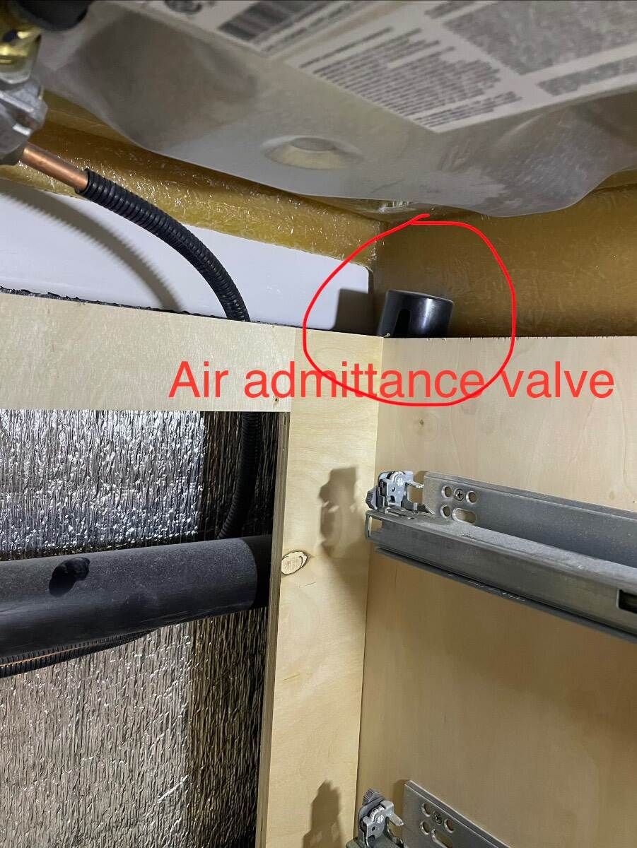

That roof vent vents the black tank all the time and the gray tank only when the shower valve is open. There is an AAV - air admittance valve - under the kitchen counter in the back right corner of the kitchen drawers that should allow air into the gray tank when draining even if the shower valve is closed. The bath sink drain and shower drain flow through the open shower valve to the gray tank. Bill
Doesn’t the vent on the roof vent both the black and the grey tanks, or just the black?

It helps to open the shower drain valve (either manual or automatic) to allow some air into the (forward/high/uphill) end of the gray tank... making it somewhat easier for the liquid to pour out of the rear/low/downhill end of the tank. Don't forget to close this valve when moving the camper or parking extremely nose-down or the gray tank fluid may burble up into the shower floor pan from the long & shallow gray tank, which may not be pleasant. This valve must be open when using either the shower or the bathroom vanity sink.. otherwise these will not drain into the gray tank as expected and the fluid will either stay in or flow into the shower floor plan.
