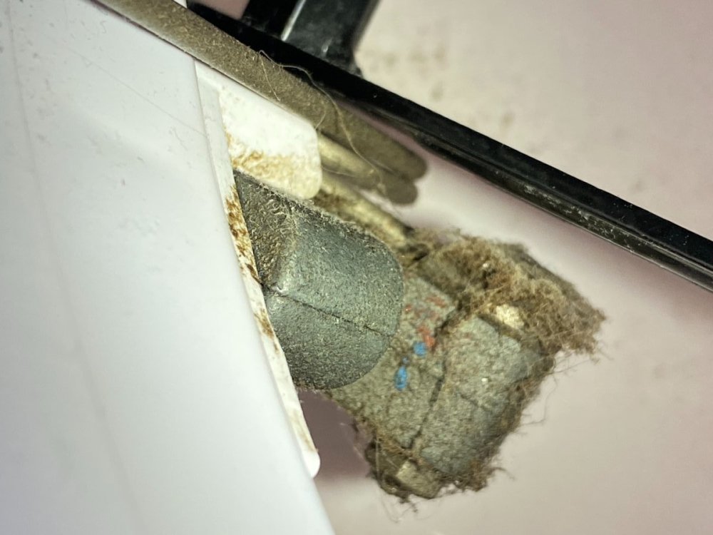

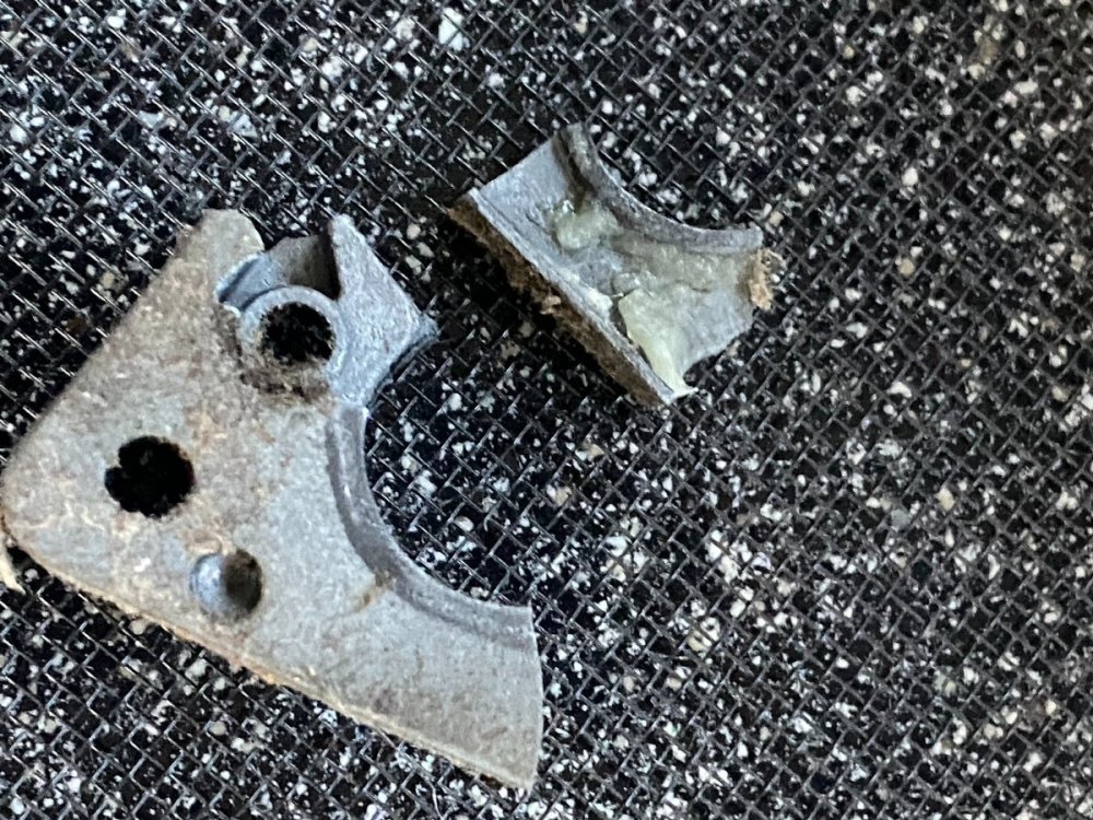

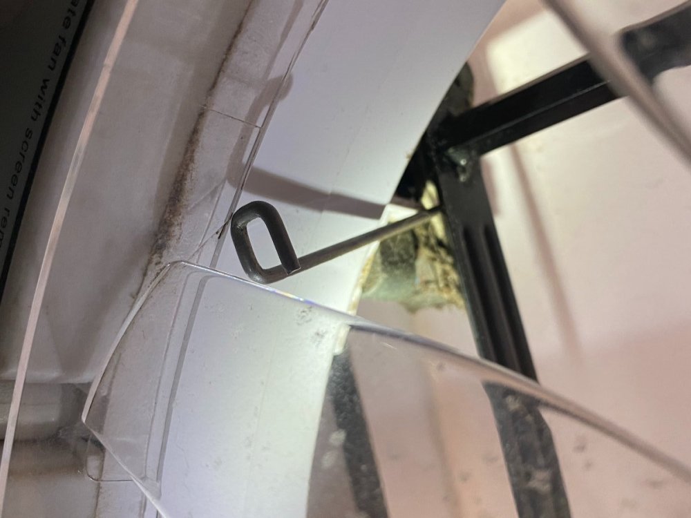

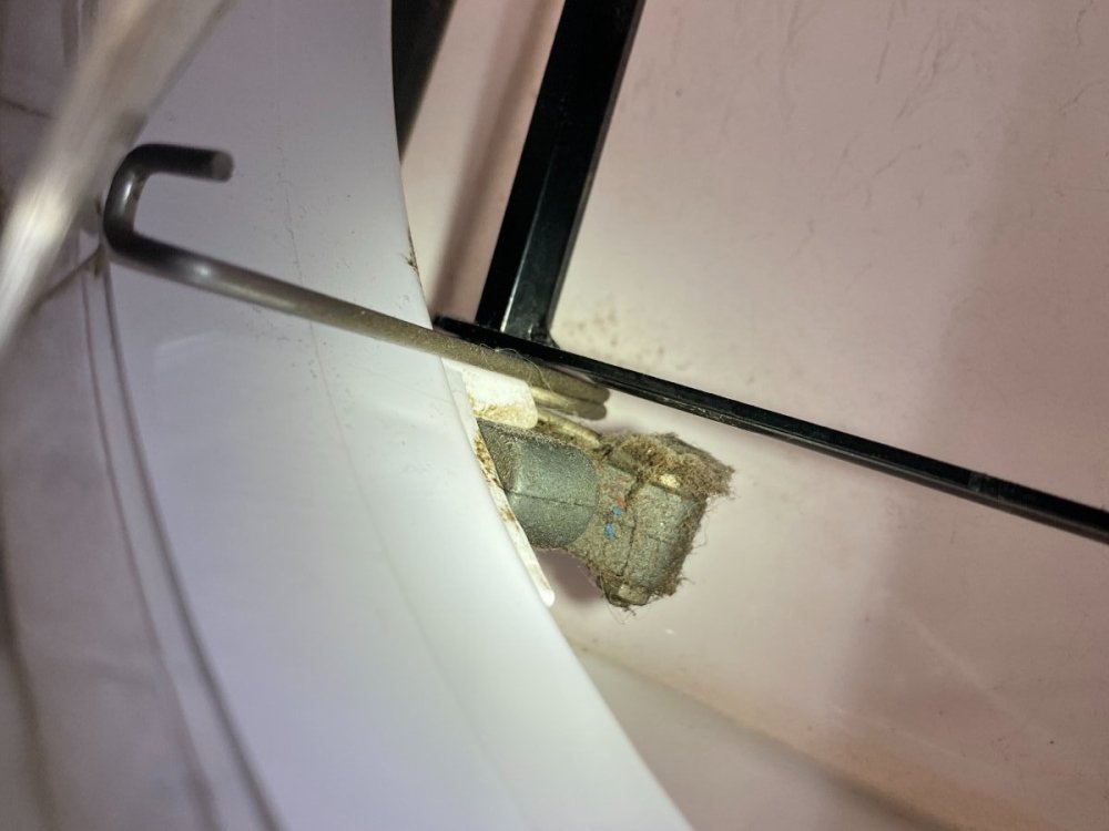

Any Ideas about or advice for this Maxx Air Fan Breakdown?
Spike replied to Spike's topic in General Discussion
Just an FYI for any others who may need this part. ebay wanted $92.99 plus shipping. I was able to order it on Amazon for $40.70 and free shipping since I am a Prime member: https://www.amazon.com/gp/product/B07XD67D86/ref=ppx_yo_dt_b_asin_title_o00_s00?ie=UTF8&psc=1 On the other hand, I wouldn't have known what part to order had it not been for you, Steve. Thanks. -
Thanks, Steve. I ran this by my tech, and he wrote back that it seems to be the part. I asked him, if I ordered this part, would he be able to do the repair. If he answers in the affirmative, I'll order it. Glad I asked here. -
The lifting mechanism. -
We have a 2017 LE2. The fan has worked well until today when I tried to open the cover. It wouldn’t open, and I discovered these broken parts. I texted my RV tech with the photos, failing to send any accompanying written text. While I was writing a new text to explain the photos, he called to say he knew why I had sent the text. He told me that it was a common problem with this Maxx Air Fan and gave me this bad news: The parts are hard or impossible to find. He said it MAY be possible to get them somewhere, but not through the shop where he works and not from Maxx Air. He suggested that, instead of ordering a whole new Maxx Air fan, I might want to purchase a Fan-Tastic fan, telling me that parts for it are usually readily available. I’m OK with replacing our fan with a basic model—without remote and the other features, such as temperature settings. We’ve got a great tech, very familiar with our Olle, who has volunteered to come to me on his weekend off to do the replacement or to make the repair to the Mass Air if I am able to get the parts. (By the way, things in the local RV repair business are crazy: His shop, which is the biggest within 100 miles of where I live, is accepting NO new appointments at this time.) I am open to any ideas concerning finding these seemingly elusive parts for the Maxx Air fan or for opinions on replacing it with the basic (manual open and close) Fan-Tastic fan which seems to run about $220. P.S. I have never been sorry for asking for advice on this forum. For instance, when the side of my Ollie was attacked a few months agog by a very aggressive fence post when I was towing it on my property, leaving an ugly deep gouge into the gel coat on its side, I asked for and received advice on this forum: File an insurance claim and find a good boat repair shop, which I did. If anyone needs a recommendation for a great—but not inexpensive—boat repair shop in Tuscon, PM me, and I will be glad to share my experience. No one could detect the spot now where that aggressive fence post attacked.
