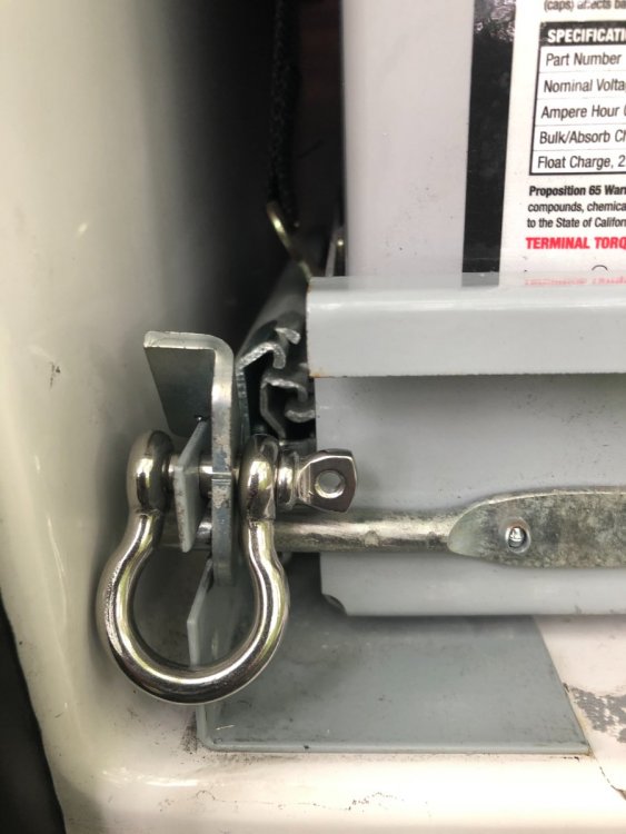

On our most recent outing one of our battery tray latches failed. The pin on the left/fore side of the battery tray was totally missing as was the rivet/pin on which the rear of the latch pawl pivots. Fortunately I found the latch pawl itself loose in the battery compartment. Our temporary fix to get us home included tie wraps and, of course, duct tape to secure the latch pawl in place. The right (aft) side battery tray latch was not affected. Until such time we can arrange a permanent repair, I'm confident that our semi-permanent solution pictured below will serve to keep the tray secure. It consists of a stainless steel anchor shackle holding the latch pawl in place so that it cannot be raised whatsoever, thereby preventing the battery tray from sliding out. I found that the 3/16" shackle fits perfectly, with the anchor shackle pin fitting snugly in the holes. For reference the particular shackle I used is made by National Hardware, #N100-347 and available at Lowe's. Hopefully this information is helpful to those who may experience the same failure. Be safe everyone. - Brian

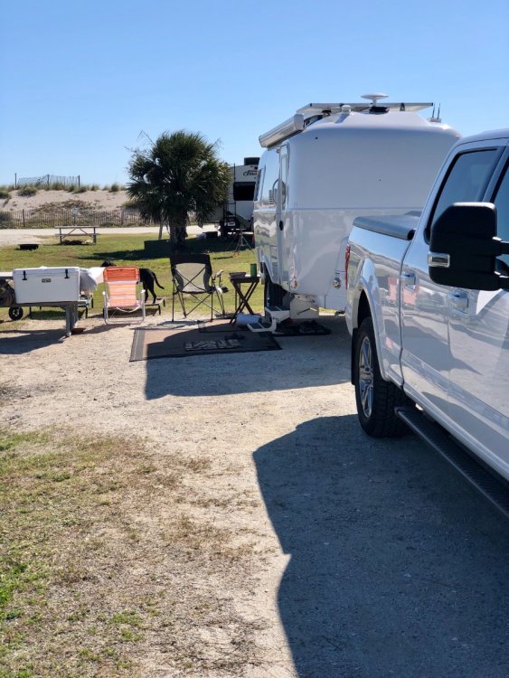

We’re going to miss Edisto Beach State Park. We’ve enjoyed our stay and we were happy to see a very nice looking Elite II at the campground and meet more of the Oliver family! The ocean is on the other side of the dunes in the second picture so you’re not exactly “on the beach” but close enough to hear the surf and take a nice long walk on the beach whenever you want. Many, many shells on the beach. The first night the no-see’ums were terrible and had us making a hasty retreat indoors. The next day they weren’t an issue because it was quite cool but they were back again today, a warmer day. The showers are convenient and clean, the grounds well maintained. We were able to pick up the free wifi with our WiFi Ranger so two thumbs up for that. The antenna picked up a good selection of television stations. Our site (#27) had absolutely no shade but it wasn’t an issue with pleasant daytime highs. Sites have electricity and water, no full hookups. The dump station is located off site, about 1/2 mile on the way out. I’ll happily give this campground an overall rating of “we’ll be back.” Be safe everyone. - Brian [And yes, we did vote early back home!] -

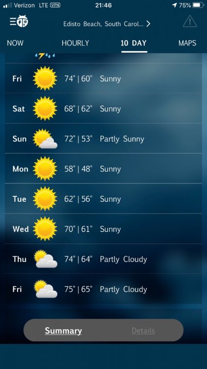

We’re jazzed that the weather is looking great for our beach trip! Starting Sunday and returning on Wednesday. This will be our first time camping right on a beach so we are really looking forward to it. We’ve never been to Edisto Beach; Folly Beach further to the north has been our favorite. We don’t camp right on the beach there but the campground at nearby James Island County Park is awesome. Anyway I hope to post here again after this trip. Keep safe everyone. - Brian
