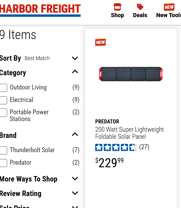

Hi all, Imelda again Hull 642 etc. I am really happy with my newly installed 2X Li Times 230AH batteries and I now want to up grade my solar panels etc. I have already purchased the LiTime 30A MPPT 12V/24V Solar Charge Controller Bluetooth to go with the batteries and now I would like to purchase some light weight efficient solar panels. I was thinking of either 2X 200 watts or 4X 100 watts depending on weight of the panels, (no more that 20 lbs). I was looking at the Predator brand from Harbor freight or the thunderbolt that they carry there. The Predator one looks like the Jackery panels I have on my Jackery power stations. Anyone have have any recommendation on these Harbor Freight brands or any others? I am looking for 400 total watts (EITHER 2x200 WATTS OR 4X 100 WATTS) that are light weight and easy for me to carry and move around to catch the sun.

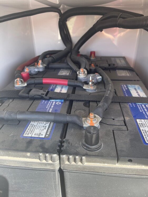

Hi all, Imelda (Hull 642 elite2) again. I need some advice on my 6V battery (see pics below) . They are about 5 years old and not holding charge over night. For some reason I though these were maintance free batteries but I now thinking I should have been topping them up with DI water and pouring the water through the clear plastic round plug. One question how do I top the batteries up if it is not too late and they are already damaged and how do I remove this plug? Second question is: does anyone have 6V battery replacement rcommendations if I have to replace these batteries? I called the Bright Way Group and these batteries are discontinued.
Thank you all. I am going to try these suggestions and I will keep you posted. Imelda

Update to my battery situation. I was having a hard time getting batteries to charge and hold a charge. The previous night I was hooked up to shore power and now the batteries are doing great. holding 12.9V off shore (boon docking), refrigerator is doing great running on propane and no C (low battery error). The batteries seemed to have healed themselves. The batteries are the 6 Volt AGM batteries, four of them. see diagram below I have no experience with batteries but is it possible they got down so low that they could not fully charge with solar or hooked to the truck charge and they needed full up 120V 30A charge to remedy them? Anyone have similar experience? My 2000W inverter has a shut off set about 12.1V so I need to figure how to set it to a lower voltage. It would-be nice to run the microwave for a minute or two to reheat my coffee. I have purchased a Jackery 1500 that I love that can run the microwave, air fryer etc. but it would be nice to use the inverter that I paid for. jd1923 or anyone how do I change the battery shut of voltage lower than 12.1V? Right now I can 30 secs of microwave before it shuts off. Is there a youtube somewhere?

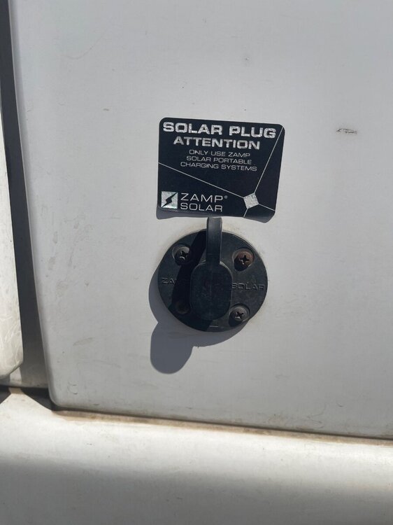

I am sure this topic has been posted before but I cannot find it.. I have had my Oliver 2 for 4 years now and have used it about 3 months out of every year. I went cheap and got the 6V battery option (i do have the 2000W inverter and a zap connector for solar) Now I seem to be having problems holding a charge on these batteries using solar. I think they are shot so I think I need to upgrade to the lithium ion batteries to hold the charge. My Norcold refrigerator comes up with a C error code when the battery reading gets down to less than 10.5. I want to switch to lithium ion batteries so I can use my microwave etc. when boon docking. Can I just take the four 6V batteries out of the battery compartment (see pics) and put 2 lithium ones in and just hook the connectors up as it is? Any recommendations on what the best battery to use?

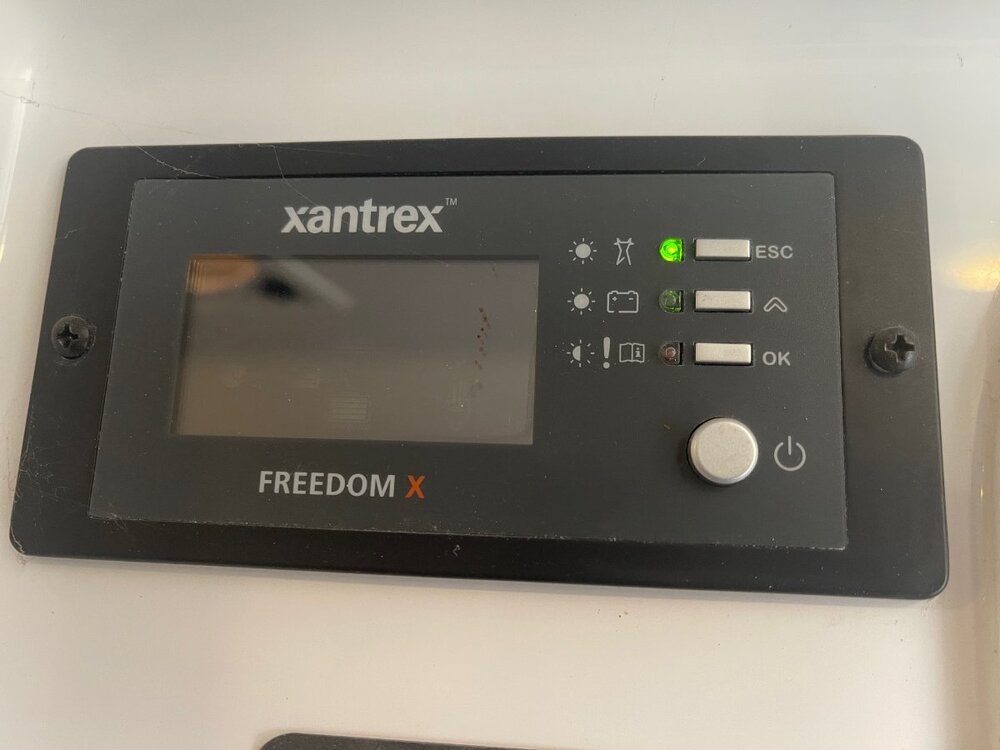

All, I ran into the same problem this last trip. My generator would not work at high altitude so I tried to run my microwave of the my 2000 watt inverter, I have 4X 6V batteries and I remembered early when I got the trailer I was able to run the microwave for a few minutes so I could heat up a cup of coffee. Now it shuts down almost immediately and I checked the cut off voltage and it was 0V and I could NOT reset it to 12V. It stayed at 0V! So should I try the hard reboot on the inverter? Any ideas? Imelda -

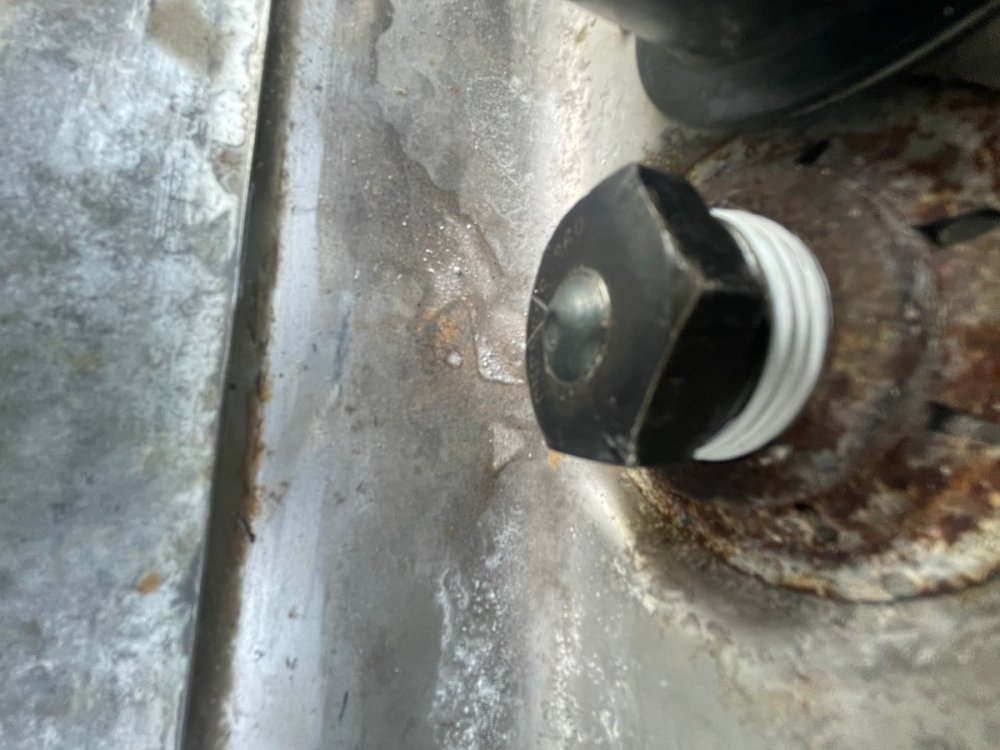

Finally, (this is way too difficult) but I got it to thread using Teflon tape and vice grip to hold it straight and screwing it in at the same time. It took a whole lot longer than I had planned. I am worried about over tightening it and stripping the thread on the heater. But I don't want to under tighten it and have the anode blow out under pressure and have to start all over again,. Any thoughts anyone on how tight I should get it before I turn the water on to the water heater? See pic below. -
Hi all. Anyone had this problem. I removed the water heater anode and drained the tank. Now I am trying to put a new electrode back in but cannot get it to grip to start to grip the thread to start screwing it on. I tried to lean up the drain as best I could to thread in. I have very hard water so there was a lot of calcium build up that I cleaned up with white vinegar but no luck. I am pretty sure the thread is not stripped of damage. Last year I had the same problem and a neighbor got it screwed in for me. Anyone have any ideas?
