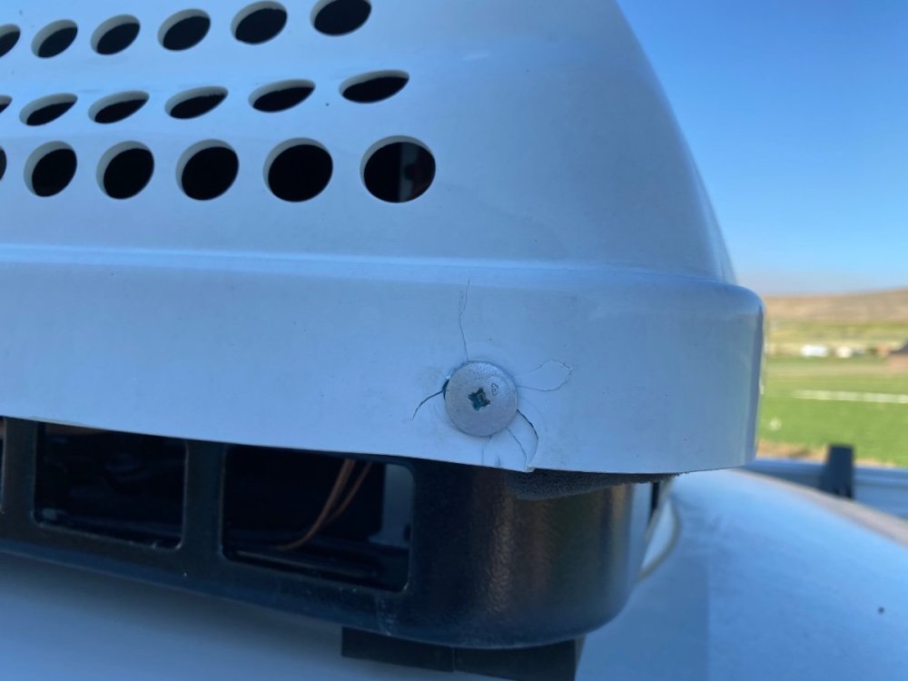

It was a bit windy on the way back home today. When I got home, I found some cracks near the back of the exterior shroud of the Dometic Penguin AC. I know it just happens today as it's not there before I left the campground. Any tips replacing this? Or should I even bother replacing it at all?

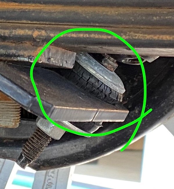

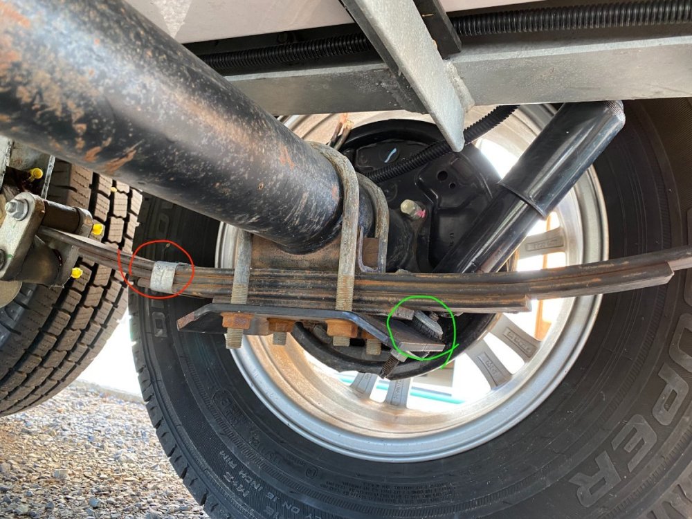

This web page suggested using wire brush to clean leaf springs and applying degreasing fluid after. Does that sound right? Inspected the leaf springs yesterday and notice 3 things. Only 1 rebound clip installed (circle in red below) The rubber gasket (circle in green) is also cracked bad. The nuts at the end of u-bolts are very rusty. Should I be concerned? Thank you!

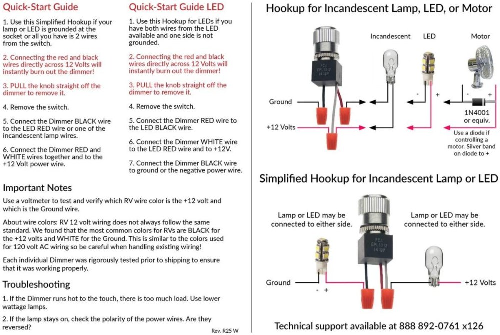

I have not done that but, FWIW, I plan to add dimmer for all outdoor LED lights by replacing the light switch with something like this inline dimmer. I hope that I can just replace a switch using the simplified hookup below. What I am not sure is that the LED lights Oliver using are dimmable or not. I also don't know how I would retrofit the dimmer into the control panel.
