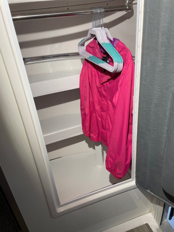

  5. Drinking glass holder is outstanding! I plan to build a smaller version of it! THANKS
  6. If anyone builds something similar or adds to what you see, please share your ideas!
  7. I made the angle in the middle of the shelf 45 degrees to dress it up and put a trim strip on each end. Looks a lot more professional. Plan to also put a cargo net across the from for travel.
  8. Just finished an upgrade to the closet shelves. I built a new version and trimmed it out a liitle better. (will post pictures later today)

  13. Requested pictures with gear. I may take John's idea about a cargo net for travel day.
  14. The closet is a tight fit to work in for sure.
  15. YES, i cut the 2 sides a little long on purpose. then sanded them down till I had about 1/8" clearance. Used 1/4" rubber window roll insulation and forced it into the 1/8 " space. It AIN'T going nowhere!!
  16. Building Process: First I created a template of the floor with a piece of poster paper. I used 5/8 inch plywood to then produce a base piece. I then made two side pieces to go against the two straight walls (shelving board)...(first shelf is 12 1/2 inches tall from the base) They were attached to the base with an additional strip of wood. Nothing is screwed to the camper...I used a strip of window insulation around the edge of the curved surface to eliminate any rubbing against the fiberglass. I then used a piece of cardboard to create a template for the first shelf. I repeated the process with shelf 2. After completing the unit i unscrewed all parts, removed from closet and painted with gloss white paint. Then re-assembled the entire shelf. The post in the middle of each shelf is placed toward the back of the middle of the shelf for additional support.
  17. We do not bring but a few clothes that need to hang. We felt like we were losing so much storage area. I built shelves to fill the lower area of the closet. That curve is a bugger to work with. Shelves have a 4" lip in the front to help hold the gear. They are not perfect but work well.
