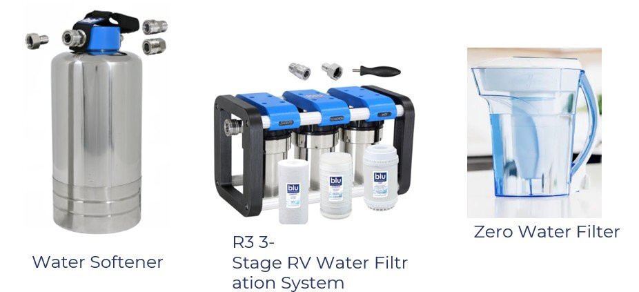

We use a Zero water filter for drinking. Before our water goes into our sanitized holding tank we use the Blu Technologies water softener and the 3 stage filtration system. They sell filters that claim you can use lake or river water if you want to. Yep we are water snobs. -

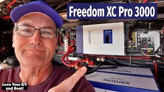

Got it, thanks. I think the soft start is a good idea. We will probably get one too. I was planning on doing some testing when I get home. I see Ray (in the video linked here) says his same inverter will load share, his generator will not start the A/C on its own. He talks about this towards the end of the video @ 16:36 min. He also uses a soft start. We had one on our Dometic AC but upgraded to the much quieter Truma. -

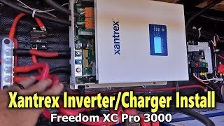

The Xantrex Freedom XC Pro 3000 inverter/charger load shares by prioritizing AC loads. It reduces the charge current to the batteries while maintaining the total input current below the breaker setting, ensuring that connected AC loads receive the power they need. This is particularly useful when running multiple appliances, including those with high startup surges like air conditioners. This video demonstrates how the Xantrex Freedom XC Pro 3000 handles various AC loads and its surge capability: 42s Love Your RV & Boat! YouTube · Jan 11, 2024 Here's a more detailed explanation: Prioritization of AC Loads: The Freedom XC Pro 3000 prioritizes the AC loads connected to it, ensuring they receive the power they need to operate. Charge Current Reduction: To accommodate the AC loads, the unit intelligently reduces the charging current going to the batteries. Input Current Management: It manages the overall input current, keeping it below the breaker setting, even when multiple appliances are running simultaneously. Example: If you have a 50-amp shore power connection and are using a 30-amp load, the charger might reduce its current to 20 amps to ensure the 30-amp load gets enough power. This video explains how the inverter/charger manages power distribution between AC loads and battery charging: 1m Love Your RV & Boat! YouTube · Dec 23, 2023 Load Sharing with Generators: The system can also work with generators, allowing you to run multiple appliances simultaneously, including those with high startup surges, by managing the power flow from the generator and batteries. Benefits: This load sharing feature allows for more efficient use of available power and prevents tripping of breakers due to excessive current draw. Example: You can run a microwave and an air conditioner at the same time, even if they are both drawing a significant amount of power. -

It is my understanding that the Xantrex 3000 Freedom Pro XC should be able to load share. So if your running the Honda 2000w generator with the inverter switched on and you start the air conditioner the inverter should make up the difference in the start up surge. You should not require a soft start. You said you had the large battery bank so my assumption is you have the 640ah batteries with the 3000w inverter. I run our Truma off the battery bank no problem. The generator we carry is 4000w propane, but I have been looking into using our 2000w Honda which is about half the weight. You may want to check with Oliver or Xantrex but I’m pretty sure it should work. There is a setting for transfer speed Oliver suggests it be set to “Appliance” 20ms but it can also be set to UPS 10ms. I would think that might be better but maybe someone more knowledgeable than me can chime in. I know in the past we have lost shore power and didn’t even know since the inverter takes over instantly. Which is why I keep it off until needed.
