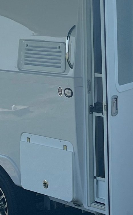

rich.dev Posted April 13, 2024 Posted April 13, 2024 4 minutes ago, Wandering Sagebrush said: I notice that the new Ollies still retain the upper vent. I still have the outside upper vent on my 2023 with the 12V Isotherm fridge, but no more outside upper vent on the 2024s though. My 2023 ..and a 2024 1 2 2023 Elite II, Hull# 1386, Lithium Platinum Package (640AH, 400W Roof Solar, 3000W Xantrex Inverter), added 400W Renogy Solar suitcase with Victron MPPT 100/30 CC, Truma water heater & AC TV: 2024 Silverado 2500HD 6.6L 10-Speed Allison
Wandering Sagebrush Posted April 13, 2024 Posted April 13, 2024 @rich.dev, thank you! I had not seen photos of the 2024 model. 1 Hull #364 - The Roadrunner 2023 F350 CCLB SRW 6.7L
