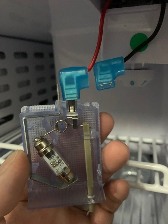

HDRider Posted April 26, 2024 Posted April 26, 2024 On 4/24/2024 at 11:47 PM, Jason Foster said: I disconnect the light. Your comment prompted me to go take another look at the fridge light. My light and thermostat seem to be one unit with a wire going into the interior of the fridge. I do not see a way of pulling the plug on the light. Can you illuminate on how you disconnect the light. 1 Jeff & Cindy - NE Arkansas - 2023 Legacy Elite II - Twin Bed - Hull #1423 TV - 2015 Silverado 2500 Duramax 4x4

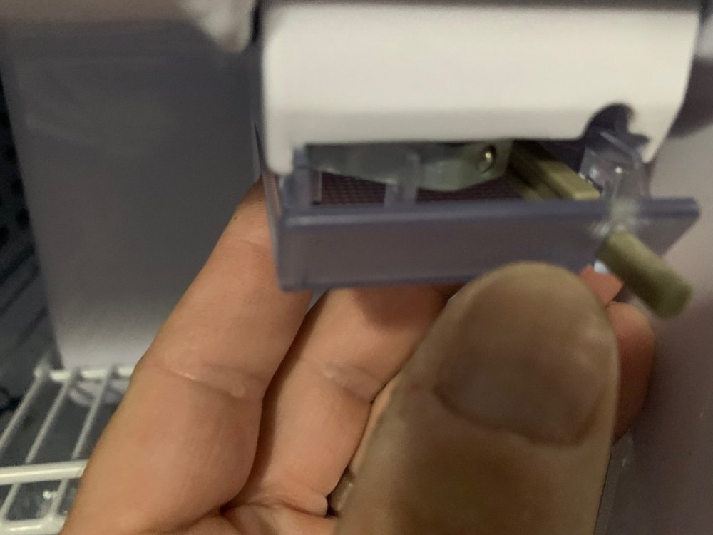

Jason Foster Posted April 27, 2024 Posted April 27, 2024 14 hours ago, HDRider said: Your comment prompted me to go take another look at the fridge light. My light and thermostat seem to be one unit with a wire going into the interior of the fridge. I do not see a way of pulling the plug on the light. Can you illuminate on how you disconnect the light. Certainly. Pull forward on light housing: Ignore bulb and remove electrical connection at back: 1 2 2014 Ram 2500 Cummins Diesel 4X4 Truck 2024 Oliver Legacy Elite II Hull 1460
