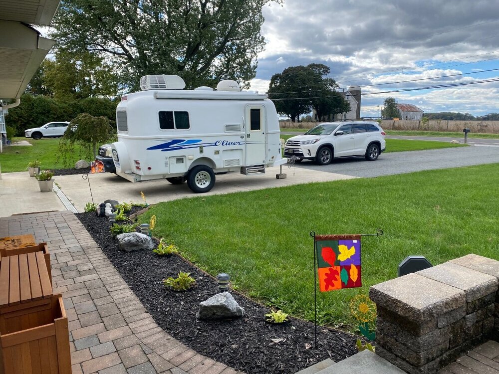

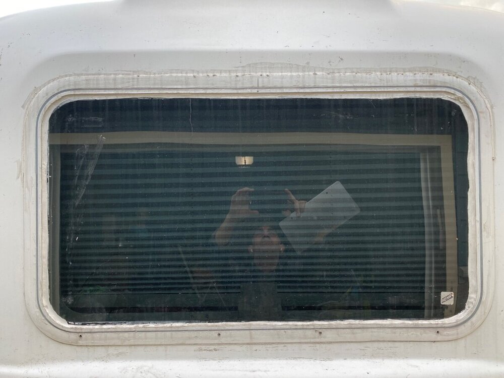

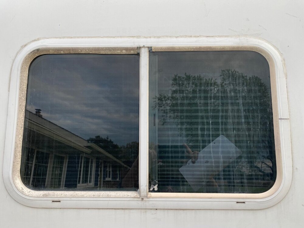

Fernando Alicea Posted May 16, 2024 Posted May 16, 2024 Hi friends my name is Fernando Alicea im from NJ. 8 months ago I purchased a use Oliver Hall#6 2008 from the original owner in Tennessee. He have problems with water leaking on all the windows. The emergency window on the back is completely sealed with clear silicone and the other widows a lot of work been done to them throughout the years. I really want to bring it back to the original condition. If any body knows where can I buy the original windows I will appreciate any help. thank you 1 3

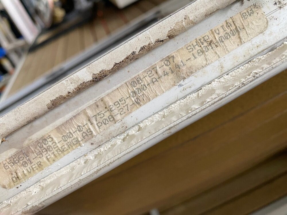

Fernando Alicea Posted May 17, 2024 Author Posted May 17, 2024 Hi thank you I open a ticket yesterday I have a reply today. They are telling me they don’t have this. They are discontinued. I have pictures of the label but it dose not say the manufacture. I ask Oliver to provide me the manufacturer. thank you ///Fernando
Moderators SeaDawg Posted May 17, 2024 Moderators Posted May 17, 2024 (edited) Hi, Fernando. You now own a little piece of history! #6! Wow. Hehr was the original window manufacturer. Some years ago, they were bought out by Lippert. I do not believe that the exact same size windows are available, anymore, but slightly larger is . I would open a new ticket, and specifically ask Jason, as they refitted #1 as original, a number of years ago. That said, there may be nothing wrong with your original windows. The mildewed seals can be replaced. Do they all open and close properly? The back window may or may not actually be the leaking culprit . Most of us early hull owners have found that the true problem was the Oliver sign above the rear window. You'll know if that's the culprit if you tape all around it with clear or white duct tape. That said, our rear window did leak at one time, fairly early on. We corrected that problem by removing the window, cleaning up all the old caulk (not an easy job with all that silicone smeared everywhere on yours), and reinstalled it using synthetic butyl "tape" as a bedding material. Our rear window rough opening was pretty "rough" indeed, and a tiny bit larger for the window than it should have been, but since carefully reinstalling with butyl many years ago, we've had no leaks from the window. If any of the double pane windows have fogged, there are a number of places around the country that will remove and repair fogged windows. I can highly recommend Suncoast Design in Hudson Florida, should you want to travel. There are still a handful of original 2008 owners who are friends of mine. Some, like Pete (bugeyedriver on the forum) are still active here. We're all happy to help. Sherry/Seadawg Edited May 19, 2024 by SeaDawg 3 1 2008 Ram 1500 4 × 4 2008 Oliver Elite, Hull #12 Florida and Western North Carolina, or wherever the truck goes.... 400 watts solar. DC compressor fridge. No inverter. 2 x 105 ah agm batteries . Life is good.
