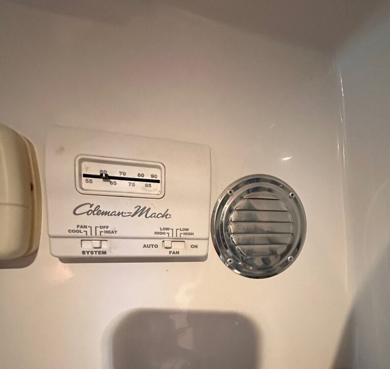

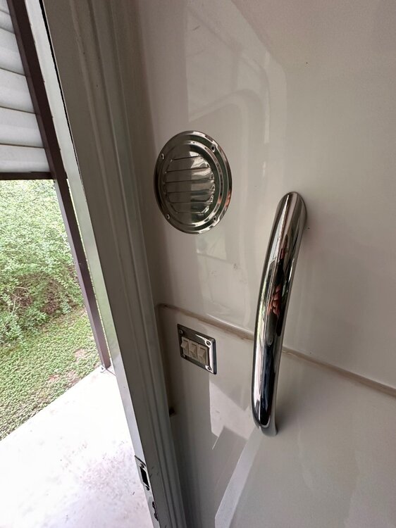

Moderators bugeyedriver Posted June 20, 2024 Moderators Posted June 20, 2024 (edited) Here are pictures of the two air vents in my 2008 Elite. You can see one is located on the wall as you exit the trailer, and the other is in the galley area, on the wall to the left of the sink. They provide passive venting from the rear of the space containing the oven. Not sure of a source for the vents, but you get the idea and should be able to find something similar. If you are particularly handy and inspired, consider a tiny switch activated fan mounted behind one of the vents which could turn it from a passive to an active heat protection. Good luck! Be sure to post pictures of your finished project. Edited June 20, 2024 by bugeyedriver 1 5 Pete & "Bosker". TV - '18 F150 Super-cab Fx4; RV - "The Wonder Egg"; '08 Elite, Hull Number 014. Travel blog of 1st 10 years' wanderings - http://www.peteandthewonderegg.blogspot.com
Moderators SeaDawg Posted June 21, 2024 Moderators Posted June 21, 2024 (edited) We have the same vents in our 2008. Probably could find them in good stainless at Seadog. If I carried an air fryer, I'd take it out of the cupboard for use. Actually, I'd probably store it in a bin under the bed, or on the floor of the closet. That microwave cavity made a super pantry space for us, when we removed the never used microwave. Edited June 21, 2024 by SeaDawg 1 2 2008 Ram 1500 4 × 4 2008 Oliver Elite, Hull #12 Florida and Western North Carolina, or wherever the truck goes.... 400 watts solar. DC compressor fridge. No inverter. 2 x 105 ah agm batteries . Life is good.

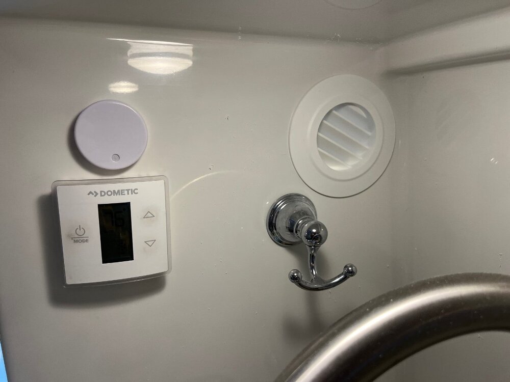

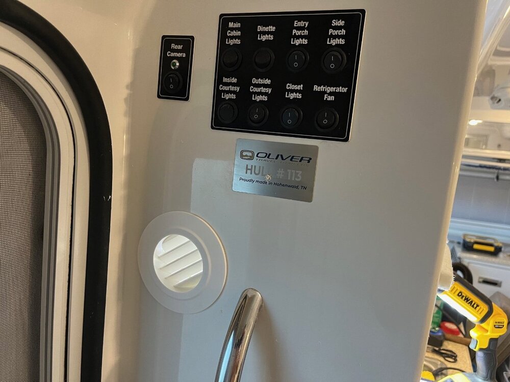

jd1923 Posted June 29, 2024 Author Posted June 29, 2024 (edited) Thanks again @bugeyedriver and @SeaDawg. I cut vents today and got most of the upgrade finished! I went with these which I had already purchased for my heat duct project to vent the closet and basement areas: 3 Inch Vent Cover, Hon&Guan 3 Soffit Vents Exterior Round Soffit Vents with Built-in a Fly Screen for Bathroom Office Home-2PCS - Amazon.com There were metal versions, but I thought metal would conduct heat and maybe scar the external fiberglass. Edited June 29, 2024 by jd1923 typos 1 Chris & John in Prescott, AZ | 2016 EII #113 | '01 Ram 2500 Cummins!

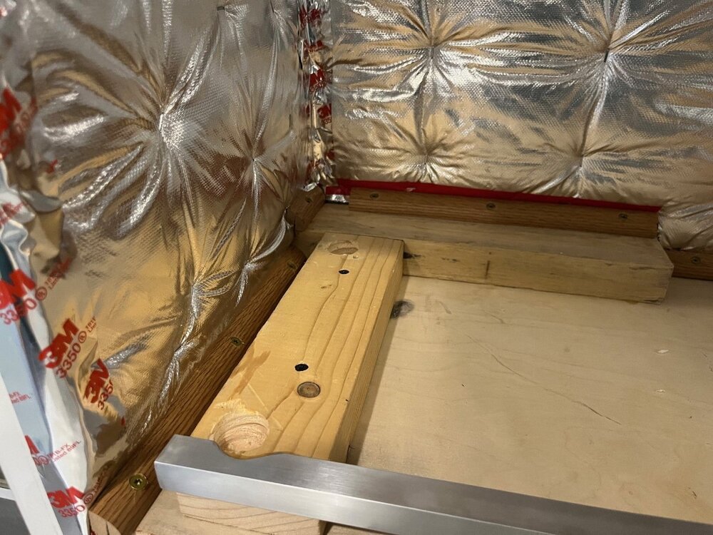

jd1923 Posted June 29, 2024 Author Posted June 29, 2024 First step was to center the Emeril Air fryer. It needed to be raised about 3/4" or more, so I set it on two 2x4s with cutouts, hole drilled to hold the legs. This gave me the lift I need and a way to secure the oven. When I got the mount ready, I merely used some wood glue below and was able to then move the oven a little to get it exactly square. The next day after the glue had set, I added a couple wood screws to secure (the 2x4 in the rear was part of the original microwave installation). 3 Chris & John in Prescott, AZ | 2016 EII #113 | '01 Ram 2500 Cummins!
jd1923 Posted June 29, 2024 Author Posted June 29, 2024 Next step was to drill the vents. I went 1/4" or so down from the ceiling of the opening and as far back as possible. One the left side, you could only go so far back because the entry door area is further in for the flat door frame vs. the other curved walls. Both sides took careful measuring. Used a 2 3/4" hole saw from the inside first for positioning. After making the center mark, I drilled through with a 1/4" drill. This way I could place the hole saw mandrel into the hole and make sure the hole saw was in the best position. I used the vent on the outside, to also see that the larger outside vent surface had adequate room. Here are the results. 3 Chris & John in Prescott, AZ | 2016 EII #113 | '01 Ram 2500 Cummins!
jd1923 Posted June 29, 2024 Author Posted June 29, 2024 I was putting off the work of insulating the opening. I had never done such a task or worked with ceramic insulation before. Turns out this material worked well: Amazon.com: CeraTex 3180 Blanket with Aluminum Foil Facing, 8 LB Density, 1/2" x 24" x 60" (5'), 2300°F High Temperature Insulation for Kiln Stove Furnace Glass Fusing Pizza Oven : Arts, Crafts & Sewing After cutting the main section, top and rear in one piece, I used 3M spray adhesive to get it started and it worked better than I had expected. I finished with a power staple gun with 3/8" staples to secure it. I was afraid that the staple gun would pierce the foil layer of the insulation, so at first I used some electrical tape to help and then realized it was unnecessary (red tape at bottom). Then I cut the two side pieces which had a curved rear, following the curve of the Oliver upper shell. I placed these in position and used a Sharpie to mark the vent holes and cut these out with scissors. Glued and stapled the left side and went without glue on the RH side, since the thermostat cable is behind that one and I may need to service that with an A/C upgrade. Really happy in how it turned out, which is often the case after days of contemplation! I have one trim piece to fabricate which will hide the 2x4s below the oven and then remount the bezel from the original microwave, and she's done! Last step and pics tomorrow. 5 Chris & John in Prescott, AZ | 2016 EII #113 | '01 Ram 2500 Cummins!

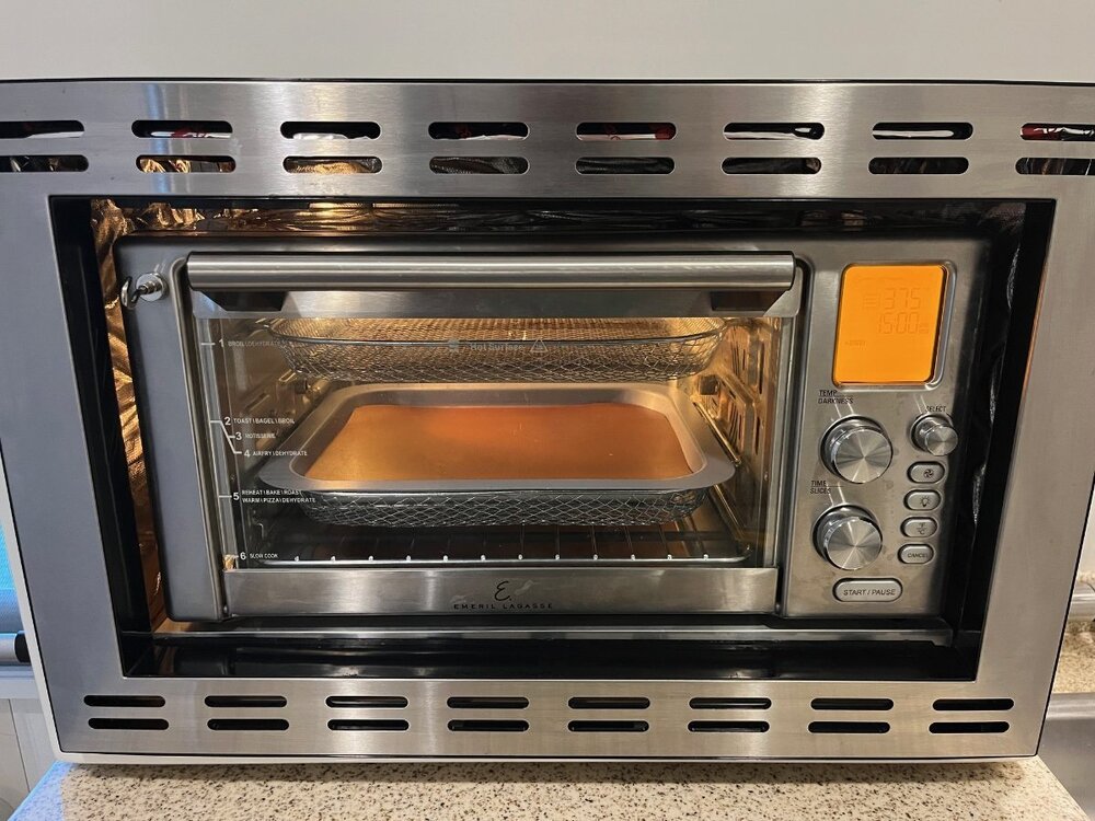

jd1923 Posted July 2, 2024 Author Posted July 2, 2024 Got everything done today on the air fryer installation. I put quarter-round along the base and 3M 3350 to seal all the edges and seams. Found a decent piece of angle aluminum as a trim piece to make the bottom opening look better and remounted the faceplate. 7 Chris & John in Prescott, AZ | 2016 EII #113 | '01 Ram 2500 Cummins!
jd1923 Posted July 3, 2024 Author Posted July 3, 2024 (edited) Ran a valid test today. Had to wait 24 hours for the glue to set on the vents. Cooked hash brown patties for our breakfast today. The Emeril was set on air fryer, 380 degrees for 21 minutes. The vents were just warm to the touch, not hot. The RUUVi sensor mounted above the Dometic thermostat on the right upper outer wall of the oven went up just one degree, kicked the A/C on. The cabinet facing, in front just above the oven, was a little warmer than the vents, yet I could still rest the back of my hand on it NP. The kitchen cabinet above was not hot at all due to the heat insulation wrap installed. I'd say this mod passed the test! 😂 We can now have crispy air-fried foods on the road, no setup time dragging a heavy oven out of storage, no extra time cleaning up. This way, we will likely use it daily when camping, like the larger Emeril we have in our home kitchen. Anybody else interested in this oven? Check out the Amazon used price at $80! They also list a "very good" one for $85, that is new but not in original packaging: Amazon.com: Emeril Lagasse Everyday 360 Air Fryer, 360° Quick Cook Technology, XL capacity,12 Pre-Set Cooking Functions including Bake, Rotisserie. Broil, Pizza, Slow Cook, Toaster and Much More, Stainless Steel : Home & Kitchen Edited July 3, 2024 by jd1923 2 2 Chris & John in Prescott, AZ | 2016 EII #113 | '01 Ram 2500 Cummins!

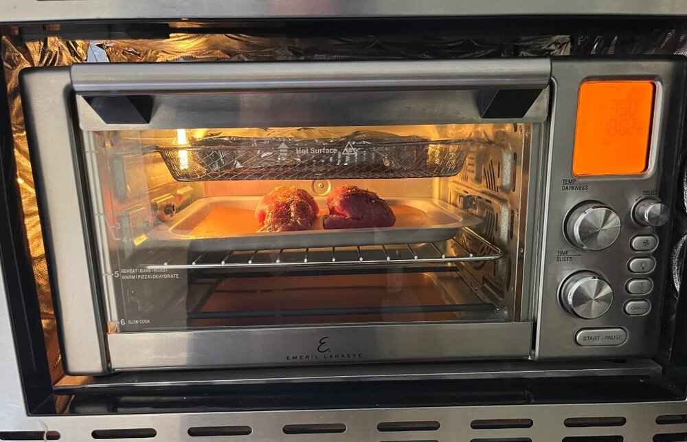

jd1923 Posted October 31, 2024 Author Posted October 31, 2024 On our madden voyage with the Emeril Air Fryer/oven (and so many other mods). We’ve baked potatoes, made toast for breakfast, cooked veggies, reheat leftovers! This oven has a dozen settings. Last 2 days in NM it’s been WINDY, up to 40 MPH! So tonight, at Rockhound NM SP, we are truly baptizing the oven! Set at 350F bake for 50 minutes, we’re having pork tenderloin with Au’ Gratin potatoes. First time for meat fats in this oven, though we cook whole chickens in our larger home model and could here as well. Oliver camping is NOT roughing it, not hot dogs and Smores by the campfire! 2 Chris & John in Prescott, AZ | 2016 EII #113 | '01 Ram 2500 Cummins!
