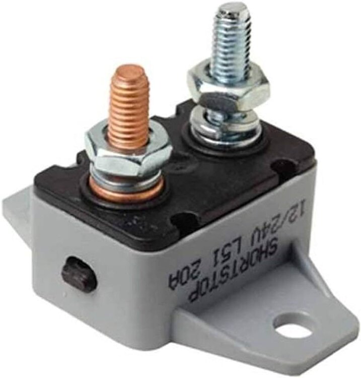

Steph and Dud B Posted Wednesday at 03:56 PM Share Posted Wednesday at 03:56 PM (edited) 43 minutes ago, mthom said: wasn't sure it was a breaker. How do you reset it? Yes, that looks like a circuit breaker. Some of those are manual reset, some are auto reset. Look/feel for a small reset button on one side of the breaker, similar to this photo. Very surprised Oliver Service didn't tell you about this. Edited Wednesday at 04:10 PM by Steph and Dud B Added photo. Stephanie and Dudley from CT. 2022 LE2, Hull #1150: Eggcelsior. Tow vehicle: 2016 GMC Sierra 6.0 gas dually 4x4. Our Oliver journey: Steph and Dud B's RV Screed Where we've been RVing since 1999: Link to comment Share on other sites More sharing options...
