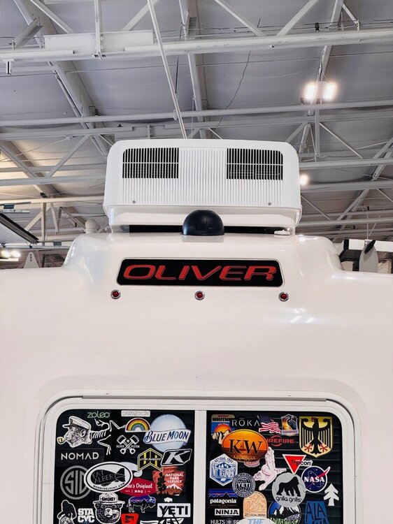

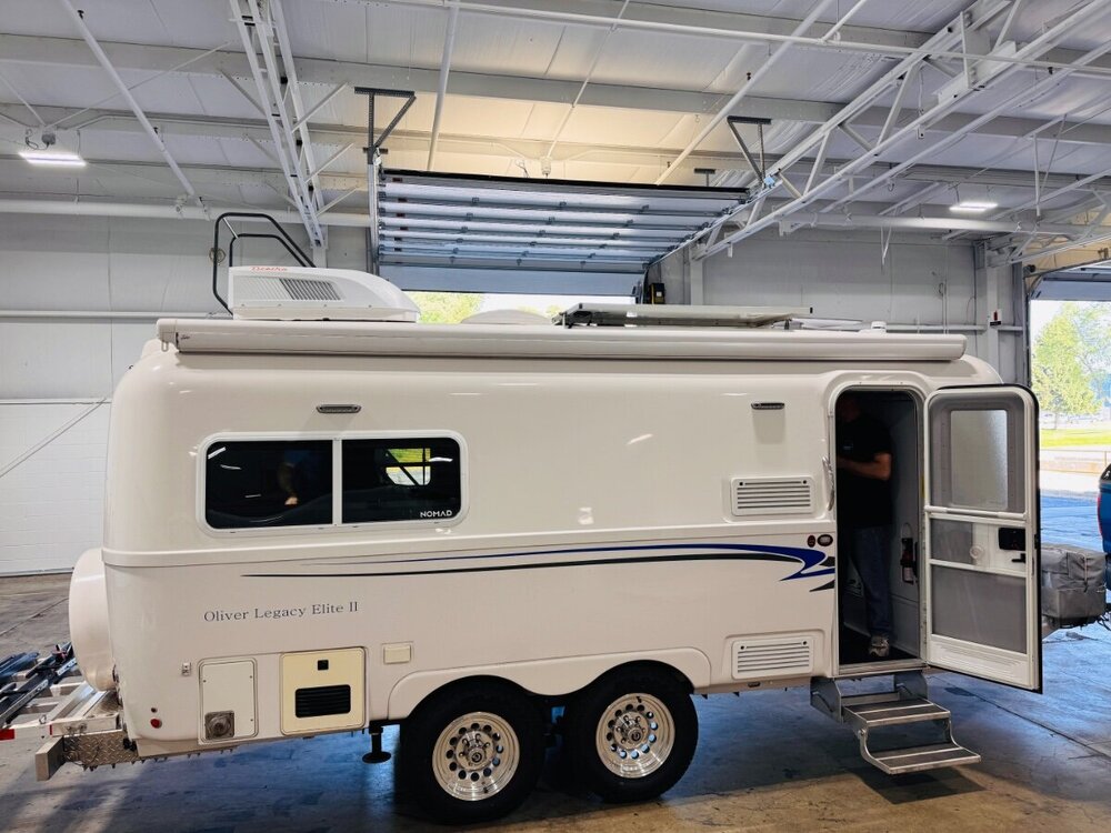

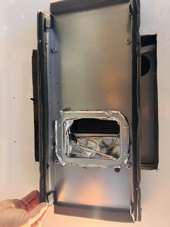

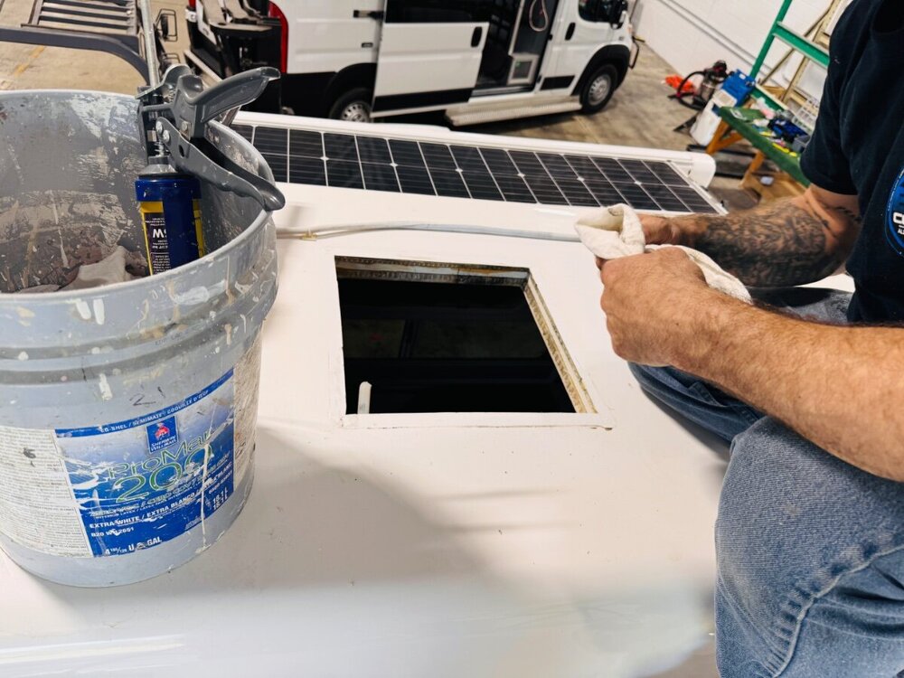

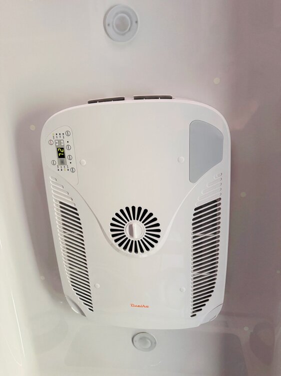

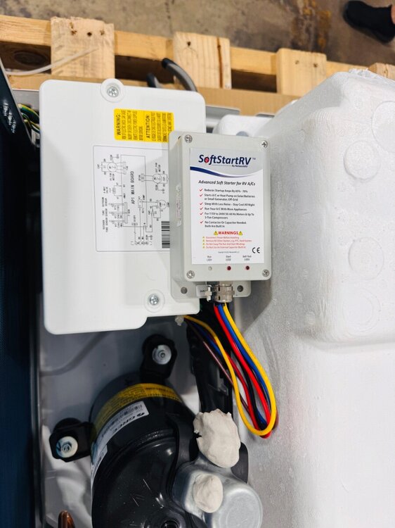

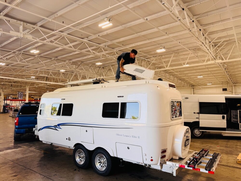

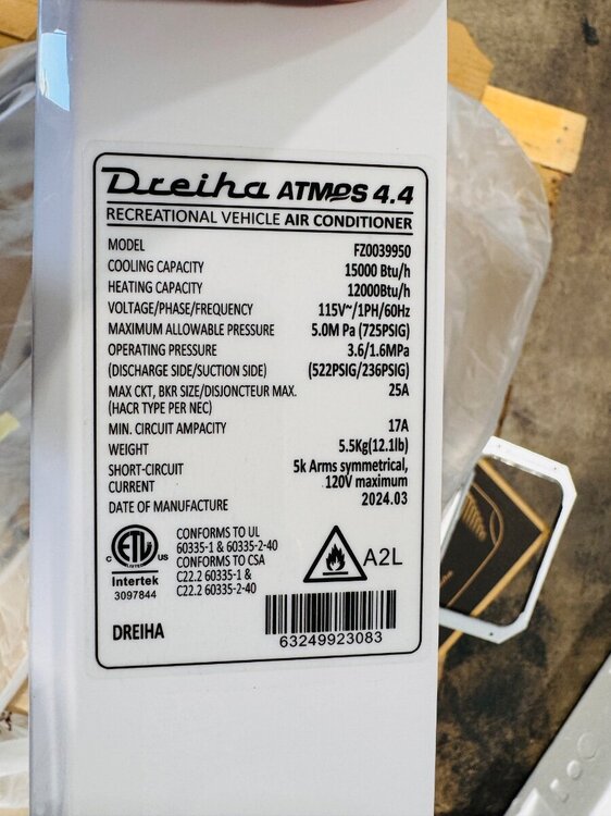

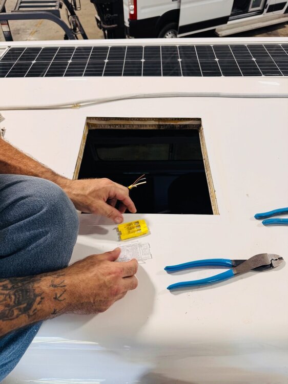

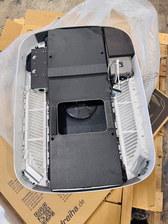

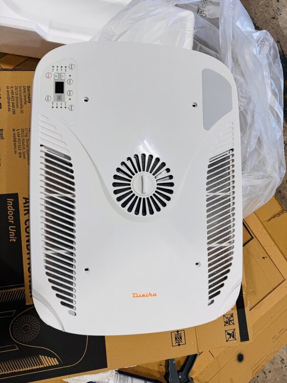

Popular Post rideadeuce Posted July 17, 2024 Popular Post Posted July 17, 2024 (edited) On the last leg of our summer family vacation we stopped at my dad's in MI. Next morning, I drove down to Elkhart, IN and had SDG install the Atmos 4.4. Guys were on time, efficient and knowledgeable. Installation went great! Pics below: They now offer SoftStart as an option on their website but I brought my own SoftStart Breeze (smaller version) . Atmos 4.4 Pics Removed the old Dometic Penguin II, cut drain line and plugged. Cleaned surface, applied very small bead of Dicor self-leveling on the inside perimeter of fiberglass 14 x14 opening Removed interior shroud. Penguin shroud was screwed to fiberglass ceiling, the 2 holes on each side will barely show after Atmos plenum installed. Fixed mine with a couple of the small glow in the dark dots we use on the ceiling to amuse the kids. Kevin was able to use the wiring for the original thermostat location to power the Suburban propane heater control. I may change or remove this later. They used Molex connectors instead of JXN box additional pics The new unit is a good bit quieter (6-10db) depending on mode and has around 40% less draw on the battery. On high it was pulling 1200 W vs 1800 W for the PII. Fan only was under 300 watts. They were done with the install in 2 1/2 hrs. App and remote are working well but still figuring it all out. I know this is short but on our way home to TN. I did find out that the Atmos 4.4 is designed so that the fresh air coming in and the exiting conditioned air is in a sealed unit and does not contact the outside (humid air). So running the fan only does not introduce humid air, it only re-circulates cabin air. Still awaiting answer on how exactly AUTO mode works. From the manual, it only states that it senses ambient air and automatically heats and cools but nothing about a parameter. You actually cannot set the temperature in that mode at all as far as I can tell. I did notice this unit manufactured 3/24 is using R-32 refrigerant. Best, Mike Edited July 18, 2024 by rideadeuce 5 10 - Mike Brentwood, TN - 2018 Elite II - Spirit of Adventure Hull #308 - 2016 Toyota Tundra Limited 5.7L Class IV hitch with 12k lb coupler, Weigh safe adjustable trailer hitch, Dobinsons HD 2in Leaf springs, Timbren bump stops, Dobinsons 3in coilovers and UCAs, Mechman 370 amp HO alternator. Oliver upgrades: Starlink, Cradlepoint cellular modem, Victron Multiplus II 12V 3000W, Ekrano display, Orion XS 50amp DC/DC charger with Anderson connections, Toshiba 6-in-1 Microwave oven - air fryer combo, Atmos 4.4 15k AC/12K Heat pump, Nova Kool 5810 fridge, Epoch 460aH x2, 520 watts solar on top, Custom aluminum bicycle rack, Alcan Springs, Bulldog shocks, Falken H/T02 tires, Seabiscuit Metal Designs front storage box and moose rack.

Ronbrink Posted July 18, 2024 Posted July 18, 2024 20 hours ago, rideadeuce said: They used Molex connectors Can you provide specifics on the ‘Self-Contained Power Connectors (SCPC) from Molex’? Ron and Brooxie | Clear Lake (Houston), Texas 2020 OLEll, Twin, 579: No installed solar, dual 30# propane tanks w/GasStop safety devices, Renogy 40A DC-DC charger, 460Ah LFP battery bank/Victron SmartShunt, auxiliary Cerbo-S GX/Victron 30A Blue Smart IP22 Charger combo, interior mounted Hughes Autoformer, twin independent sliding Lagun mount tables, extended dinette table and pantry landing, tongue-mounted hoist, Beech Lane refrigerator Ventilation/Evaporate Coil fans, metal valve stems with TST cap sensors and signal repeater, Waste Master sewer hose management system, Dreiha Atmos 4.4 A/C upgrade/Ceilo Breez Max thermostat, FlagpoleBuddy Starlink Mini suction mount kit. 2019 GMC Savana 2500 Cargo Work Van: Explorer Limited SE, Low-Top 7 Passenger van conversion, 6.0L V8 Vortec, 6-Speed Automatic, RWD; Air-Lift LoadLifter air suspension/WirelessAir compressor; Bilstein B6 4600 Series shocks; metal valve stems for TST tire pressure monitoring system; Buyers Products cargo containment boxes/DC Cargo securement system; rear bumper DC-DC Anderson power cable outlet; 100Ah 12V portable power station/Dometic CFX 75L Dual Zone cooler; front 2” receiver hitch/QuikrStuff Mach2 double bike rack; Mechman 320A high output alternator; Starlink Mini/Veritas Vans magnetic mount.
rideadeuce Posted July 18, 2024 Author Posted July 18, 2024 (edited) @Ronbrink It is Molex 19045-81 but I can't seem to find a link for it. 3 contacts. Black, white and ground. Edited July 18, 2024 by rideadeuce 1 - Mike Brentwood, TN - 2018 Elite II - Spirit of Adventure Hull #308 - 2016 Toyota Tundra Limited 5.7L Class IV hitch with 12k lb coupler, Weigh safe adjustable trailer hitch, Dobinsons HD 2in Leaf springs, Timbren bump stops, Dobinsons 3in coilovers and UCAs, Mechman 370 amp HO alternator. Oliver upgrades: Starlink, Cradlepoint cellular modem, Victron Multiplus II 12V 3000W, Ekrano display, Orion XS 50amp DC/DC charger with Anderson connections, Toshiba 6-in-1 Microwave oven - air fryer combo, Atmos 4.4 15k AC/12K Heat pump, Nova Kool 5810 fridge, Epoch 460aH x2, 520 watts solar on top, Custom aluminum bicycle rack, Alcan Springs, Bulldog shocks, Falken H/T02 tires, Seabiscuit Metal Designs front storage box and moose rack.
Ronbrink Posted August 3, 2024 Posted August 3, 2024 (edited) On 7/17/2024 at 1:54 PM, rideadeuce said: On high it was pulling 1200 W vs 1800 W for the PII. Hope the Atmos 4.4 is working out well for you! I ordered one yesterday, should be shipped next Monday. I went back, but could not find what size Dometic Pll you had, was it the 13.5k? I’ll be replacing an 11k, which pulls 1400-1500W. A performance satisfaction update would be much appreciated, thanks. Edited August 4, 2024 by Ronbrink 2 Ron and Brooxie | Clear Lake (Houston), Texas 2020 OLEll, Twin, 579: No installed solar, dual 30# propane tanks w/GasStop safety devices, Renogy 40A DC-DC charger, 460Ah LFP battery bank/Victron SmartShunt, auxiliary Cerbo-S GX/Victron 30A Blue Smart IP22 Charger combo, interior mounted Hughes Autoformer, twin independent sliding Lagun mount tables, extended dinette table and pantry landing, tongue-mounted hoist, Beech Lane refrigerator Ventilation/Evaporate Coil fans, metal valve stems with TST cap sensors and signal repeater, Waste Master sewer hose management system, Dreiha Atmos 4.4 A/C upgrade/Ceilo Breez Max thermostat, FlagpoleBuddy Starlink Mini suction mount kit. 2019 GMC Savana 2500 Cargo Work Van: Explorer Limited SE, Low-Top 7 Passenger van conversion, 6.0L V8 Vortec, 6-Speed Automatic, RWD; Air-Lift LoadLifter air suspension/WirelessAir compressor; Bilstein B6 4600 Series shocks; metal valve stems for TST tire pressure monitoring system; Buyers Products cargo containment boxes/DC Cargo securement system; rear bumper DC-DC Anderson power cable outlet; 100Ah 12V portable power station/Dometic CFX 75L Dual Zone cooler; front 2” receiver hitch/QuikrStuff Mach2 double bike rack; Mechman 320A high output alternator; Starlink Mini/Veritas Vans magnetic mount.
rideadeuce Posted August 3, 2024 Author Posted August 3, 2024 (edited) @Ronbrink My PII was a 13.5k. The performance of the new unit has been great. I have been pleased with the new functions like the Auto feature. It has been great for when it is parked not in use. It automatically keeps the 75-80 range depending on outside ambient temperature. I wish there was some adjustment but it is completely automatic. The good thing is that while in storage the unit does turn completely off at times including the fan in AUTO mode. I really like the ability to dump the air straight down over the bed area or switch to the vents. Vent oscillation is a nice touch, you can feel a nice breeze when you are sitting at the dinette. Of course, you can turn it off as well. Still haven’t played with the sleep mode or dehumidification mode. Here in TN it has been very humid and hot with no issues of increased humidity inside. Staying in the 40-60% range. As far as efficiency, it is at least 30-40% sometimes 50% better than the Dometic PII 13.5k. 75 vs 150 amps 10 decimals quieter than the Dometic. Probably the best feature outside of efficiency. The remote, app and panel control work great. Condensate drains off the road side if you tilt the trailer a bit when parked. Between the unit and new Alcan springs the trailer is about 2 in. taller. All in all, very happy with the new Atmos. I think you are going to enjoy it. Let us know what you think after installation. Best, Mike Edited August 3, 2024 by rideadeuce 3 2 - Mike Brentwood, TN - 2018 Elite II - Spirit of Adventure Hull #308 - 2016 Toyota Tundra Limited 5.7L Class IV hitch with 12k lb coupler, Weigh safe adjustable trailer hitch, Dobinsons HD 2in Leaf springs, Timbren bump stops, Dobinsons 3in coilovers and UCAs, Mechman 370 amp HO alternator. Oliver upgrades: Starlink, Cradlepoint cellular modem, Victron Multiplus II 12V 3000W, Ekrano display, Orion XS 50amp DC/DC charger with Anderson connections, Toshiba 6-in-1 Microwave oven - air fryer combo, Atmos 4.4 15k AC/12K Heat pump, Nova Kool 5810 fridge, Epoch 460aH x2, 520 watts solar on top, Custom aluminum bicycle rack, Alcan Springs, Bulldog shocks, Falken H/T02 tires, Seabiscuit Metal Designs front storage box and moose rack.

Ronbrink Posted September 12, 2024 Posted September 12, 2024 (edited) @rideadeuce I’m nearing time of installation for the Atmos and have seen several methods for affixing the square roof seal. In your application, the foam seal was first adhered on the unit and then a bead of Dicor on the fiberglass around the roof cutout. Did you specify or was it SDG’s preferred method of choice? I’ve seen use of double-sided Eternabond Tape in similar manner with other installations (SOBs), as well as first adhering the roof seal directly to the roof with no sealant applied between the seal and unit; claim being water will never reach the top of the gasket. Edited September 12, 2024 by Ronbrink Ron and Brooxie | Clear Lake (Houston), Texas 2020 OLEll, Twin, 579: No installed solar, dual 30# propane tanks w/GasStop safety devices, Renogy 40A DC-DC charger, 460Ah LFP battery bank/Victron SmartShunt, auxiliary Cerbo-S GX/Victron 30A Blue Smart IP22 Charger combo, interior mounted Hughes Autoformer, twin independent sliding Lagun mount tables, extended dinette table and pantry landing, tongue-mounted hoist, Beech Lane refrigerator Ventilation/Evaporate Coil fans, metal valve stems with TST cap sensors and signal repeater, Waste Master sewer hose management system, Dreiha Atmos 4.4 A/C upgrade/Ceilo Breez Max thermostat, FlagpoleBuddy Starlink Mini suction mount kit. 2019 GMC Savana 2500 Cargo Work Van: Explorer Limited SE, Low-Top 7 Passenger van conversion, 6.0L V8 Vortec, 6-Speed Automatic, RWD; Air-Lift LoadLifter air suspension/WirelessAir compressor; Bilstein B6 4600 Series shocks; metal valve stems for TST tire pressure monitoring system; Buyers Products cargo containment boxes/DC Cargo securement system; rear bumper DC-DC Anderson power cable outlet; 100Ah 12V portable power station/Dometic CFX 75L Dual Zone cooler; front 2” receiver hitch/QuikrStuff Mach2 double bike rack; Mechman 320A high output alternator; Starlink Mini/Veritas Vans magnetic mount.
rideadeuce Posted September 12, 2024 Author Posted September 12, 2024 @Ronbrink SDG recommended not to use any kind of sealant between the foam and fiberglass except a small bead of Dicor around the edge of fiberglass cut-out before lowering the unit. They emphasized not to use any kind of Dicor tape and to use minimal sealant that the adhesive foam was sufficient. Good luck with install. 1 - Mike Brentwood, TN - 2018 Elite II - Spirit of Adventure Hull #308 - 2016 Toyota Tundra Limited 5.7L Class IV hitch with 12k lb coupler, Weigh safe adjustable trailer hitch, Dobinsons HD 2in Leaf springs, Timbren bump stops, Dobinsons 3in coilovers and UCAs, Mechman 370 amp HO alternator. Oliver upgrades: Starlink, Cradlepoint cellular modem, Victron Multiplus II 12V 3000W, Ekrano display, Orion XS 50amp DC/DC charger with Anderson connections, Toshiba 6-in-1 Microwave oven - air fryer combo, Atmos 4.4 15k AC/12K Heat pump, Nova Kool 5810 fridge, Epoch 460aH x2, 520 watts solar on top, Custom aluminum bicycle rack, Alcan Springs, Bulldog shocks, Falken H/T02 tires, Seabiscuit Metal Designs front storage box and moose rack.

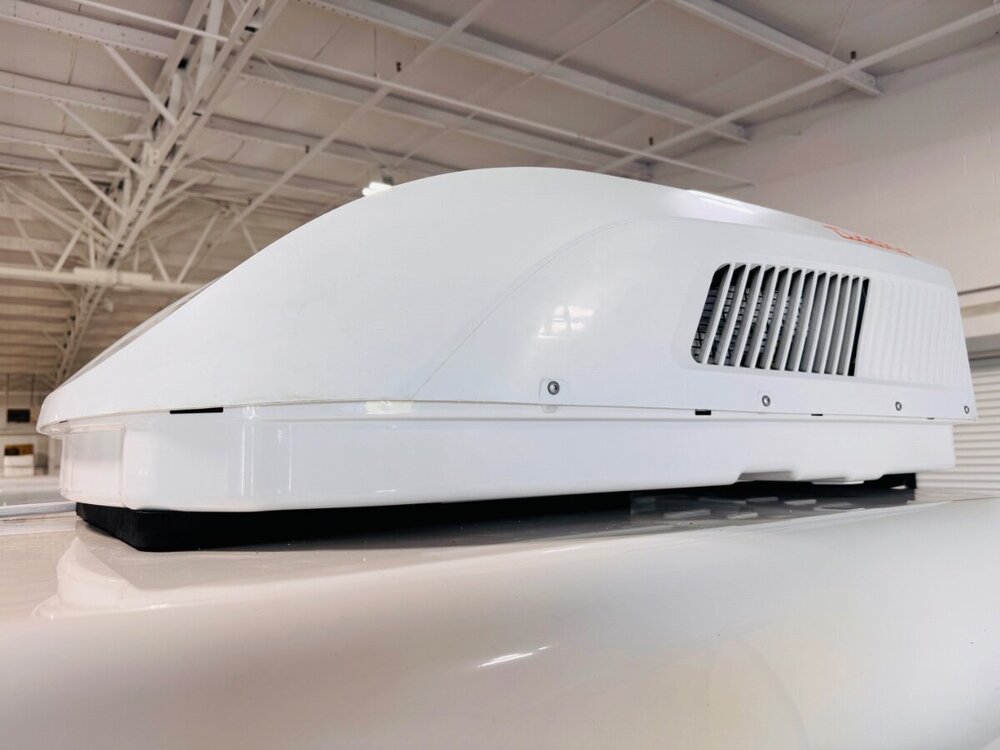

Ronbrink Posted September 16, 2024 Posted September 16, 2024 On 9/12/2024 at 3:45 PM, Ronbrink said: Currently targeting this coming Saturday Saturday’s install was a success! Soon I will post ‘Dreiha Atmos 4.4 Home Install’, but for now a few pics. BTW, sitting in the Oliver at home enjoying my morning coffee, Atmos whisper ‘cool’; I can actually hear myself thinking of things to come! 3 1 Ron and Brooxie | Clear Lake (Houston), Texas 2020 OLEll, Twin, 579: No installed solar, dual 30# propane tanks w/GasStop safety devices, Renogy 40A DC-DC charger, 460Ah LFP battery bank/Victron SmartShunt, auxiliary Cerbo-S GX/Victron 30A Blue Smart IP22 Charger combo, interior mounted Hughes Autoformer, twin independent sliding Lagun mount tables, extended dinette table and pantry landing, tongue-mounted hoist, Beech Lane refrigerator Ventilation/Evaporate Coil fans, metal valve stems with TST cap sensors and signal repeater, Waste Master sewer hose management system, Dreiha Atmos 4.4 A/C upgrade/Ceilo Breez Max thermostat, FlagpoleBuddy Starlink Mini suction mount kit. 2019 GMC Savana 2500 Cargo Work Van: Explorer Limited SE, Low-Top 7 Passenger van conversion, 6.0L V8 Vortec, 6-Speed Automatic, RWD; Air-Lift LoadLifter air suspension/WirelessAir compressor; Bilstein B6 4600 Series shocks; metal valve stems for TST tire pressure monitoring system; Buyers Products cargo containment boxes/DC Cargo securement system; rear bumper DC-DC Anderson power cable outlet; 100Ah 12V portable power station/Dometic CFX 75L Dual Zone cooler; front 2” receiver hitch/QuikrStuff Mach2 double bike rack; Mechman 320A high output alternator; Starlink Mini/Veritas Vans magnetic mount.
