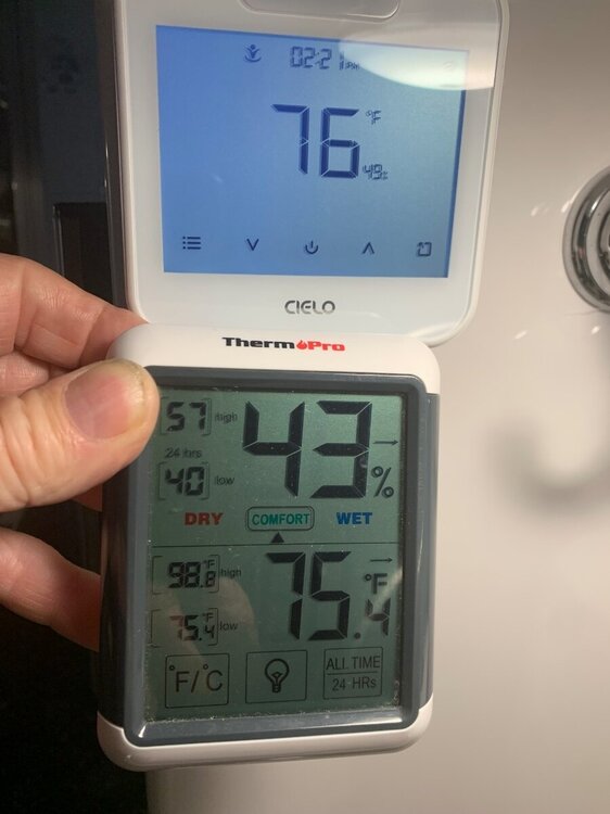

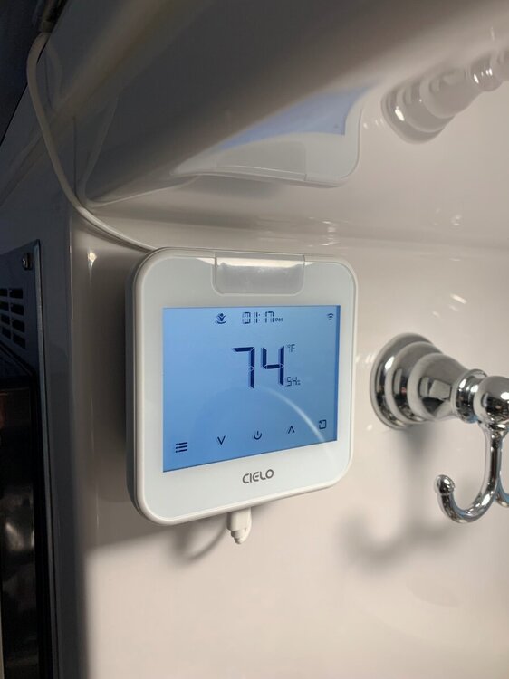

Your understanding is correct, with the Cielo’s Comfy Mode the supply air fan can either be made to turn off in sync with the compressor or to run a short time post compressor shutdown. As previously expressed, “This is HUGE” for the reasons discussed therein and more!
The Cielo can also be calibrated for both temp and humidity readings. Shown here with a slight variance in data points.

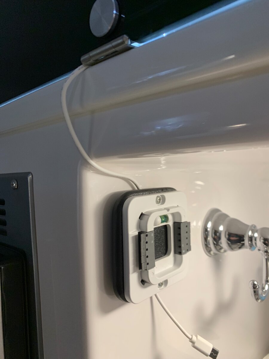

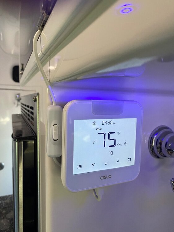

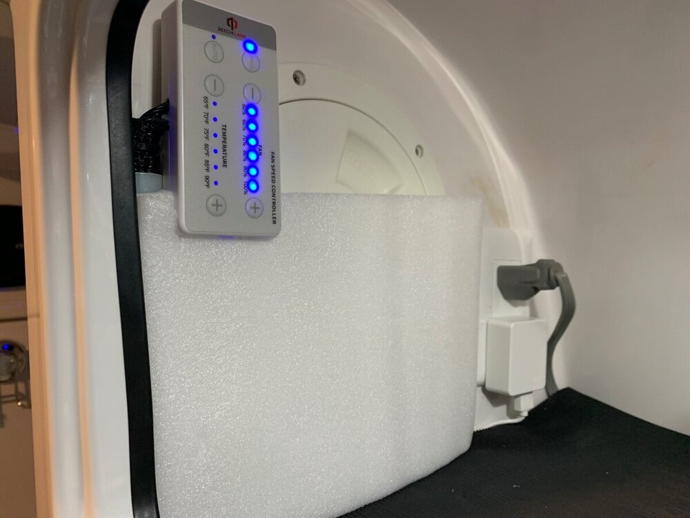

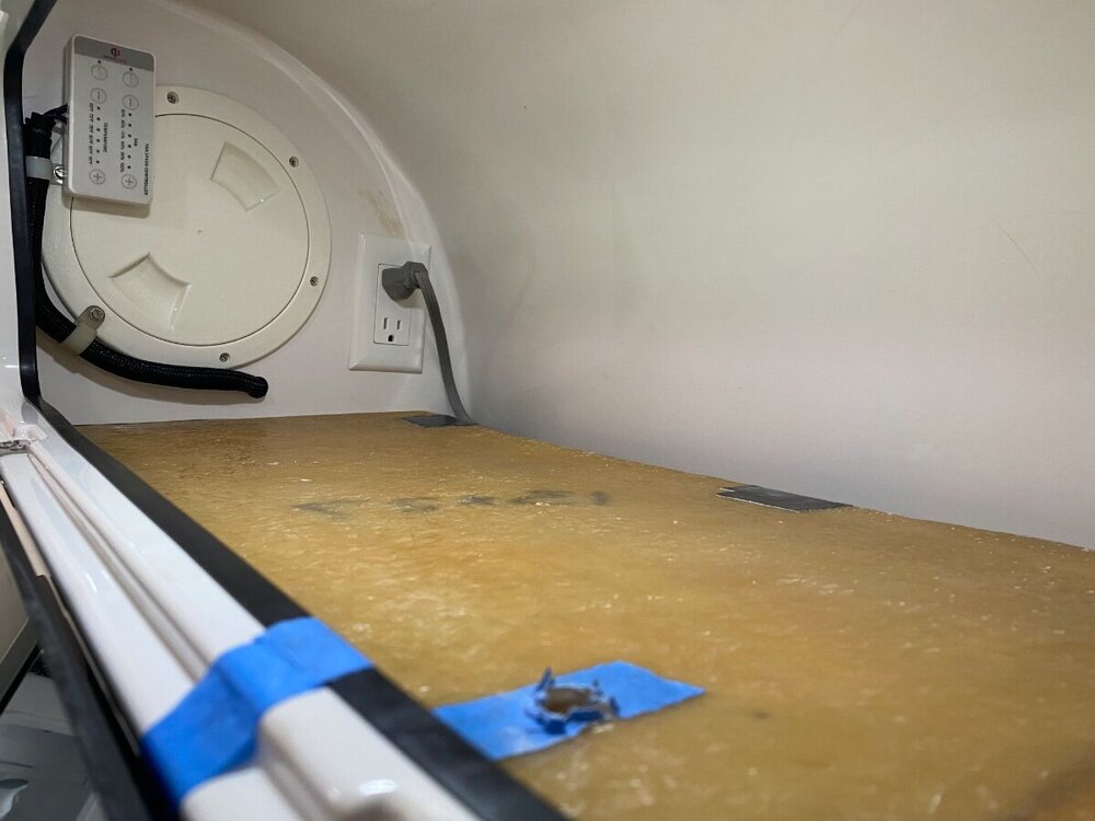

On 5/30/2025 at 6:15 AM, Ronbrink said:

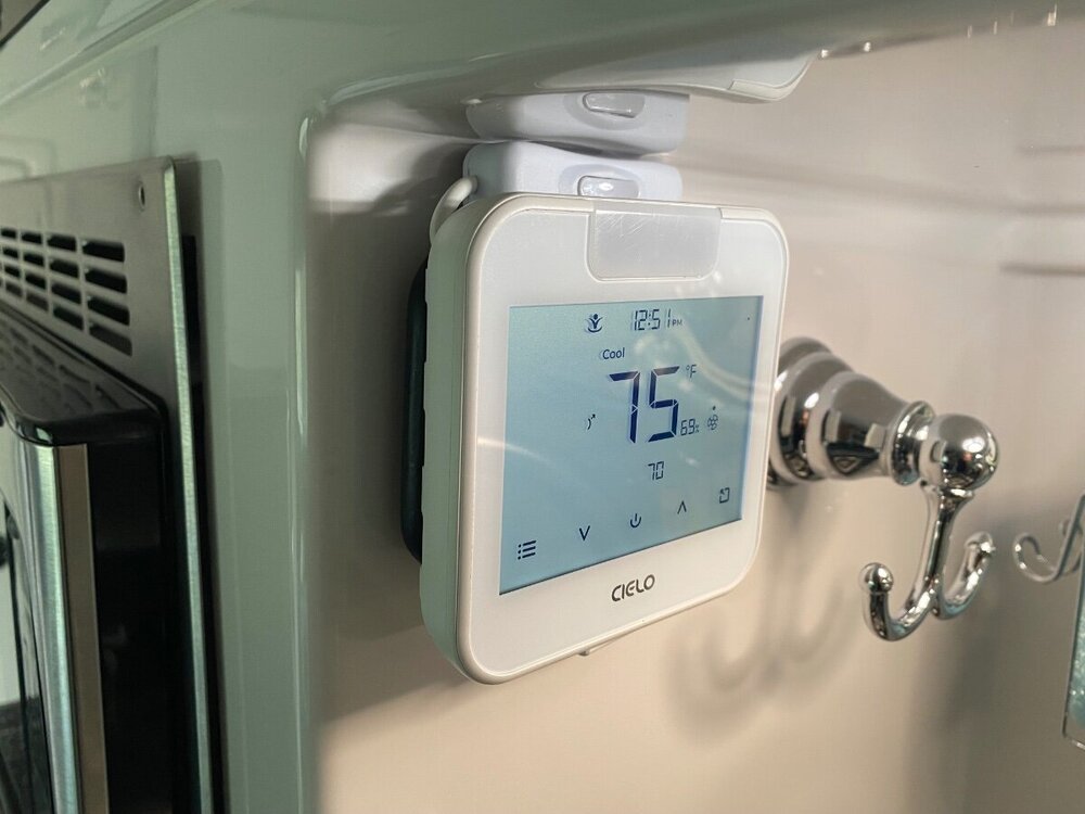

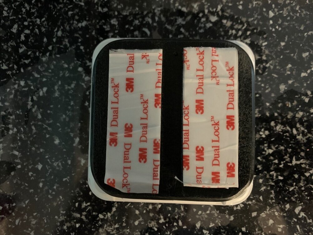

Finally I placed it as shown in the pic, whereby the cord runs in and out of the galley cabinet and plugs into said USB port. I used Velcro for the mount, and may eventually hardwire the Cielo through that upper cabinet and tap into the wiring within the access screw port for a cleaner installation.
I have made a couple of note worthy alterations since the above statement. The use of velcro was a great idea, but the Cielo’s wall plate lacked enough tangible surface area for adequate adherence and thus, an additional backing plate was needed. A square of StarBoard Marine HPDE was screwed to the Cielo’s wall plate and 3M Dual Lock used to affix to the fiberglass wall. Care was taken to ensure the Cielo could still be mounted on the supplied base stand, if ever the need.
The Dual Lock was positioned vertically to facilitate routing of the power cable between and behind the backing plate.
With the Cielo mounted, said cable was plugged in at its bottom and the other end routed into the above galley cabinet. Unlike the previous install the AC outlet, where the microwave plugs in, was utilized with use of a slim fit USB 5V adapter as the power source. The excess cable was then tucked in along the edge of the black cabinet liner. As installed, hardwiring is no longer in consideration.

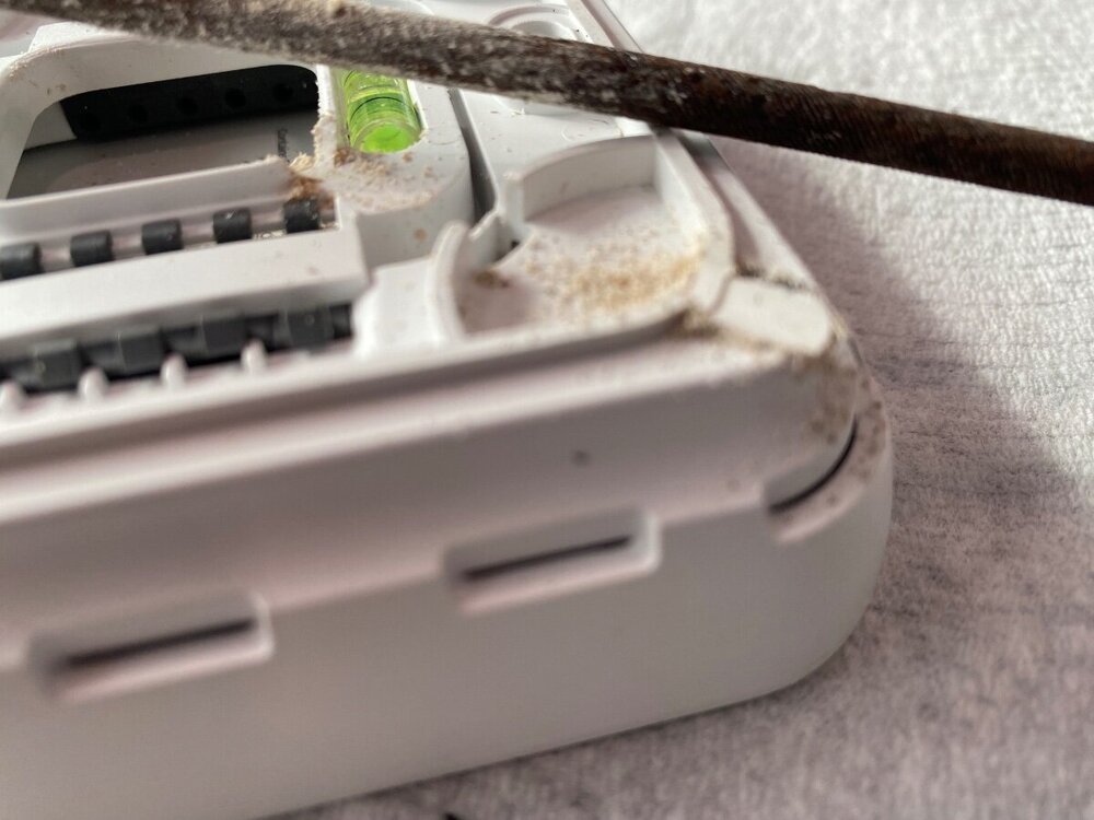

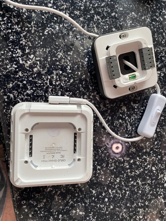

In my above July 3rd post I showed the Cielo’s temporary mount utilizing its stock USB Type C cord powered by an adapter at the receptacle outlet in the upper galley cabinet. I have since gained expertise through testing and actual field experiences, and now have even more confidence in the capability of this device. Other than the fact that featured modes can be programmed for both temperature and humidity comfort, preliminary findings indicate that advanced features are accessible in the absence of Wi-Fi, to which I have previously addressed. Learning by trial, being able to conveniently switch supply power off would benefit limited use of said features and thus, an aftermarket USB cord with inline switch was employed.
Proving successful in application, I then focused on a more permanent and aesthetic mount. Yes, holes were drilled and Cielo altered, here’s how I proceeded:
A file was used to create a furrow for the USB cord to pass through the Cielo’s base.
A 90° adapter was used to connect the switched power cord at the Cielo and then routed through the base components.

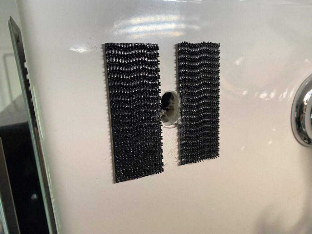

A hole was made at the mount point to pass the cord through the wall into a cavity next to the microwave.
A hole was drilled from the upper cabinet into said cavity.
A wire was used to fish a pull string into place.

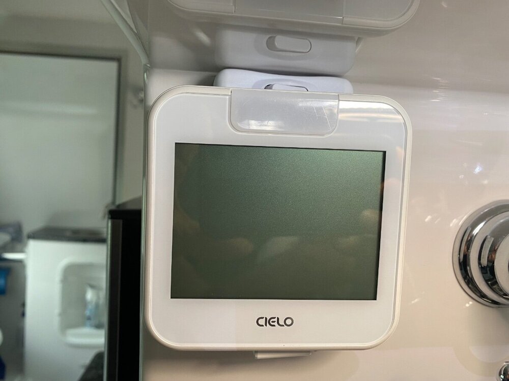

USB cord pulled into upper cabinet, routing to receptacle/adapter and cabinet mat reinstall not shown.
Cielo readied for mounting.
Installation complete.
I think it’s worth mentioning that the black backing plate added to facilitate the use of 3M Dual Lock for wall mounting is not a necessity. As installed, the Cielo can easily be mounted to the wall with supplied screws in conventional manner. I only resorted to the Dual Lock mount initially to enable easy movement when finding the best placement spot for the device, and may eventually remove it for a more streamlined mount and appearance. Regardless, I can now switch the Cielo on for use or off when the a/c’s remote is the preferred method of control.

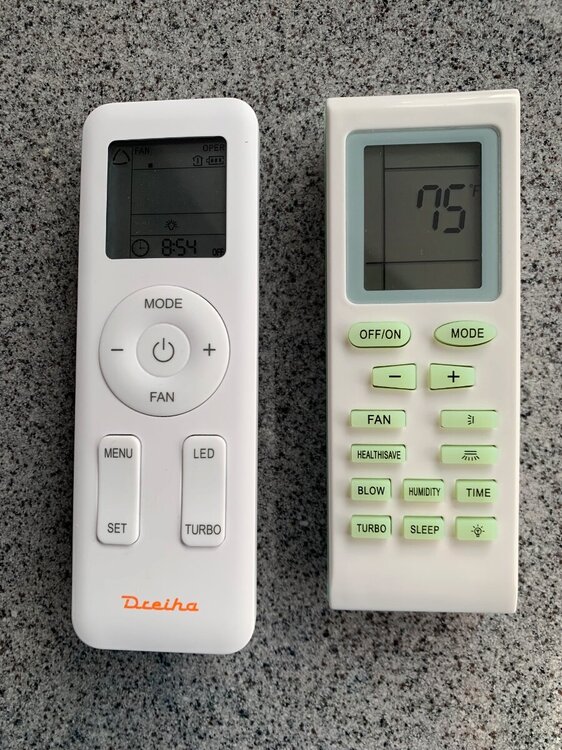

Following installation of the Atmos 4.4 last year, some may recall I replaced the stock Dreiha remote with a Gree aftermarket remote; primarily due to its backlight feature. Here is the pic posted October of last year:
Upon installation of the Cielo Breez Max, I immediately resorted back to using the Dreiha remote thinking it to be the only one compatible with the Atmos and said device. However, I was experiencing a programming issue regarding that remote’s timer, which was turning the air conditioner on unexpectedly. In toggling through the remote buttons I was inadvertently setting the timer, which became a hassle and very frustrating. Hence, I resorted back to the Gree remote and turns out it too is a listed compatible remote for the Cielo. I’m posting this for other owners with Gree branded air conditioners that may be experiencing a timer issue and affirm the Gree remote’s adequacy and compatibility regarding the Cielo.
