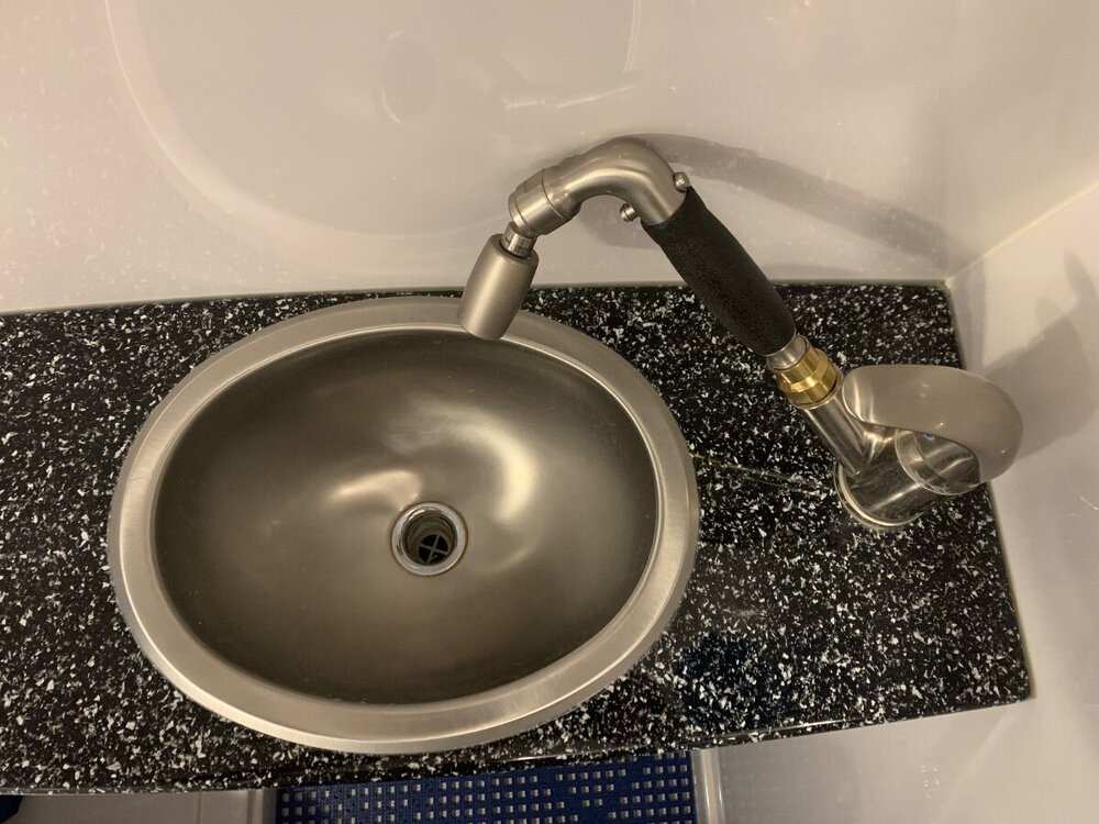

DunnYet Posted December 1, 2024 Posted December 1, 2024 (edited) So we upgraded Reset 2.0 (Hull #1634 '23 Model LE II) with the High Sierra Faucet. After receiving the adapter from High Sierra, we used the new faucet this weekend for the first time. Our experience was that the open aerator sent water all over the sink, putting the "wet" in wet bath. I'm sure that would make a great shower (short trip for Thanksgiving so not used as a shower this trip) but how do you keep it from soaking the sink when you are using it for hand washing or wetting the tooth brush. Even turning the water way down, it seems like more water goes horizontally than vertically. Edit: In all fairness it's more like a 45-degree conical pattern spreading out from the screenless aerator, but that hitting the sloping sides of the stainless-steel sink in the '23 model ends up getting the user and the sink pretty wet. All suggestions welcome, especially those that start with "You are doing it wrong..." 🙂 Edited December 1, 2024 by DunnYet Hyperbole is not good when describing a problem. Current: 2023 Oliver Elite II - Hull #1364 "Reset 2.0" (Second Owner) Tow Vehicle: 2023 Ford F-150 XLT 3.5L EcoBoost /w 3.55 axle and Max Tow Package "SIlver" Original: 2022 Oliver Elite I - Hull #1030 "Reset" (Sold) Original Tow Vehicle: 2022 Subaru Ascent "Blue Moose" Home Base: Duncanville, TX

DunnYet Posted December 1, 2024 Author Posted December 1, 2024 22 minutes ago, rich.dev said: I don’t have this faucet so I’m not familiar with its functionality. Are you saying 1) it’s leaking where the faucet screws into the hose, or 2) spraying horizontally out the end of the faucet? If #1 check the gasket. End of the faucet (your option #2) The faucet itself is great - I'm just not sure if the water dispersal pattern out of the end of the nozzle is "normal" (i.e. working as designed) or if I have something adjusted wrong. Edited my original post as horizontal is too strong - more like a 45 degree cone... Current: 2023 Oliver Elite II - Hull #1364 "Reset 2.0" (Second Owner) Tow Vehicle: 2023 Ford F-150 XLT 3.5L EcoBoost /w 3.55 axle and Max Tow Package "SIlver" Original: 2022 Oliver Elite I - Hull #1030 "Reset" (Sold) Original Tow Vehicle: 2022 Subaru Ascent "Blue Moose" Home Base: Duncanville, TX
Moderators SeaDawg Posted December 2, 2024 Moderators Posted December 2, 2024 Have you tried reducing the flow with the button on the handle? The "triple valve" ? 2008 Ram 1500 4 × 4 2008 Oliver Elite, Hull #12 Florida and Western North Carolina, or wherever the truck goes.... 400 watts solar. DC compressor fridge. No inverter. 2 x 105 ah agm batteries . Life is good.
dewdev Posted December 2, 2024 Posted December 2, 2024 I was looking at the High Sierra Faucet web site and it showed the flow to all be downward and not to the side. I suggest that you contact the manufacturer and tell them of your problem. The faucet may be defective. 1 2018 Oliver Elite II, Twin Bed, Hull #354, new Lithonics batteries and Xantrex Freedom XC 3000 Pro Inverter in 2025 2024 RAM 1500, 4 x 4; Gas. 5.7L V8 Hemi MDS VVT Torque; 3.21 rear axle ratio w/TIMBREN spring rear suspension addition Maine
Ronbrink Posted December 2, 2024 Posted December 2, 2024 19 hours ago, DunnYet said: how do you keep it from soaking the sink when you are using it for hand washing or wetting the tooth brush. You can adjust the water flow with the trickle feature button. I leave mine set for a low flow (low pressure stream) when being used as a sink faucet as a water saving measure, thereby reducing amount going to gray tank, as well. Also, the handle is positioned against the wall and spout angled toward the drain for optimum use. 2 Ron and Brooxie | Clear Lake (Houston), Texas 2020 OLEll, Twin, 579: No installed solar, dual 30# propane tanks w/GasStop safety devices, Renogy 40A DC-DC charger, 460Ah LFP battery bank/Victron SmartShunt, auxiliary Cerbo-S GX/Victron 30A Blue Smart IP22 Charger combo, interior mounted Hughes Autoformer, twin independent sliding Lagun mount tables, extended dinette table and pantry landing, tongue-mounted hoist, Beech Lane refrigerator Ventilation/Evaporate Coil fans, metal valve stems with TST cap sensors and signal repeater, Waste Master sewer hose management system, Dreiha Atmos 4.4 A/C upgrade/Ceilo Breez Max thermostat, FlagpoleBuddy Starlink Mini suction mount kit. 2019 GMC Savana 2500 Cargo Work Van: Explorer Limited SE, Low-Top 7 Passenger van conversion, 6.0L V8 Vortec, 6-Speed Automatic, RWD; Air-Lift LoadLifter air suspension/WirelessAir compressor; Bilstein B6 4600 Series shocks; metal valve stems for TST tire pressure monitoring system; Buyers Products cargo containment boxes/DC Cargo securement system; rear bumper DC-DC Anderson power cable outlet; 100Ah 12V portable power station/Dometic CFX 75L Dual Zone cooler; front 2” receiver hitch/QuikrStuff Mach2 double bike rack; Mechman 320A high output alternator; Starlink Mini/Veritas Vans magnetic mount.
