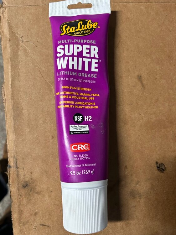

I considered the CV-2 grease but chose to stay with white lithium. The real issue was in trying to remove the motor head to grease the drive pin as per OTT. The 3 set screws were impossible to remove. That is the only way the second yearly maintenance procedure can be performed.

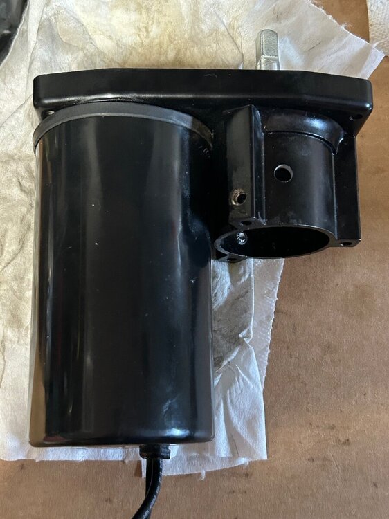

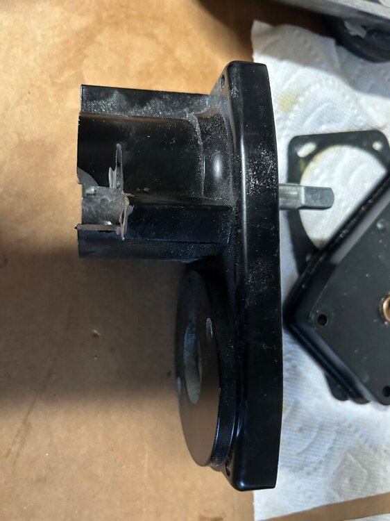

As dmtaylor 2 reported, removal of the three set screws can be difficult.  If you find this to be the case, consider getting and using an impact tool.  Many old motorcycle mechanics still have and use one of these:
But even just mildly impacting the case with a Hand Impact tool can cause this:
So I recommend using one of these:
To get all three screws out, you'll likely need to remove the jack to frame mounting bolts.  And that is a PITA for the two rear jacks.  But that is far better than this:

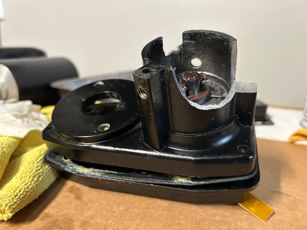

Wow, I cannot even imagine these Allen screws being so tight as to break the pot-metal housing! One looks broken off from excessive torque and the other was grinded off? OMG, from excessive rust? Tried soaking overnight with PB Blaster or something? Mine came out, all 3 screws, in 1-2 minutes without issue, using only a 4" hand-held Allen key. You'd need a long extension or cheater bar to break metal like this.
In the future, if anybody else finds these Allen screws to be difficult, do not use too much torque to break the casing, do not grind the casing. First use a penetrant and patiently wait 24 hours or more. Worse case should be drilling out the stuck screws. Then you could tap the three holes and find oversized Allen screws or short bolts.

For those questioning the casing "broken" like the pictures show, it was intentional! IF the set screws are seized, there is no other option. I was merely showing how I was able to remove. Thanks
