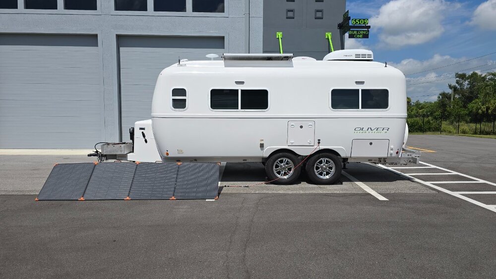

Ordered the ZoupW 450 Watt Solar Suitcase and a Victron 100/20 Bluetooth MPPT. The Zamp Outlet has a fuse under the Streetside Bed. It was not Installed. Waiting to recieve the Suitcase to see how long to order the cables with reverse zamp connector.

The Oliver Elite II units with Solar Options have an external Zamp Connector on the side of the trailer which is connected through a 20A fuse to the trailer batteries.
That Zamp Port doesn't connect to the onboard Zamp Controller, so you need a second controller for external panels that are to connect to the Oliver trailer.

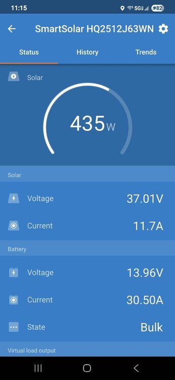

The highest number I ever got was a reading of 367W for a few minutes! Was I limited by the 30A SC or will a 400W panel actually get greater than 90% the advertised number in real world usage? Let us know if you get 450W readings with your new setup.
To get this number the panels were lined up to the angle of the sun as close as possible. Then a cloud comes by and it’s reading 220W. Later the alignment was off and it’s reading 260W.
Given ONLY near perfect alignment and dry sunny Arizona sky will get over 300W, the 30A SC is enough. Could be enough for a 450W panel too but the 50A would produce more in perfect conditions.

We don't have enough rooftop on an Elite to oversize a system, so some of us need and want portable systems when we are camped for a period of time, for the additional charging capability without having to set up a generator. Everyone has a different camping style and different needs.

I changed the Max Charging Amps to 24 Amps from 50 Amps on the Victron 100/50 MPPT. The #10 wires were getting warm going to the battery. These Panels put out a LOT of power but the good thing is even in very cloudy weather they still stay near 100 watts and with any sunshine get near 300 Watts. They easily out produce the OTT Roof Mount Panels I have which I believe are 340 Watts.
