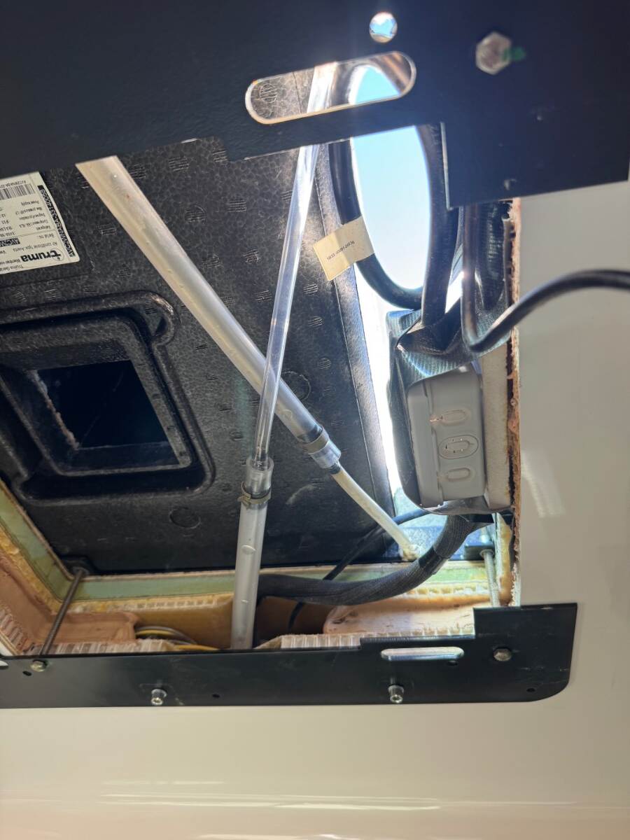

Rolind Posted July 23, 2025 Posted July 23, 2025 Has anyone with the truma had any luck getting the condensate to consistently drain through the drain tube and not down the side of the trailer? It has always been intermittent for me and lately has stopped altogether. Yesterday I took the evaporator cover off and gently blew air up the drainage tubes. The curbside easily accepted air from below but wouldn’t drain water from above. The street side was occluded from below and won’t accept any air, but drained freely from above. I thought I would ask before I just set aside my OCD and accepted condensate drainage on the side of the trailer. Thanks in advance for any suggestions. Robert and Cheryl, Louisville, KY, Legacy Elite II Hull #1390 Oliphino, TV F250 Tremor

Patriot Posted July 23, 2025 Posted July 23, 2025 (edited) We have never had an issue with water running off on our roof from the either of the (2) condensate cups in the unit. We had our “Demonic” Penguin removed and retro fit with the Truma Aventa in May of 2023. At the time of the retrofit, I spoke to the tech doing the install about over flow on the roof possibly occurring. He said that its really important to have the trailer dead level when your set up and running the Truma. The condensate cups are not very deep and can fill quickly, and the drain tube handles this under normal operation. ✅ I learned that it’s really important that the (2) Truma condensate tubes do not have a kink in them. This will result in the cup(s) not draining properly into the OEM condensate drain lines. I think this may have possibly been an install concern early on. This would cause the condensate cup(s) to over flow onto the roof. The tech mentioned that he would make sure that the tube would be installed kink free. It works as designed and I have never had condensate water dripping off my roof. I am not suggesting that anyone here is not setting up their trailer dead level. But in order for the 2 small condensate cups to drain properly this is how it’s designed. If you are set up dead level and you still see water dripping off your roof, you may have a kink in one of the condensate drain hoses or maybe it’s just plugged up. Edited July 27, 2025 by Patriot 1 3 2020 OLEII - Hull #634 aka- “XPLOR” TV 2021 F350 6.7 liter Diesel Lariat Ultimate Tremor aka - “Beast of Burden” Truma Aventa 13.5 AC, Alcan 5 leaf pack, Alcan HD shackles & HD wet bolts, 5200lb never lube axles.XPEL 10 mil PPF front both front corners, 30 lb LP tanks, Sea Biscuit Front Cargo Storage box. ⚡️⚡️11/2025- Lithium upgrade to XPLOR - (2) Epoch 300ah Lithium batteries, Victron 3000W MultiPlus-II, Victron GX Touch 70, Victron Cerbo GX, Victron Smart Solar MPPT, Victron Smart Shunt, Victron Orion XS 1400 DC-DC charger, RV Soft Start. Zamp 90W suit case solar panel for 420W of solar.⚡️⚡️ North Carolina
Rolind Posted July 25, 2025 Author Posted July 25, 2025 On 7/23/2025 at 4:35 PM, johnwen said: Was that very difficult? Not really. You need to peel the sealant off the eight screw heads. I assume it was dicor. Once those are off the shroud can be lifted off. There are two more screws holding the evaporator cover on. Once those are removed the evaporator cover can be removed. All screws are T25s To be honest once you are in there, there isn’t much to see. One thing I did learn is that the street side drain at the evaporator connects to the curbside drain under the back of the trailer and same with the other side. I had always assumed, street side evaporator drained to the under the trailer street side drain. I also learned my unit is slightly off level with street side being lower when the trailer is level. Of course that is the drain tube that is occluded. be sure to seal up the shroud screws when you put it all back together. 1 1 Robert and Cheryl, Louisville, KY, Legacy Elite II Hull #1390 Oliphino, TV F250 Tremor
Rolind Posted July 25, 2025 Author Posted July 25, 2025 On 7/23/2025 at 5:41 PM, Patriot said: We have never had an issue with water running off on our roof from the either of the (2) condensate cups in the unit. We had our “Demonic” Penguin removed and retro fit with the Truma Aventa in May of 2023. At the time of the retrofit, I spoke to the tech doing the install about over flow on the roof possibly occurring. He said that its really important to have the trailer dead level when your set up and running the Truma. The condensate cups are not very deep and can fill quickly, and the drain tube handles this under normal operation. ✅ I learned that it’s really important that the (2) Truma condensate tubes do not have a kink in them. This will result in the cup(s) not draining properly into the OEM condensate drain lines. I think this may have possibly been an install concern early on. This would cause the condensate cup(s) to over flow onto the roof. The tech mentioned that he would make sure that the tube would be installed kink free. It works as designed. I am not suggesting that anyone here is not setting up their trailer dead level. But in order for the 2 small condensate cups to drain properly this is how it’s designed. If you are set up dead level and you still see water dripping off your roof, you may have a kink in one of the condensate drain hoses or maybe it’s just plugged up. Thanks for the input. Your post got me thinking and today I’m going to check behind the wall in the basement and see if I can see any kinks. Btw are you going on the Tremor forum truck plant tour in August? It would be great to meet you. 1 Robert and Cheryl, Louisville, KY, Legacy Elite II Hull #1390 Oliphino, TV F250 Tremor

Rolind Posted July 25, 2025 Author Posted July 25, 2025 So despite my pledge to suppress my OCD tendencies, I spent some more time with my condensate hoses today. The hose is not kinked behind the basement wall and I cannot see an obvious kink when I examine the hose under the evaporator. There is very limited access to the condensate hoses from the roof. At this point, I’m going to really quit and live with condensate on the side of the trailer. If I were to pursue things further, I think the next step would be to lift the ac unit off the roof and gain better access to the drain tubes. This is more than I am willing to do. Robert and Cheryl, Louisville, KY, Legacy Elite II Hull #1390 Oliphino, TV F250 Tremor
Geronimo John Posted December 24, 2025 Posted December 24, 2025 On 7/25/2025 at 12:53 PM, Rolind said: If I were to pursue things further, I think the next step would be to lift the ac unit off the roof and gain better access to the drain tubes. This is more than I am willing to do. I'm not a Truma guy, so this is just a suggestion to consider. Removing the faceplate inside the cabin one can see a lot of the drain guts. Kinks there would certainly show up as water leaking somewhere. For most A/C systems it requires the removal of four screws inside the cabin. May be worth a try. TRUMA GUYS? Please verify is this is applicable to your units. TV: 2019 F-150 SuperCrew Lariat, 3.5L EcoBoost, 10 Speed Trans, Max Tow, FX-4, Rear Locker OLLIE: 2018 OE2 Hull 342, Twin Bed. OLLIE DIY’s: Timken Bearings, BB LiFePO4's, Victron 712 Smart, 350 Amp Master Switch, Houghton 3400, Victron Orion DC - DC, 3000-Watt Renogy Inverter, P.D. 60-amp Converter, Frig Dual Exhaust Fans, Kitchen Drawer Straps. Front Wardrobe Shelves, Snuggle Shelf. TV DIY’s: 2 5/16" Anderson System, Nitto recon’s, Firestone Rear Air Bags, Bilstein 5100’s, Mud Flaps & Weather Tech all, installed Ham Radio (WH6JPR).
Rolind Posted December 25, 2025 Author Posted December 25, 2025 Hmm sounds like a good plan. Despite my earlier admonishment that I was swearing off any further attempts at a solution, I did purchase a very long cleaning brush used to clean out sunroof drains and was going to take another run at this drain issue in Feb when we are in the keys. I will keep you informed. 1 1 Robert and Cheryl, Louisville, KY, Legacy Elite II Hull #1390 Oliphino, TV F250 Tremor
