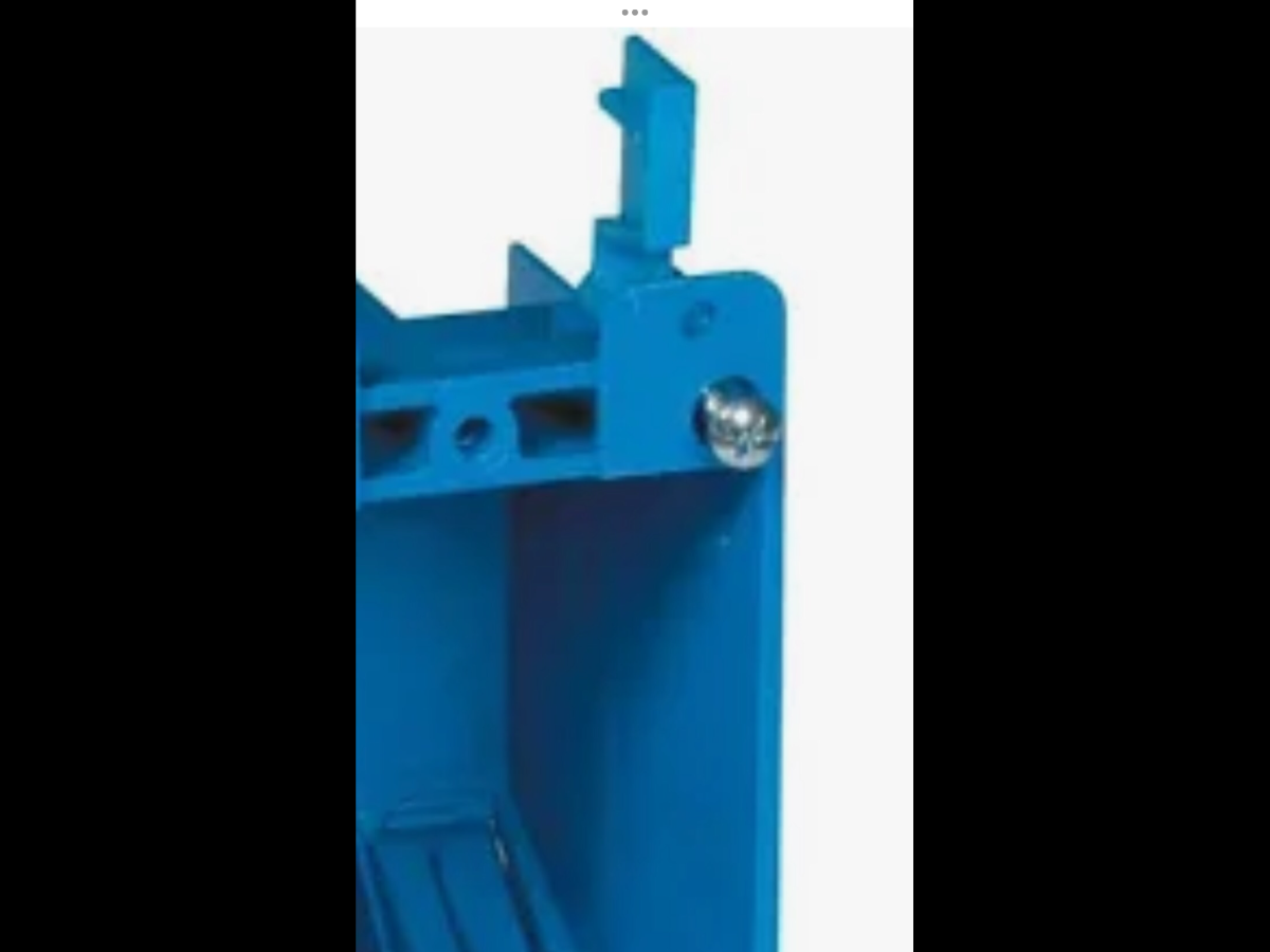

There should be a wing on that mounting screw, looks like it broke off.

Yep, it could be broken or folded back and the should be two of them. They are designed to spread out to hold when tightening the mounting screws.
If broken, it’s a $2 HW store part. You would need to rewire the outlet replacing the box. First open the “outlet” breaker or the main 30A breaker in your 120VAC power panel.

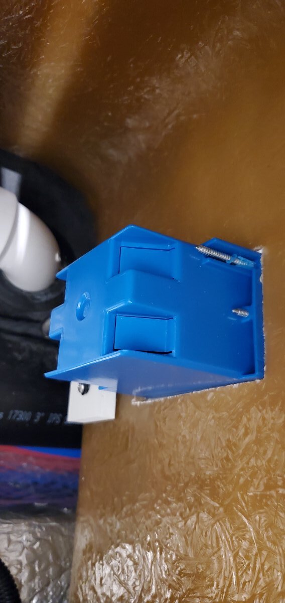

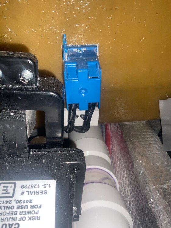

Oliver forgot to put the backer on ours. It was very loose. They sent me a new box under warranty, and I removed the plate and installed on the existing outlet.
There is a simpler fix. One could just back out the mounting screw and thread on the ‘wing’ taken off a new box and thus, no rewiring of the fixture! As you duly noted, these plastic boxes are cheap; they are also easy to install, but care should be taken to not over tighten the mounting screws which can result in the breakage observed.

Exactly. I had no interest in rewiring. Still have the box with other items in the event one needs to be replaced.
