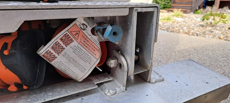

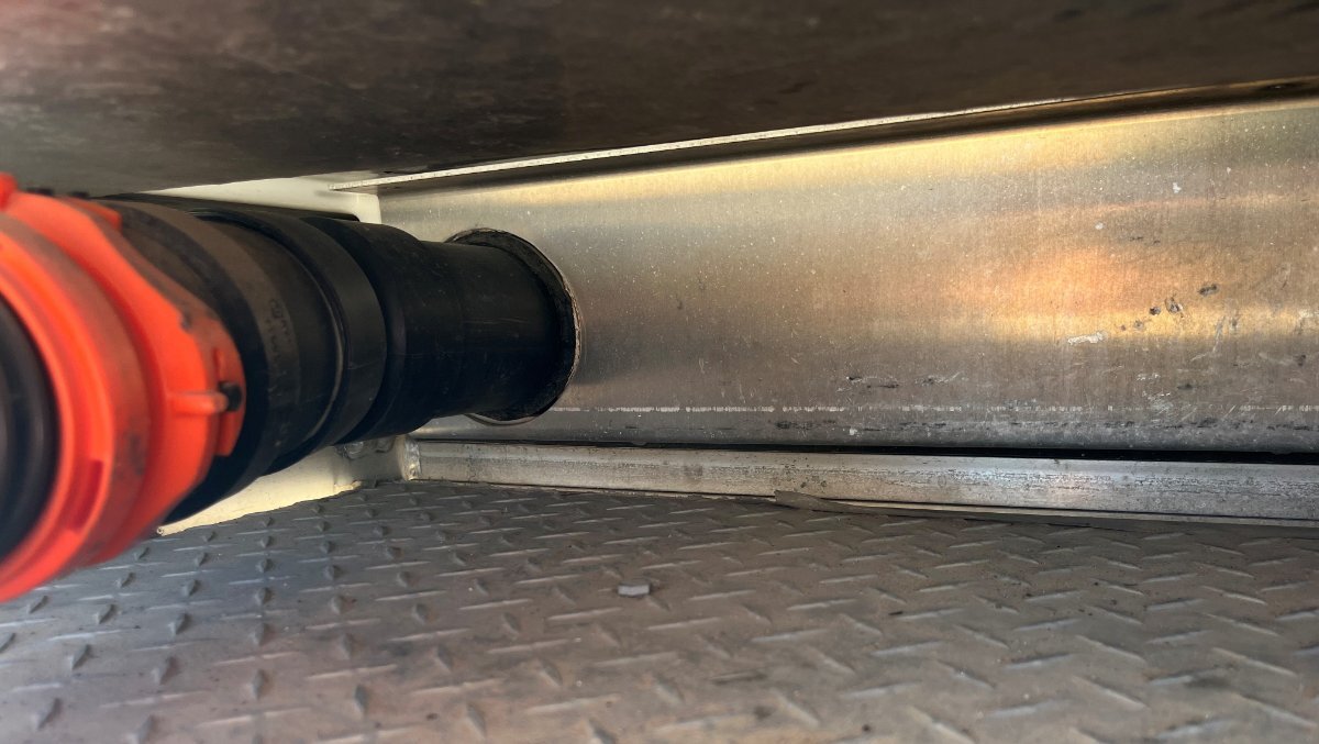

I was curious and just took a look at our Oliver (pic1). No wires, no buckles, and I'm happy to see it's cleaner inside than out! 🤣 (I'm having a guy clean and polish the outside soon!)
Prior owner must have had some poop macerator pump wired in there, yuck! And who knows why they needed two cables and drilled two holes. Everybody should think of any alternative so not to drill into these hulls!

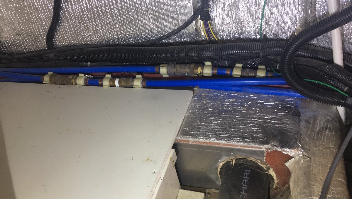

First thing i would do is to remove both wiring harnesses, then plug up the holes with plastic plugs or butyl. Go inside your lower rear opening, I call it the Oliver trunk! Take a look where the waste drain pump comes in and the wiring harness will be right there (just to the left of the pipe shown in pic2).
I would also get rid of the waste line extension, buckled onto your waste drain, to make room. We keep our RhinoFLEX hose always connected there, so not to crane my neck and sprain my wrist every time we're at the dump station. It's so easy just to pull the length of hose out. We keep a clear elbow fitting on the other end, so everything is ready, always connected.
