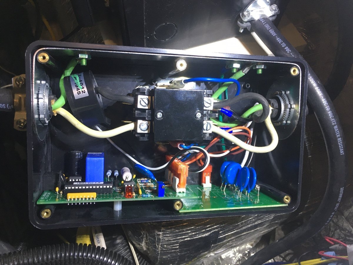

jd1923 Posted November 5 Posted November 5 (edited) 2 hours ago, CRM said: More than a few people have had issues with the ground and neutral connections inside the EMS itself. That's the first place I'd check. Agreed, E2 means no ground connection. Given you are certain shore power has proper ground (be sure) then it would be within the PI EMS. Make sure ALL 6 connections (3 in, 3 out) are clean and tight. The 4 you see quickly in the picture are the hot and neutral connections. Then look closely at the green wires which are bolted to the case of the EMS (inside top of the case in picture). I can see that one of these could get loose easily. Edited November 5 by jd1923 5 Chris & John in Prescott, AZ | 2016 EII #113 | '01 Ram 2500 Cummins!
