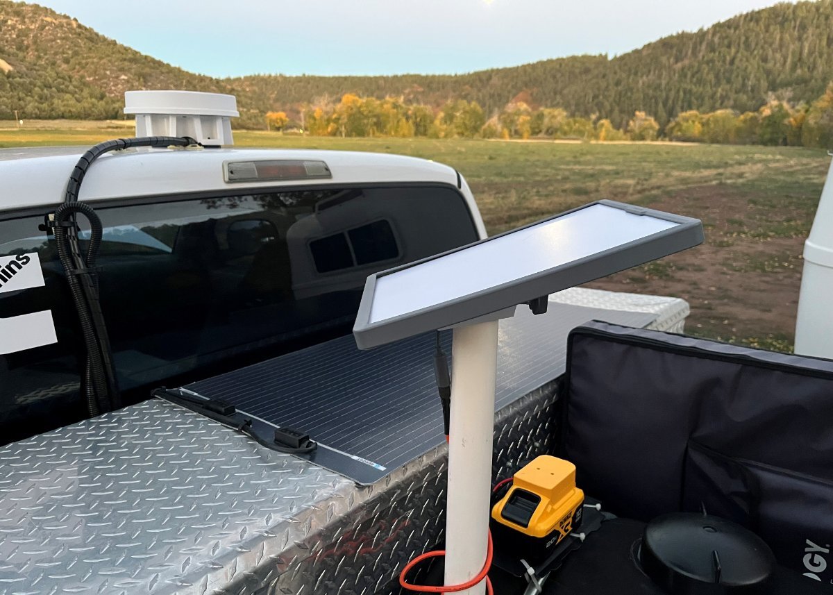

jd1923 Posted November 7, 2025 Posted November 7, 2025 My goal for a Starlink installation is something neat and simple! What I don't want and will not have! 1) A cord-powered ONLY solution, not in the day of LI batteries! 2) Suction cups on the side of our hull or windows (Chris keeps our windows clean regularly and suction cups leave stains on glass and fiberglass)! 3) Any kind of tripod or camera stand! 4) Something long like a flagpole (anything needing a ladder)! Starlink satillites are 100 +/- miles away and a 10-20' pole doesn't get you any closer! 5) OMG, please NOT sitting on a campground picnic table (they put these in the shade on purpose)! 🤣 On another thread, I showed my truck mounted solution, and in less than 24 hours, one or more Forum Members poo-pooed my installation claiming the dish must always be moved. I truly like this mount (pics 1-2). Last time out it worked every night on the road on a short trip. I truly believe it will work 2 of 3 nights on the road regularly (1 of 3 nights where the TV is in the trees regardless of where parked in the campsite). I have power and Ethernet wired to this location, so that the Starlink can be a WAN input on our Pepwave router. However, the battery solution works anywhere. Chris & John in Prescott, AZ | 2016 EII #113 | '01 Ram 2500 Cummins!

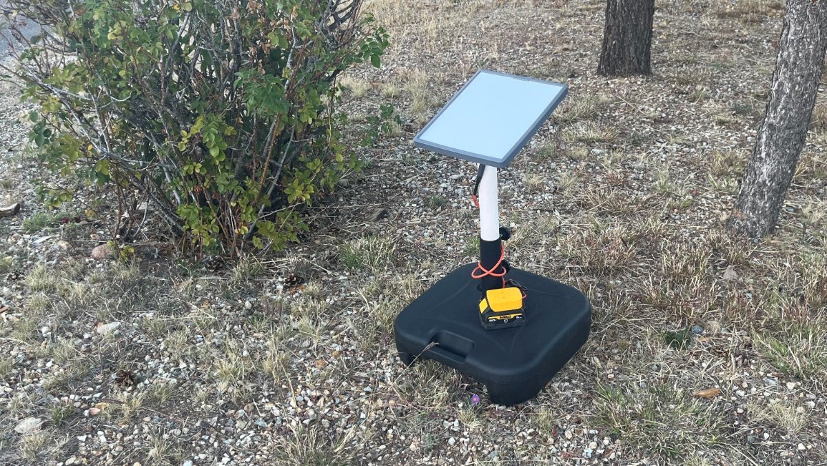

jd1923 Posted November 7, 2025 Author Posted November 7, 2025 Given this is our main mount, nicely sitting in our truck bed, I was thinking of a moveable stand for the occasions where the truck cannot be parked clear of trees! Meanwhile, my son broke the base to a fan he uses often in his apartment. After removing the broken base, I thought, "a patio umbrella stand would work nicely." So why not use an umbrella stand for the Starlink Mini dish? The kind you fill with water would be convenient, since when empty it weighs less than a pound (we always carry 35 gallons extra water on the TV). It works great and can be placed anywhere! I purchased this model from Lowes, since it is rectangular (most are round) and it has a nice handle. https://www.lowes.com/pd/Patio-Premier-Patio-Premier-Square-Blow-Mold-Umbrella-Base-Black/1002629278 You can configure all the fancy poles and mounts you want and I'm done with $50 total in parts ($10 for PVC parts) which will work anywhere without cables. 😎 3 Chris & John in Prescott, AZ | 2016 EII #113 | '01 Ram 2500 Cummins!

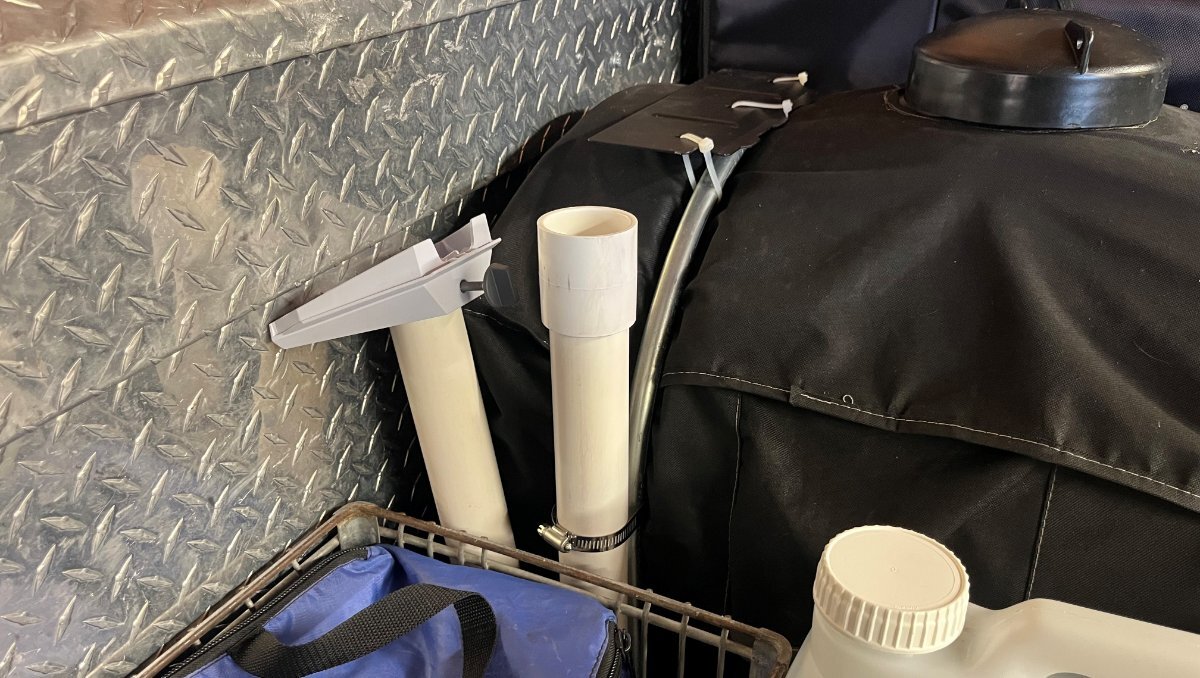

jd1923 Posted November 7, 2025 Author Posted November 7, 2025 BTW, Starlink includes the the pole mount attachment which fits the 1 1/2" ID PVC pipe, about 2" OD. You will need a Starlink power cord and a connector to your battery of choice. Any battery from 12VDC to 30VDC will work. We already had MANY DeWalt 20V batteries for my power tools, so it made sense to use these. https://www.amazon.com/dp/B0DSV45LHQ?ref=fed_asin_title https://www.amazon.com/Pigtails-Connector-Adapter-Security-Surveillance/dp/B0C5DXTD43/ https://www.amazon.com/Compatible-Conversion-Projects-Connector-Terminal/dp/B0FM2XYRKW/ Chris & John in Prescott, AZ | 2016 EII #113 | '01 Ram 2500 Cummins!

Moderators topgun2 Posted November 7, 2025 Moderators Posted November 7, 2025 10 hours ago, jd1923 said: On another thread, I showed my truck mounted solution, and in less than 24 hours, one or more Forum Members poo-pooed my installation claiming the dish must always be moved. So - I'm confused - are you saying that, indeed, there are times that the dish works better if it is moved? 😇 Bill 1 2023 Ford F150 Lariat 3.5EB FX4 Max Towing, Max Payload, 2016 Oliver Elite II - Hull #117 "Twist" Near Asheville, NC
jd1923 Posted November 7, 2025 Author Posted November 7, 2025 (edited) 2 hours ago, topgun2 said: So - I'm confused - are you saying that, indeed, there are times that the dish works better if it is moved? 😇 Bill Must only be moved to get a clear view of the Northern sky. My claim is 2/3rds of the time mounted to my truck works great with clear view (and only $10 in 1 1/2" PVC parts). The other times, I'll use this umbrella stand (another $30) with the SAME pole-mount which makes setup sooooo easy! 🤣 Tripods are generally made for cameras with a 1/4" screw attachment. They are fully adjustable which takes fuss to get lined up on both angles required. My setup uses the supplied pole-mount plate from Starlink at the correct angle to the horizon, so all you need is a 2" pole perpendicular to the horizon. It spins easily with one hand (no screws, no clamps), to get the correct angle in seconds. Just my opinion. Others want the long-pole setups and some are OK with laying the dish on the ground or picnic table. I was laying it in my truck bed prior to creating these mounts. Tripods, tall masts and suction cups are fine, but this is much easier for me! 😎 Edited November 7, 2025 by jd1923 1 Chris & John in Prescott, AZ | 2016 EII #113 | '01 Ram 2500 Cummins!
