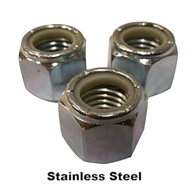

Replace the free running nuts with nylock (self-locking) ones and call it good. You might have to put new ones on after a few years if you adjust them often, since their self locking action will weaken as the nylon insert wears, so buy an extra pair and throw them in your spares kit. Any nut and bolt supplier or a commercial supply company like McMasters will have nylock nuts. Maybe even Amazon. Install them with a light coating of anti-seize if you use stainless steel, since it can gall (seize) if run down too quickly.
Anderson nut
Nylock nut

While John's Nylock solution would probably help, I'm not so sure that it is as simple as it seems.  In the short period of time that I've had Twist, I have had the Andersen chains on and off the camper at least 10 to 15 times.  Most of this is for storage, but on at least two occasions I've had to take a chain off in order to get the "whale tail" back on the hitch.  This job is easier with a regular "free running" nut as opposed to Nylocks.
Also, I'm a bit confused with John's comment about turning around the bolt.  Unless I'm missing something here, one can not turn around the bolt because of the chain link that is welded to the other end.  And, at least with the Oliver, the propane tank shroud pretty much protects one from "opening up one's shin" on those exposed bolt threads.

If a nylock nut seems too slow to manipulate you could always get a socket adapter and use a good (18 volt or more) battery powered driver drill. It seems to me from reading articles online that the hitch can be removed or installed without screwing around with the nuts. Am I misunderstanding this?
