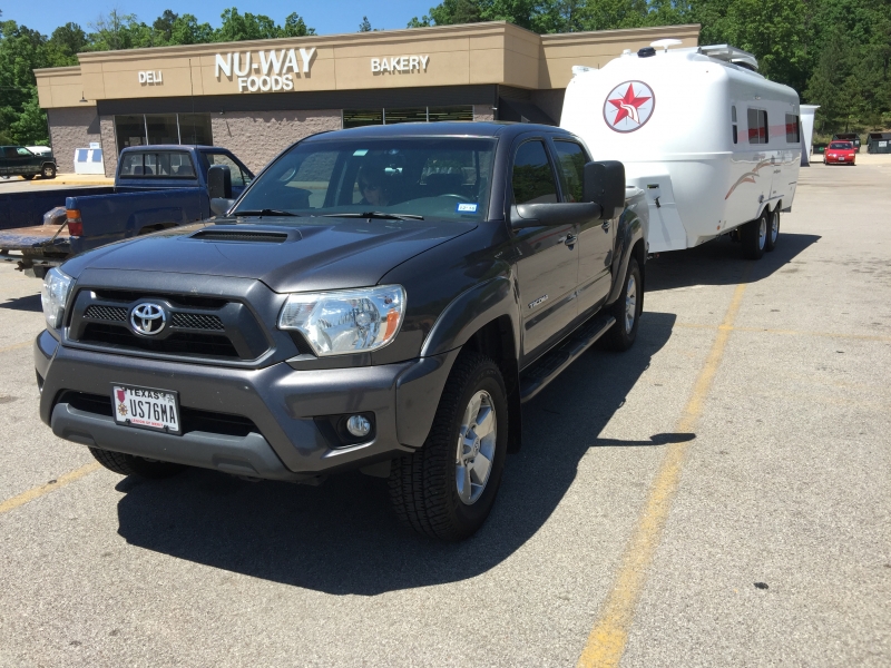

I have owned two Tacoma's, a 2009 and 2012.  We picked up our Oliver with the 2012 Tacoma.  It did an adequate job of towing, we put 4K+ miles on our Tacoma towing our Elite II.  Hills in the Ozarks, freeways, and backroads - no real towing issues.  I don't tow fast (60-62mph) and am generally pretty cautious.
When I went over 100K miles we decided to go with a bigger replacement, our current Ram 1500.  Going in, our main reasons for going bigger was to get a bigger fuel tank and a bigger truck bed.  With the Tacoma, I was constantly looking to refuel due to the small gas tank.  I also didn't want to always be "full to the brim" cargo wise when we traveled.

We tow our Ollie with empty water tanks ready to camp coming in around 4950 pounds with about 450 pound tongue weight. The Ollie has great towing manners, too.
We picked up our used Ollie in MO, the previous Ollie owner had towed the Ollie 6,000 miles with a 4.0L Tacoma between New England, FL, and MO. He had Timbren rubber block rear suspension installed on his Tacoma to reduce sag.  We towed the Ollie home with a 4.0L Nissan Frontier Crew-cab 6300 pound tow capacity, we were amazed how well the Frontier handled the Ollie and fuel economy in the NC & TN mountains, over 15MPG. Even had an emergency stop when a vehicle pulled out in front of us in the TN mountains with the rig stopping easily.
Eventually traded our Fronty in for a 2016 5.7L Tundra. The Tundra tows the Ollie easily with fuel economy of 13.5MPG with cruise control off in the NC/TN mountains. We purchased the Tundra as our Ollie's TV for now, the Tundra's tow capacity is close to 10,000 pounds. The 38 gallon Tundra fuel tank is very nice to have, too. If we only had one TV for the Ollie, it would be the Tundra.

I got 12-14 mpg towing with my 2012 Tacoma with the 4.0L six.  I also had the TRD supercharger.  My mileage with the Ram with a 5.7L V8 is about the same or slightly higher.
