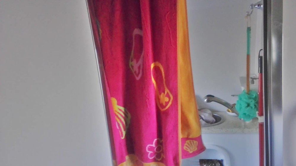

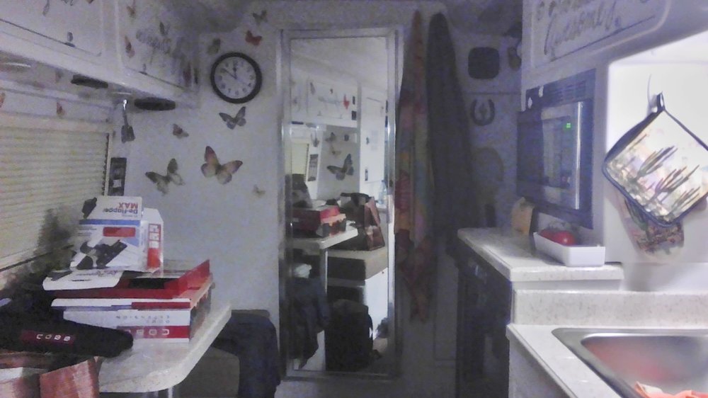

KarenLukens Posted April 2, 2017 Share Posted April 2, 2017 Thanks GG, I will check all of ours and then get back to the thread. We had another drawer open again today on the 2 hour ride up to Sacramento. It opened up an inch and it's the second time on this drawer below the sponge door in front of the sink... Then look up at the bathroom door... Nothing out of place with the towel behind as a cushion... We can't figure out how the mirror cracked... The door was locked closed, nothing was out of place... Only the usual road bumps... And then we find the drawer open and a cracked mirror door... Time to duct tape the mirror for today :) 1 Happy Camping, Reed & Karen Lukens with Riffles our Miniature Poodle 2017 Oliver Legacy Elite II Standard, Hull #200 / 2017 Silverado High Country 1500 Short Bed 4x4 Past TV - 2012 Mercedes-Benz ML350 4Matic BlueTEC Diesel Click on our avatar pic above to find the videos on our Oliver Legacy Elite II Link to comment Share on other sites More sharing options...

GrayGhost Posted April 3, 2017 Author Share Posted April 3, 2017 Is it possible that the bathroom door was shut and not latched, and whatever bump you hit that caused the drawer to open, also caused the bathroom door to open and slam shut? GrayGhost 2015 Legacy Elite II Hull # 98 2016 Dodge Ram Laramie EcoDiesel Link to comment Share on other sites More sharing options...
KarenLukens Posted April 3, 2017 Share Posted April 3, 2017 Nope, it was latched as usual. That was the first thing we checked also... Then we looked in the bathroom and all around trying to find something out of place that could have flown into it, and the towel was covering what looked like the impact point, so we are drawing a blank all the way around being that we only drove an hour and a half to Sacramento from Turlock. There was a plastic cup in the bathroom that is the only possibility, but it's stretching it even then... Then I took the Mercedes in to the service center this morning and was greeted by an old friend that was our Certified Rep in Rocklin a few years ago, so it's nice being close to home even if we haven't actually made it there yet :) Happy Camping, Reed & Karen Lukens with Riffles our Miniature Poodle 2017 Oliver Legacy Elite II Standard, Hull #200 / 2017 Silverado High Country 1500 Short Bed 4x4 Past TV - 2012 Mercedes-Benz ML350 4Matic BlueTEC Diesel Click on our avatar pic above to find the videos on our Oliver Legacy Elite II Link to comment Share on other sites More sharing options...
sailorashore Posted April 3, 2017 Share Posted April 3, 2017 Is it possible that the mirror cracked because the closed bathroom door was subjected to unusual racking forces. You mentioned in another thread that from time to time your entrance door would stick because of frame flexing. Coincidence or possibly connected? 1 Link to comment Share on other sites More sharing options...

KarenLukens Posted April 4, 2017 Share Posted April 4, 2017 Is it possible that the mirror cracked because the closed bathroom door was subjected to unusual racking forces. You mentioned in another thread that from time to time your entrance door would stick because of frame flexing. Coincidence or possibly connected? No, there was nothing unusual, normal speed bumps and dips, nothing unusual that we don't drive over everyday. Yea, twisting over a speed bump is a posibility but this trailer hasn't seen any off road time yet. Frame flex is normal no matter what we drive, but without being inside the trailer to see what happens over speed bumps or pot holes, all we can do is speculate. I'm going to be taking this trailer over some dirt roads in the future, but here in California, the dirt roads are usually smoother than the poc marked pavement :) Happy Camping, Reed & Karen Lukens with Riffles our Miniature Poodle 2017 Oliver Legacy Elite II Standard, Hull #200 / 2017 Silverado High Country 1500 Short Bed 4x4 Past TV - 2012 Mercedes-Benz ML350 4Matic BlueTEC Diesel Click on our avatar pic above to find the videos on our Oliver Legacy Elite II Link to comment Share on other sites More sharing options...

KarenLukens Posted April 20, 2017 Share Posted April 20, 2017 Good news :) We received a bunch of boxes today and one of them was the new Bathroom Door. It took maybe 10 to 15 minutes to replace, it was real easy. This door is a lot stiffer then the old door that broke. From day 1 the old door was wobbly and this one is real solid. So we are thinking that it must have been cracked or weakened before it was ever sent to Oliver in the first place because you couldn't see any difference between them. I did also notice that the screws in the door plate were loose today, so I tightened them as well. Then the other boxes were our used Cobb Grill that we won on eBay over the weekend. It looks like it was used once and then someone took it into the Salvation Army and then they put it on eBay with a starting bid of $50... Karen was the only bidder, everything was still new and in the original boxes :) So today was a great day :) 2 Happy Camping, Reed & Karen Lukens with Riffles our Miniature Poodle 2017 Oliver Legacy Elite II Standard, Hull #200 / 2017 Silverado High Country 1500 Short Bed 4x4 Past TV - 2012 Mercedes-Benz ML350 4Matic BlueTEC Diesel Click on our avatar pic above to find the videos on our Oliver Legacy Elite II Link to comment Share on other sites More sharing options...
