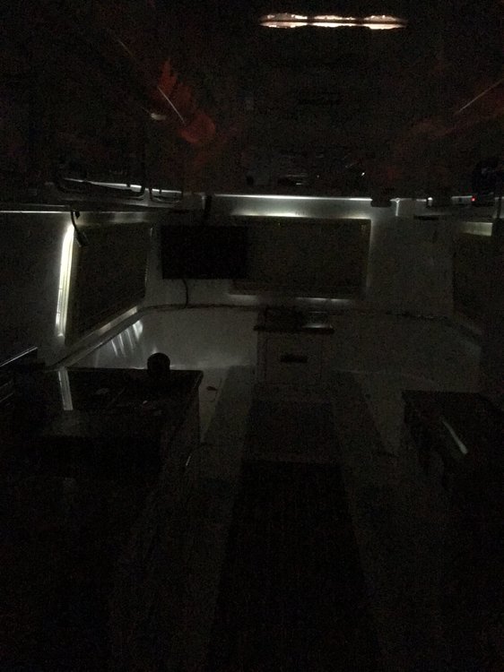

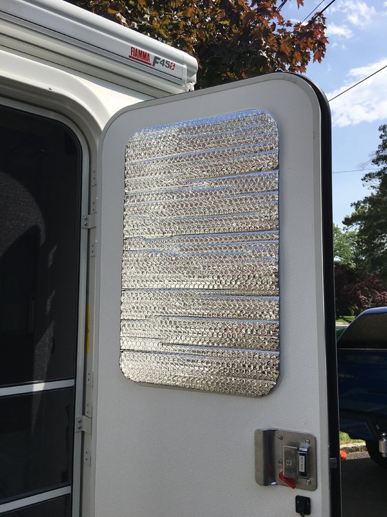

Had this idea last year but did not get around to executing until this week.  I was thinking that keeping light out of the trailer when it is in storage would keep the heat level down.  As an added benefit, if you need to overnight at a Wal-Mart or other parking lot with all night lighting, this might let you get some sleep.
All I did was remove the window shades and cut the reflectix to size.  Then it is easy to install / remove and roll up and store.
The roof vent for the MaxxAir Fan and the Door Window took some velcro and duct tape to make work but it was pretty easy to size and put up.  Easily removable with the velcro.  The last picture of the interior was taken on a bright sunny day around noon.  When you first enter and close the door it is pitch black inside.  When your eyes adjust you can see the interior enough to move around.  Some light still gets in but not enough to keep you awake.  Hope you enjoyed this.

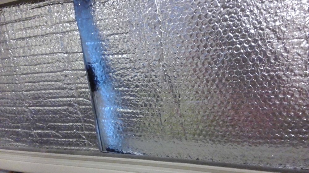

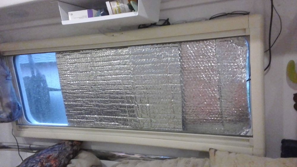

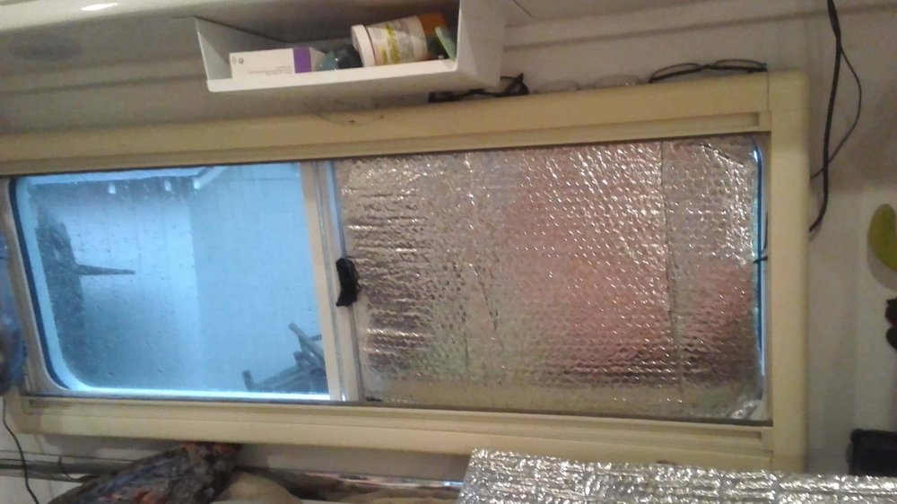

Here's another tip for the Reflectix insulation, when you cut it to size, cut the first piece to fit behind the window latch on the fixed side of the window.
This way it can either sit behind the slide window, allowing the window to open over it or it can also be pulled inside more to complete the seal. Then cut the piece for the sliding side a couple inches longer so the Reflectix can become a slider itself. Cut it long enough to cover the lock.
It works great and this way the Reflectix can be opened also without having to take it out to let the sunshine in :)
I was brainstorming this morning and wow! It fits perfectly behind the shade and when cut to size to fit behind the shade and inside the rail, the shade holds it in place and allows the Reflectix to become a slider on its own :)
The window shade still slides up and down perfectly over the top of the Reflectix, making the whole cold weather package even better :)
