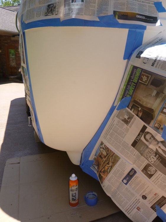

This past winter I saw a product called "Custom Shield Coating" by ArmorAll.  This is a spray on, peel-off paint and body protection product that is supposed to help prevent rock chips.  Since I will shortly be hitting the road and plan on traveling on my share of dirt over the next two months, I thought that I'd give it a try.  And it sure is a bunch cheaper than a set of Rock Tamers.  Application is fairly easy once you have the area taped and masked.  When dry the surface of the Oliver has a "rubber like" texture to it and it is not shiny like the rest of the camper.  However, on a test area the shine was back when the product was peeled off.  Once I get back - mid September or so - I'll report back here as to how well this stuff held up and if it prevented and rock chips.

John - basically the answer to your question has to do with money and looks.  At the Owners Rally I did see an Elite II with bed liner sprayed on and interestingly it was done in black.  It didn't look as bad as I had imagined.  But, this stuff is less than $15 a can and I used one can to do the areas noted in the pictures.  Certainly I don't believe that it will do as good a job as the bed liner stuff, but this stuff can be peeled off after I'm done with the dirt for this year.  We'll see!  Bill

OK, so, first observation on this stuff is that one must read and follow the directions exactly.  Yes, I do read and I do follow (unless there is some "valid" reason not to) but part of the instructions say to remove the tape from the masked off areas immediately while the product is still wet.  Well, let me tell you - this stuff dries REALLY fast.  I would suggest that when it comes time to remove the masking tape, two people get involved.  While one person continues to spray to "wet" the edge, the other person follows directly behind quickly removing the tape.  If you do not do this, the product film will start to lift off the surface of the Ollie.  Don't ask me how I know this!

John - they say that drying time is 5 minutes!  Certainly the weather did not slow that down very much - 80 degrees but the humidity was fairly high.  Life is tough in the mountains of Western North Carolina!

OK, as promised here is the follow-up report on "Custom Shield Coating".  As I mentioned, I traveled from the mountains of Western North Carolina to the mountains of Colorado and back.  Prior to leaving I knew that I would be traveling some dirt/gravel roads once I got the Colorado.  This year the weather was not the best .  Sometimes that can be good news in that it can help cut down on the dust from those dirt roads.  However, the rain did such a good job of cutting down on the dust that the dust turned into mud!  I know that I should have taken a picture, but, at one point the front of Twist was covered in an inch coating of mud and rock.  Several of these roads were badly "wash boarded" too.  I've found that there are two ways to deal with this type of road - either go very slow or very fast.  Assuming that it can be done so safely, I generally choose the "fast" approach even though I know that this kicks up more dirt and stones.
Below are a couple of pictures of the removal of the coating (note that the instructions on the can say that the coating is only "good" for up to three months.  I'm guessing that the elasticity of the coating tends to diminish after that time making it more difficult to remove and less effective protection.).  Note that I had already washed Twist (twice) prior to removal.  I did remove this coating fairly slowly as I looked for dents, dings, and scratches but the total time of removal for both sides was less than 10 minutes.  In places where there was a "nick" in the coating I had to take my time, but basically the coating came off in a sheet.  There were no additional dents, dings and/or scratches in the finish of the Oliver and the gloss of the surface was unchanged from the adjoining non-coated surfaces.  Given the "textured" nature of the coating when applied, bugs, road grime and dirt are a bit difficult (or impossible) to remove when the coating in in place.  However, in removing it all of the dirt, grime, etc comes right off.  Certainly this is an added benefit in that I used to spend a fair amount of time re-polishing these areas after each trip.
Bottom line - I'll certainly use this stuff again when I plan on being on dirt roads.  It is fairly easy to apply, easy to remove and protects the front of the Oliver from dirt, grime and small stone chips.  Having said this, I do not think that it would be a good substitute for more serious protection when it is projected that the Oliver will be spending huge amounts of time on roads that are less than paved (I'm thinking Alaska here and/or those owners that spend a majority of time on dirt/gravel roads).
